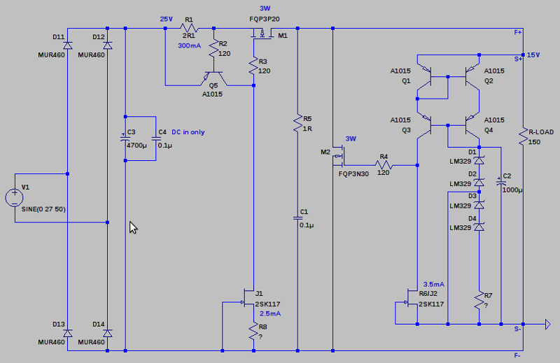

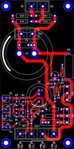

Hi Salas,
I re-edited the schematic according to your guidance (use A1015 and 1R && 0.1u). I added two more led / LM329 on Vref part so I can use it for higher voltage.
I managed to do a layout based on that schematic, Could you check it to see if it is ok or I'm wrong / missing something.
Thanks!

There is a max Vout that the lower mirror BJTs type can take in mW. Usually no more than half its max spec for long term reliability. Check the voltage drops on them so to determine your practical Vout max. You could turn Q1 & Q2 face to face so to can thermally bond them. Not the other two, they will run different mW. Correct connections layout details I can't review as it takes much time.
Many thanks! General layout comments is enough for me. I will correct the layout, do some check and send it to a local PCB company. I'm going to build +-15V version so I think A1015 can withstand these mW. With higher voltage, I can switch them for A970s. I hope it will went well.
Why are D3 and D4 shorted out? Is this just for the option of higher voltage? (probably)Hi Salas,

Also, lower noise from the current mirror would be had with some emitter ballasting---but perhaps the voltage references are already dominating enough for this to have a significant effect.
Are you referring to the dissipation of Q3? If the loop is closed it sees only the SK117 current of 3.5mA, right? Even with 15V across that's only 53mW, actually less because of the gate-source voltage of the DMOS part. The SA1015 parts are rated for 400mW I believe at a 25C ambient.There is a max Vout that the lower mirror BJTs type can take in mW. Usually no more than half its max spec for long term reliability. Check the voltage drops on them so to determine your practical Vout max. You could turn Q1 & Q2 face to face so to can thermally bond them. Not the other two, they will run different mW. Correct connections layout details I can't review as it takes much time.
Yes, I refer to Q3 that will see Vce=Vo-VGSM2 thus DisQ3=Vce*Iq. The other BJTs will only drop under a Volt each.
Since he mentioned more LM329s capability, there will be an eventual Q3 dissipation limit to keep in mind. Constant dis. for boxed conditions near sinks etc.
One could also put some resistance in series with the Q3 collector to share some of the dissipation, bypassing with a small C to make the resistor's effects go away at high frequencies.Yes, I refer to Q3 that will see Vce=Vo-VGSM2 thus DisQ3=Vce*Iq. The other BJTs will only drop under a Volt each.
If no bigger form factor low Rbb BJT was available, and high Vo was planned, maybe a solution to try, yes. But it can detract from the open loop gain phase margin.
In general, up to 1/3 the Ta=25 max dissipation spec will be reliable in real life conditions of constant dissipation in a closed box ambient.
