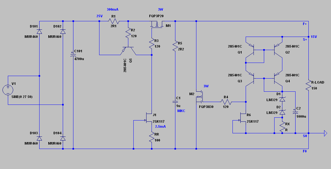

It is a calvin buffer out buffer. It run on +-15v and use about 100ma for two channels. I have an transformer that can out +-25vdc after filter capacitors. I did have a typo. I have both pmos and nmos version of the mosfet.
You may use a couple of Reflektor-D with R1=2 Ohm, two LM329 instead of LEDS (cathodes in reverse than LEDS) and a JFET (G+S shorted) instead of R6 with your MOSFETS. You can stack them for symmetry and virtual center point ground as shown at the bottom of the Ref-D pdf guide. Will do 15.22V symmetrical @ 300mA current limit per rail that way. Give them 22V raw DC in at least. Calculate dissipation* and get proper sinks. They should give you less than 0.001 Ohm extended output impedance and good stability. You may use J113 if difficult to get surely genuine 2SK117GR, with a small noise penalty, but well passable for an analogue line level buffer's rail noise demand.
WM1=ICCS*(VinDC-VoutDC)
WM2=VoutDC*(ICCS-ILoad)
@Andrew: I got what you mean. Iq will only applied when there is no input signal. And we need to take care of maximum peak current when we use Salas Shunt regulator.
@Salas: Thank you for your circuit recommend and extra info! I will try to follow it and will come up later with a schematic to confirm. BTW, how 2SK246GR or 2SK170BL compare to 2SK117GR in R6 position?
Looks drawn alright. Being based on my 2011 linked example from post#2 using IRF640 it has C1,R5 heavier values. Better use 1R & 0.1uF for those lighter gm and Ciss FQP MOSFET types.

I think I can use J113 in J1 and 2SK880 in J2. PJ2 = 4ma x 14V = 56mW seem still ok.
I have some Toshiba A1015GR (original - get from Japan) which NF = 1dB. I also have some OnSemi BC556B, Fairchild KSA992. Do you think it is ok to use one of those? If not, I will try to get some 2N4403s.
Yes, rbb' for 4403 and 1015 is about the same, with the 1015GR having a somewhat higher beta than the typical 4403 if memory serves.The A1015's are as good if not bit more linear and noiseless.
It's interesting that the 2N4403 was designed for switching applications, and it was regarded by some as a trade secret that it had low noise with low source impedances. One friend made something of a name for himself at TRW by designing a preamp for very-low-resistance detectors using the 4403, back in the 70's, that was better than that of the resident low-noise-preamp specialist.
J1 will see about 19V across, also being degenerated to 2mA IDSS by RR (test on bench for RR and J1 sample). That is 38mW.
