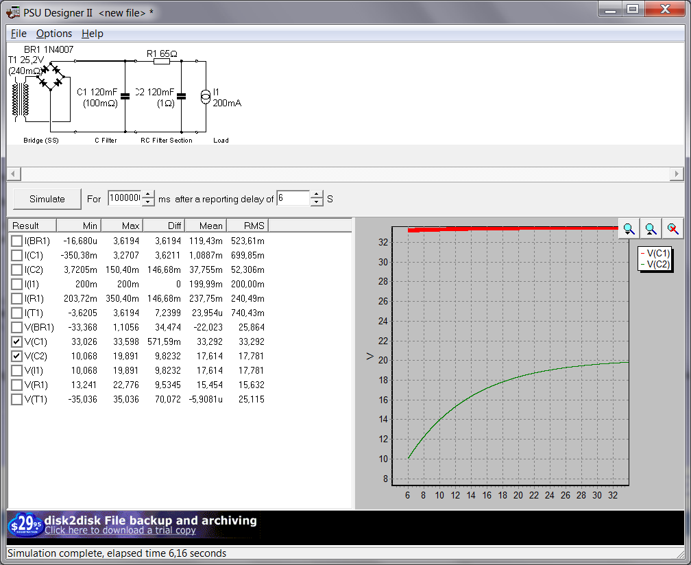

On the spreadsheet:
The output voltage is specified as 21Vdc. The current as 200mA, the resistor as 65r.
Working back, the voltage on C1 & C2 must be 21 +[0.2*65] = 34Vdc.
That just about agrees with the input voltage.

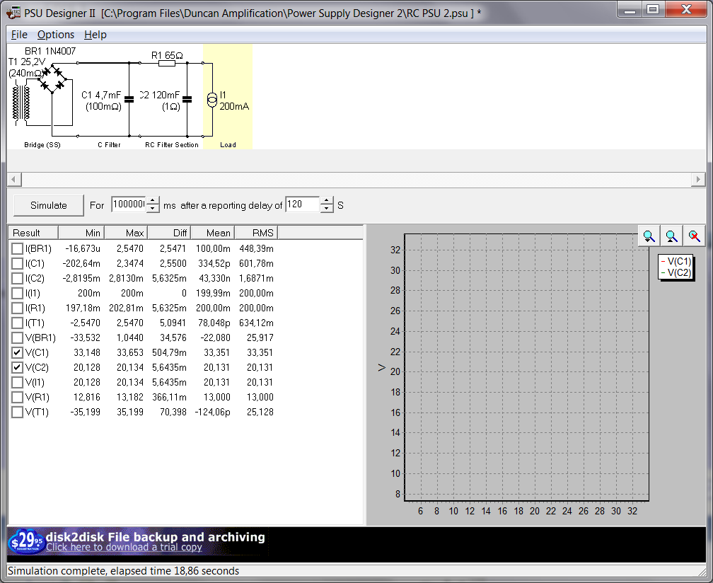

In PSUDII:
Add in the first capacitor.
At present the 65r is preventing the smoothing capacitor from charging up. It's working a bit like a choke input filter without the choke. The resistor is "choking" the output.
The RC time constant tells you how fast the cap charges up.
One RC gets just over 60% of charge. Five RC gets >95%. Ten RC is effectively fully charged.
RC = 120mF * 65R = 8seconds.
Check the plot. is the voltage on C2 >60% of final voltage at 8s?
Check the plot at 40s, Is the voltage >90% of?
Check the plot at 80s.

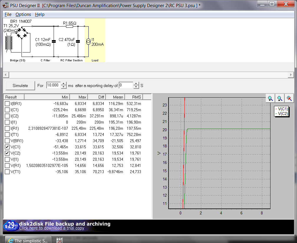

New RC = 65 * 470uF
10*RC ~ 13s for virtually final voltage.
But, you have to correct all these RC for the effective resistance of that 200mA load.
Just accept the PSUDII predictions, it's easier that way, provided you ask the simulator the correct questions.
