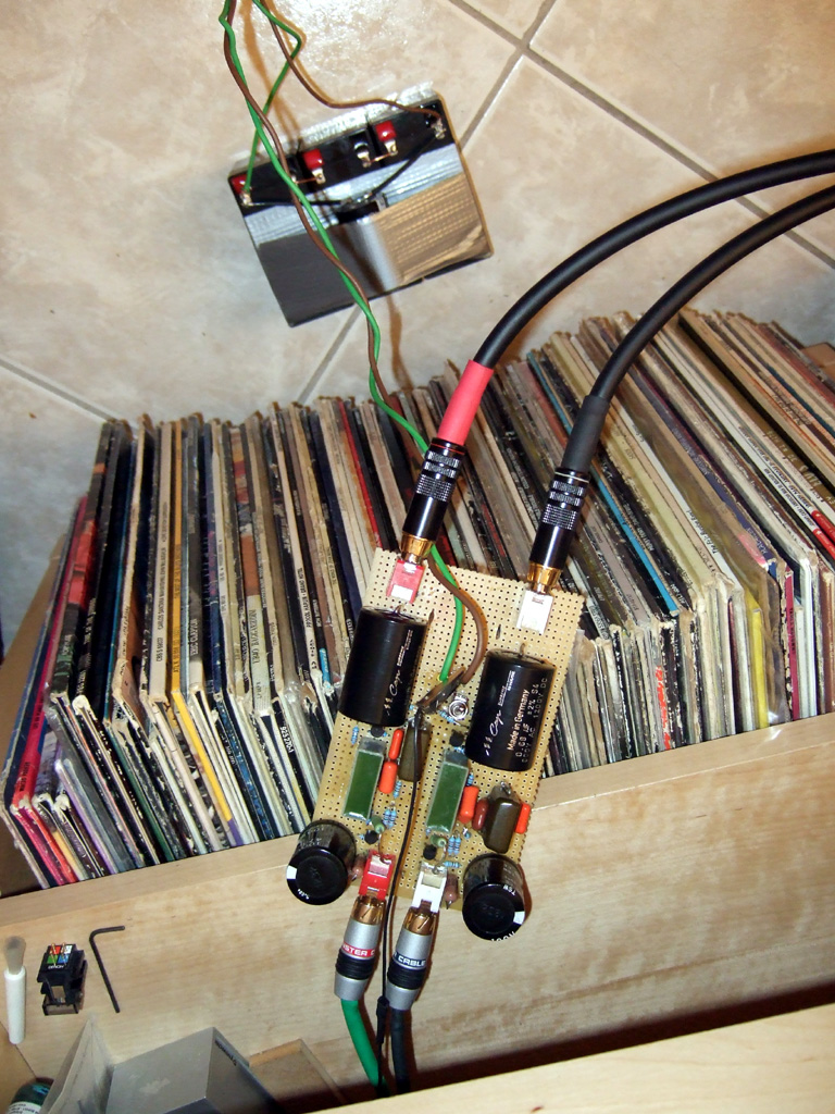

I used 1000uF to supply Buffalo III 3.3V clock with excellent result & 220uF for my Simplisitic NJFET RIAA MC preamp

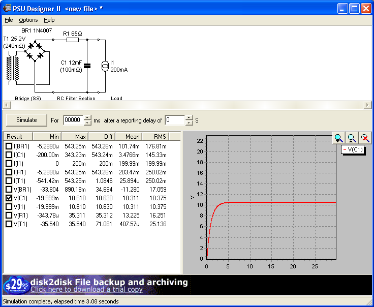

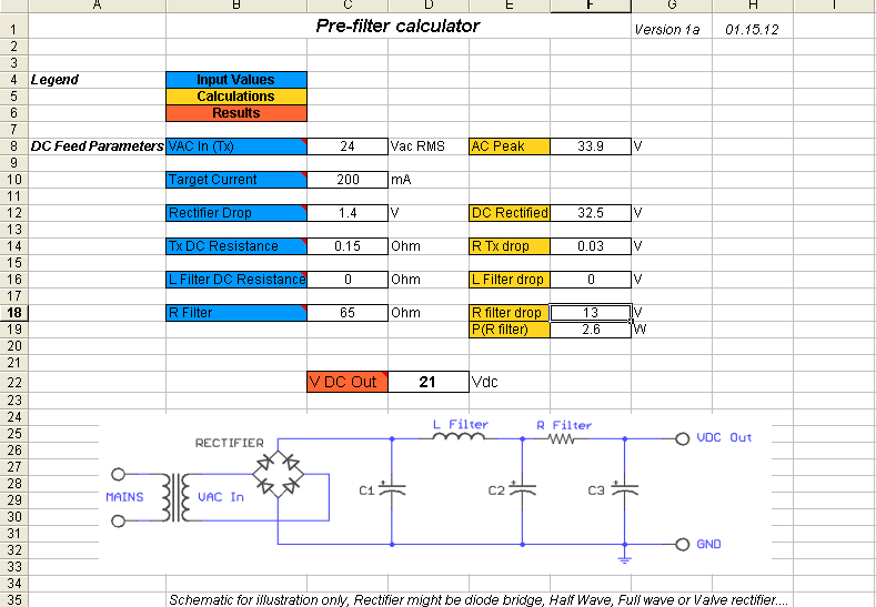

I am gathering info to build a raw dc psu for my latest SSLV1 and need some clarification.
I want to use a 24V 80VA Tx to feed a 14Vout shunt.
I will use a RC filter after rectification.
Using the SSLV1.1 spreadsheet (Fred's) for 24V Tx with 65ohm resistor and 200mA CCS I get 21Vdc (enough headroom for the 14Vout shunt).
But when I input the same values into PSU Designer II, I get only ~~ 10Vout from the RC filter.
I know there is something wrong with my PSUDesigner simulation but what ?
And if the simulation is ok, than I do not know how to interpret the readings... some clarification is needed.... so as usual I hope someone cares to leave a coment.
