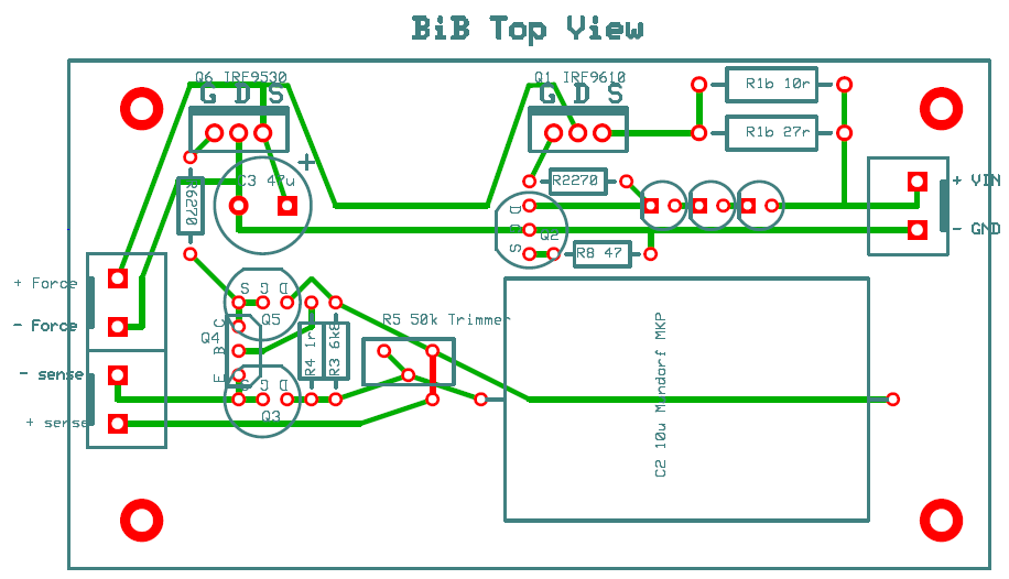

Im currently building a CMoy with salas shunt reg for PSU
I've got the board from CRT ( thank to him )
But when i done soldering, it didnt worked well....
Im using transformer 50vac, 2x15v
And im using MSR860 diode, resistor 10R 5 watt
I only got 9.7v from V-
But V+ is zero....
Please advice....

I see a bunch of voltage reference leds not emitting. See if you got one or more of them wrongly orientated or dead from too hot an iron or long soldering. If your meter can light an led in diode mode just test them one by one with same and correct in circuit polarity without removing them first. If meter can't, use a 9V battery fast.

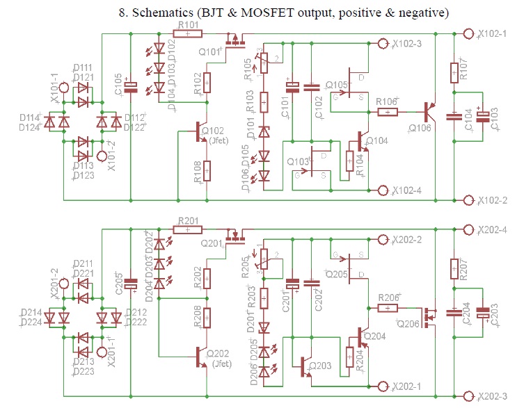

This must have been asked before, but i cant find it (not at least in a way that i understand).
Can somebody explain the function of the zobel network at the output of the 1.2bib? What happens if i use different capacitor values (i now use 220uf + 3.3uf, where 4.7-10uf is recommended).
Thanks!
Thanks!
Did i read correctly in the thread that for powering a tda1541a with the ssr1.1, a 220uf lytic is recommended as output cap? Why is this preferred over a mkt+r in this particular case?
In the same post by salas i read even a 1000uf was recommended for clocks! Why?
