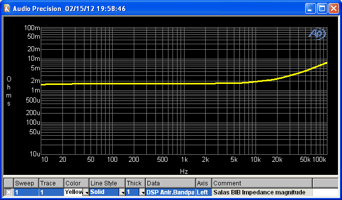

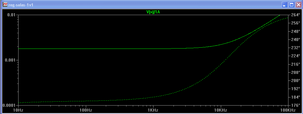

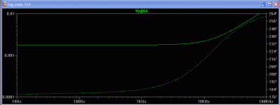

Very good practical result on AP indeed. Without ''hot-rod'' spare current conditions even. Did you check noise if with a >=220uF Vref filter capacitor?
edit. Here is my bib simulation with your CCS/load settings. Repeating your Audio Precision real measurement for easy check.
