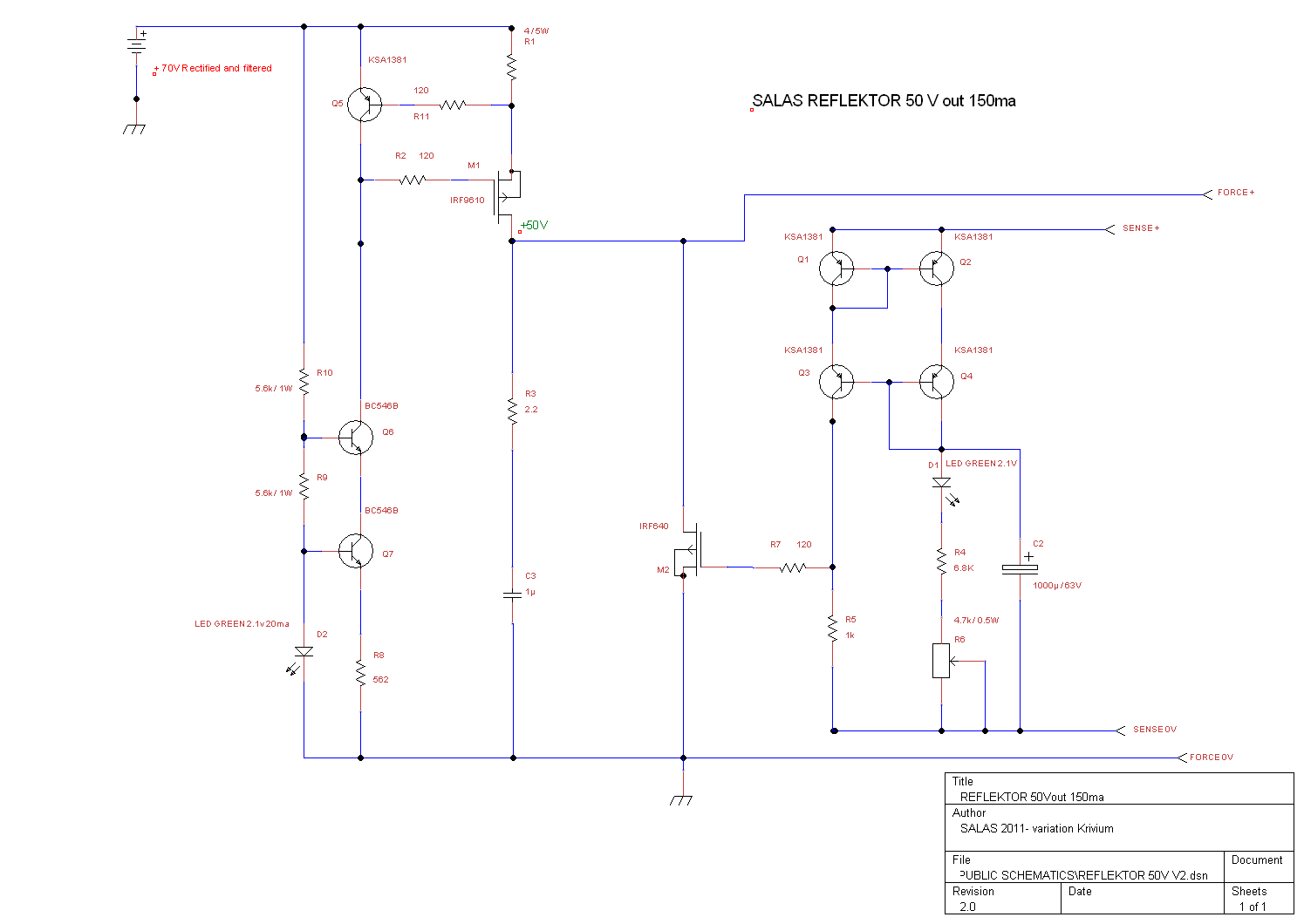

Hi Salas and all,
Here is a schematic for Reflektor 50V out/150ma as suggested by Salas in post #4727.
Could you check for errors please?
I finally settled on BC546B for ccs cascode ring. Not sure about R8,R9,R10 in the attached schematic.
I miss snuber across C2 as you did that on last layout suggestion.
Regards.
Regards.
Use a base stopper 100-120R for Q5, give same value to R2,R7. R10 maybe will need to get tied directly to +InV if you will get start-up problems by referencing to output as you have it now. See to have correct dissipation parts for R9, R10. Also R1 looks enough for 100mA only. Use at least 100mA spare over your top load demand.

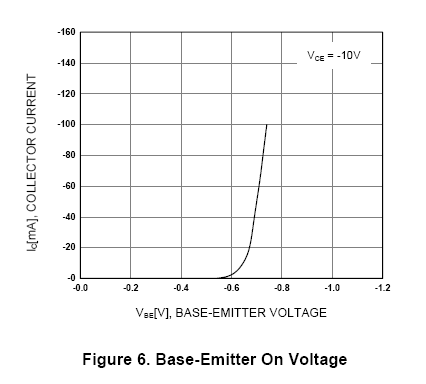

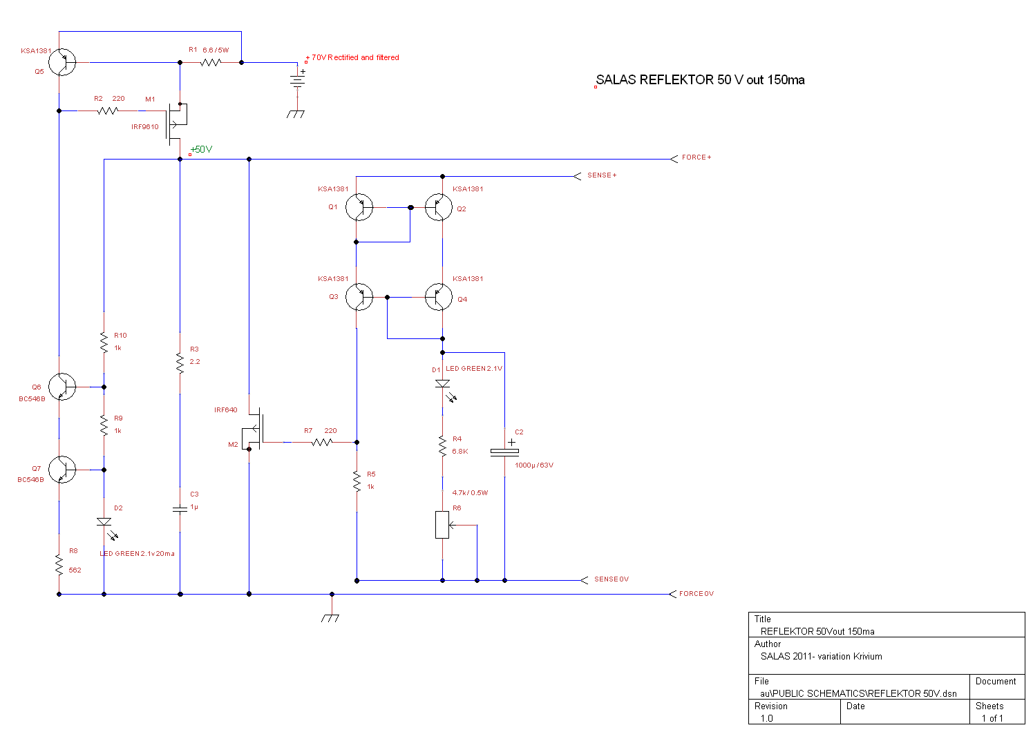

Ok, there is something i don't catch with that one as it is not the first time you say that to me: calculation is Q5vbe/R1 right?
In KSA1381 datasheet it's specified as 1v vbe. What i am missing there?
EDIT: got it! It's vbe SAT which is specified! VBE still in 0,65/0,67 ballpark as for any silicon transistor.
Ok. So it should look like the schematic attached.
It's a pleasure learning with you as a teacher Salas.
Could you explain me math involved with R10, R9 please. I don't get it.
For previous value of 1k i refered to wikipedia page about current source and supposed that 50V minus 2,1v (D2) divided by 2 (because of cascode), and about 2ma as target. Where am i doing it wrong?

The current through Q5,Q6,Q7 will be (VfD2-VbeQ7)/R8. But the current through D2 will be (Vin-VfD2)/(R9+R10).
Yes, put emphasis in better pre filtering. To the contrary you could spare 10V on the CRC and take some heat off M1. 60Vin is fine for 50Vout.
