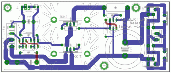

There is something wrong going on initially. There should always be 4mA available to charge the filter capacitor. Can 2000uF be overkill to start up? Here is an alternative routing by the way.

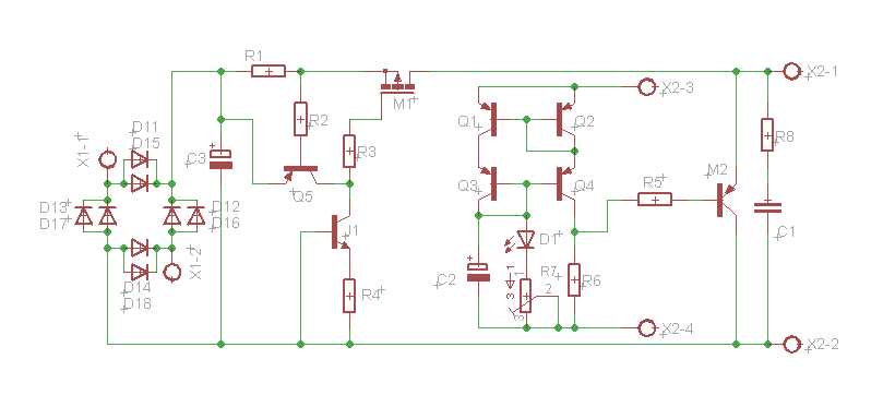

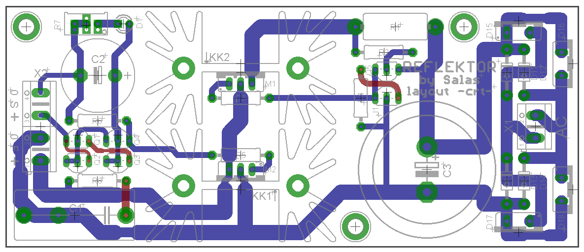

Hi Salas
Regarding post #4703 the Reflektor board layout, I don't see cap C1. It shows 1uf on the schematics. What type of cap should it be? MKP? C3 on your schematic shows as C4 on the board should it be MKP? And C2 1000uf panasonic FM ok?
Best
Ken
MKP in the RC across the output. C2 FM OK. Board has its Eagle designations (C1+). There is up to C3 only, which is the included rectification's filter capacitor.
So, omit C1 shown in the schematics?
It misses a snubber across C2 to the first inception that after subjective evaluations of members was judged not adding much. So it got even less parts count. Has a trimmer for adjustable Vo instead of R6 also.

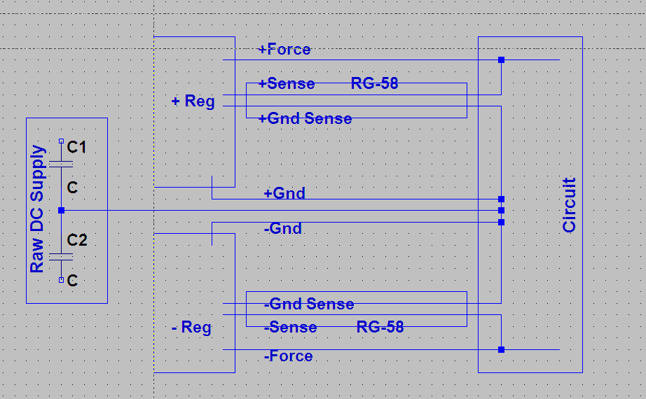

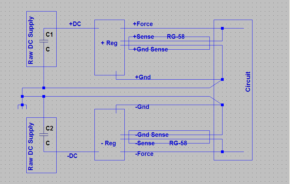

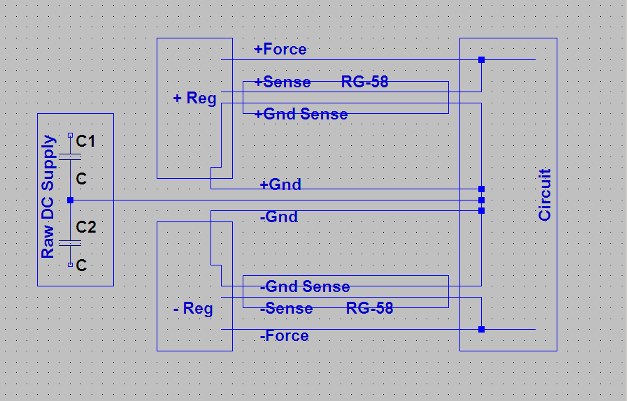

Hi Salas,
I was looking at Gary Galo's method for connecting super regulators. I've made a drawing based upon his recommendation for connecting your style regulators to the load. Is my drawing the best way to connect the regulators? Or is there a better way?
As always, Thanks.
As always, Thanks.
Ken
That looks right to me.
If you have dual DC supplies you can replace the +reg with a -reg. Saves on buying different components and maybe slightly superior performance from the -ve regulator (because it is using all Nchannel parts).

Hi Salas,
I see that between the schematics in #4764 and #4287 there is another main change, i.e. a N channel instead of a P ch for M2 - with D and S swapped (as you already did in almost all your shunts). Is there a real advantage in doing this (apart of availability in your drawer 😉)?

Its the same IRF640 NMOS with source to ground as in #4287 if you look at the layout. That transistor with emitter up symbol its just an Eagle swap library aid that crt used.
