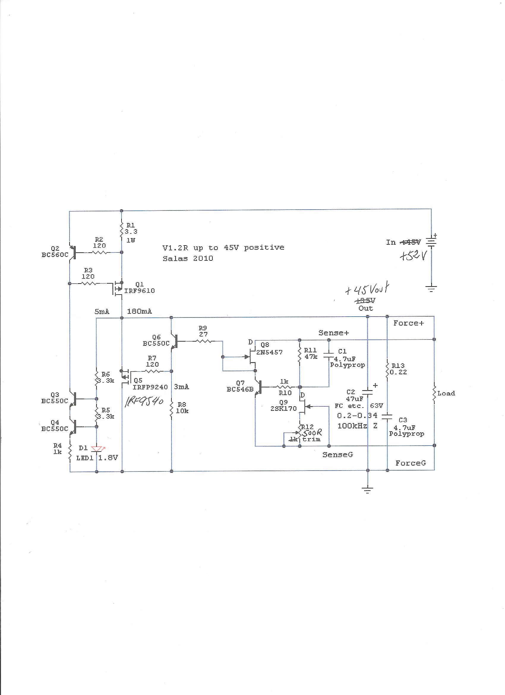

Bypassing the MKP on the vref zobel with a 15nF teflon, brings really big inprovements in the trebble region.
I will try latter with other values.
I already did it in my Salas phono V1.2R regulators for my Symplistic NJFET RIAA, I used 15nF USA teflon😉
Where did you use the 15nF Teflon merlin ?
Bypassing Vref caps? What caps are you using there ?
100nF FT-3 Vref & 15nF USA zobel cap, 4,7uF 400V Vref & 4,7uF 400V Zobel both are MKP not boutique, bought to Apex Jr. marked NPTM
Hi Merlin
Would you post your v12r schematic ?
It seems it is different from what I am using 🙂
Ricardo V1.2R up to 45V positive, I'm sorry for bad quality pic.
That is the same schematic.... You are not using C2 (47uF EL) ?

After many experiments (as usual) and critical listening tests, I decided to use 0.047nF on the output zobel. The polystyrene on Tin Foil has a distinct sonority that I really like. Not so strong presence as an Auricap, with very good extension but not steryle as an FT-1.
In the Vref, I am using a nonpolar 680uF EL bypassed with a zobel... In this case I opted for a 4u7 MKP bypassed with the FT-1.... resulting in very good extension but keeping the agreable low mid, high bass presence I lacked with the 1u or even 3u3 I experimented with.
IMO the output combo deals with speed and detail, The Vref combo deals with bass and presence presentation.
