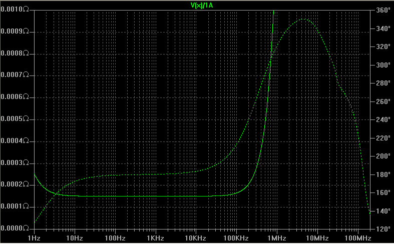

I know what you mean, kt. I don't know what circuit hesener built, but there's a big difference between 28 mOhm and less than 200 uOhm, like my reg simulated a while ago

IMHO, without sense/force wires, and without a really good pcb layout, there won't be a low output impedance anywhere close to what the design can do. And no, I don't think my reg could get to 200 uOhm zout in reality.

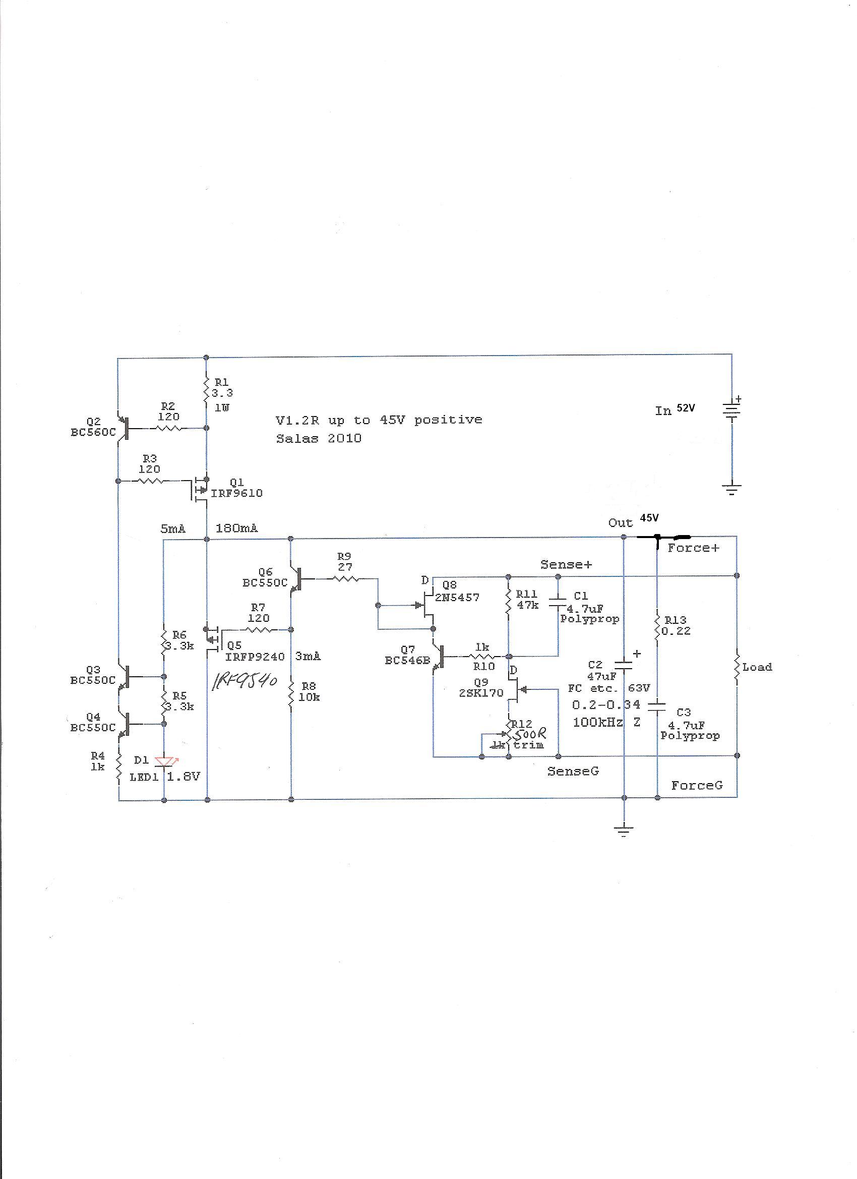

Ah, you must mean this schematic!
http://www.diyaudio.com/forums/powe...w-voltage-shunt-regulator-82.html#post2659413
Likely D1 is there so the circuit won't drift with temperature. You could bypass it with a capacitor, to gain that 3db advantage, though it may have to be a really big one to cover bass.

Hi keantoken,
yes that is the circuit. But the combined TC of the PNP and the diode add up, and make the temperature behaviour a little worse actually.... the diode should be between the JFET and the trimpot for the voltage, for compensation. I shall try....
