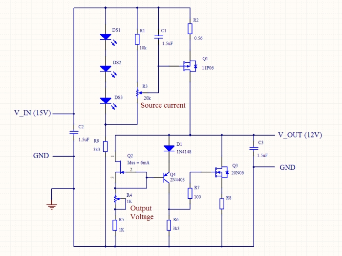

Hi, just to show my salas shunt build that I implemented in my phono stage. Attached is the schematic for the positive regulator. The negative regulator is the same, except for the reversed polarity of the MOSFETs, LEDs, diode and bipolar; otherwise identical.
1) the current source is a degenerated MOSFET, that allows for a nice point for measuring the current, has excellent noise behaviour (much better than LM317 - I tried), and lower voltage drop (the LM317 needs around 3V to start operating properly, this one works at 1V or less voltage differential - 2..3V is better though)
2) The diode in the emitter of the PNP increases the drain voltage of the JFET used as constant current source, making the reference voltage more stable
3) R6=3k3 is on the high side, the current starving for the PNP gives a lowish gain, which combined with the Q3 gain is high enough but still stable.
R8 is zero in my design but may be increased if running into instability. The 1.5uF at the output is all there is.... Output current in my application is 500mA at 12V.
The temperature stability is not great, due to VBE of the PNP decreasing with temperature, and the MOSFET's positive tempco (at least at these lowish currents). It is not helped with the additional diode.
But the drift is not large, and it could be fixed, but then I thought so what. Adjusting the output voltage after thermal settling is good enough. Of course, 10-turn pots for both the current and the voltage are advisable, especially for the current as the adjustment is quite sensitive.
I did measure the output impedance of the shunt regulators with a electronic load that can sink a DC and AC current, and the output impedance (= noise voltage / AC current) was 4mOhm flat from 20Hz to 22kHz. Low and flat, thats what we want right?

OK, a plausible twist of 1.0. But why not current source loads instead R6 & R9? No C across R4&R5? The diode's dynamic impedance degenerates the 2N4403 also.
P.S. Your Zo measured is indeed near the simulator for standard 1.0, was it near the simulation of your particular twists build? Nice opportunity to see how well the modeling follows. Any picture of the prototype?

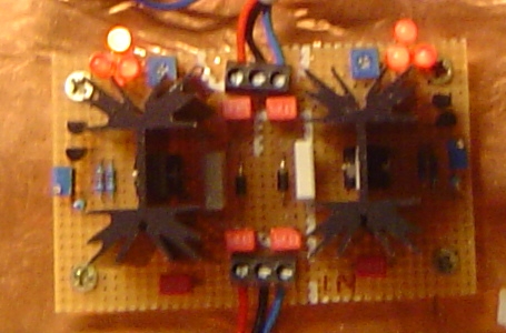

Hi Salas,
here is a picture, sorry it is not very sharp. This has the positive and negative regulator both on one PCB. In fact, the more I play with it the more I like it! It's a great regulator concept you came up with. All the LEDs should be about the same brightness, this is just my crappy camera misbehaving...
As mentioned over in the other thread, John Curl explained in a lot of detail the use of JFET current sources with resistors as voltage references, and why it matters to not put caps there, and I agree. Might have put a lowpass filter from the voltage reference, but then I didnt and it works just fine.
A current source for the LEDs would have made the thing more stable, no doubt, same for R6. But since I made it all adjustable it works that way just as well. (Honestly, I didnt think about that before you brought it up ;-)))
Actually, I didnt simulate but just built. And yes, I was surprised about these very low values and so we re-did the measurements and verified with other instruments, and yes, that little regulator does the job nicely! The output impedance is flat across the entire frequency range (we only tested up to 22kHz).
When building the phonostage this guy powers, I was using LM317 current sources but the input voltage was too low, and the current source was not operating properly. Although the noise on the output of the phono stage was very low, there was a noticeable bump at 50Hz (+10dB or so), that completely vanished once the current source had enough headroom to operate properly.
Separate sense lines? Yes, that would be nice. Thinking about it.... Guess I have to re-read this thread now ;-)
