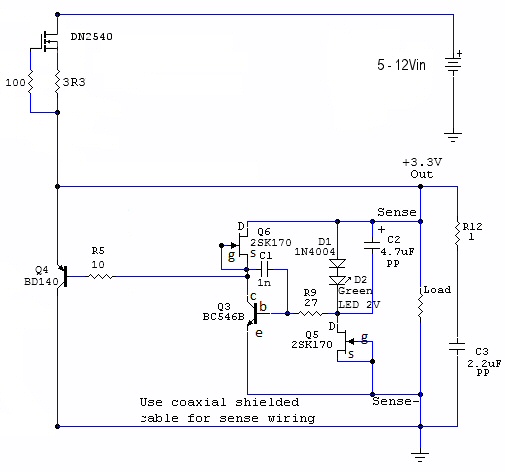

I would like to see, in the higher voltage versions, where a resistor is used to set up the voltage reference, a three component string consisting of resistor, LED and Zener.
For low voltage the Zener is optionally replaced with a diode and the resistor can optional be linked out. The LED shows it's working as well as giving us the low noise, low impedance reference voltage that we need.
How about a proposed V1.0a and V1.2a with these modifications?
Zener is difficult to find with good noise in reality if not a special Tc compensated component, got to be purchased in volume. After having seen many doing bad or good enough, but erratically so, I would not recommend different than (easily available) LM329 6.9V and multiple use of it. Unfortunately the nice pp cap viable for the Norton ref should be augmented by at least 100uF chemical cap //. The Norton ref is nice for higher voltage, gives a nice variable Vout with the trimmer, if someone wishes minimal voltage slide till Jfet's Tc comparable to active ref elements, it can be made small value, lytic filtered, and use the fet ccs in its tail g&s shorted. Although better current than what with a typical 20-27k Norton at say 20V-30V range looks nice for the base needs of the BJT error amp, Spice shows no appreciable dynamic improvement beyond 0.2mA availability. Its a matter of choice the Vref and its subjective evaluation, variability on the fly or not priorities, bypass features, for the connoisseur builder.
P.S. 1.0 was always made with active elements too. Remember DCB1, several low voltage, and phono realizations.
Avoid Schottky diodes in the Vref (1A to go 0.6V)... Nice then (horosho?), please post the total final well working cct for any guy's reference who will be interested in a tested 1.2(ish) based 3.3V solution in the future. We like pictures too.🙂
P.S. You mentioned that you had 1.0 based regs there before, correct? Now its a 1.2 5V all Mosfet and the 3.3V with a BD140 in the shunt position we ended up with, right? Was there remote sensing implemented for the 1.0s too? Can you differentiate the before and after regs subjectively?
Final circuit is attached. Yes, before I was using V1.0 regs without remote sensing, now the config is just like you said.

Thanks for the detailed info. Looks like the digital circuits are quite susceptible since you can give such a clear subjective account between shunt reg versions on them. Is it a Gigaworks platform? I guess you use a 10uF and 0.5R output Zobel in practice, but in this one since the Cdom is high and there's no buffer even the 2u2 & 1R shown might be equivalent or a bit better.
Yes, you are right, it's Gigaworks DAC. I'm using 10uF and 0.5R Zobel only on one of 5V regs (changed from 4u7 and 1R when I saw some oscillation on the scope), other 5V and 3V3 are using 4u7 and 1R. Sorry, I didn't corrected it on the schematic. So it may be better to change to 2u2?
Depending on the load interaction, the smallest you can go without oscillation traces, the better. Since we don't know if other builders will have oscopes, I will edit that picture to 10uF+0.5R to be sure of what we have tested in the most difficult situation. The one that gave you a bit of oscillation from those with 4u7+1R and you changed it, was on a very different circuit feed?
The one with oscillation was feeding two devices actually - SPDIF reciever chip (CS8416) and ASRC chip (CS8421) with clock crystal. While the other one was only for DAC chip (CS4398), so I guess two devices with their surrounding elements can produce some oscillation for certain Zobel network. Yes, you are right about the schematics, so not to confuse future builders.

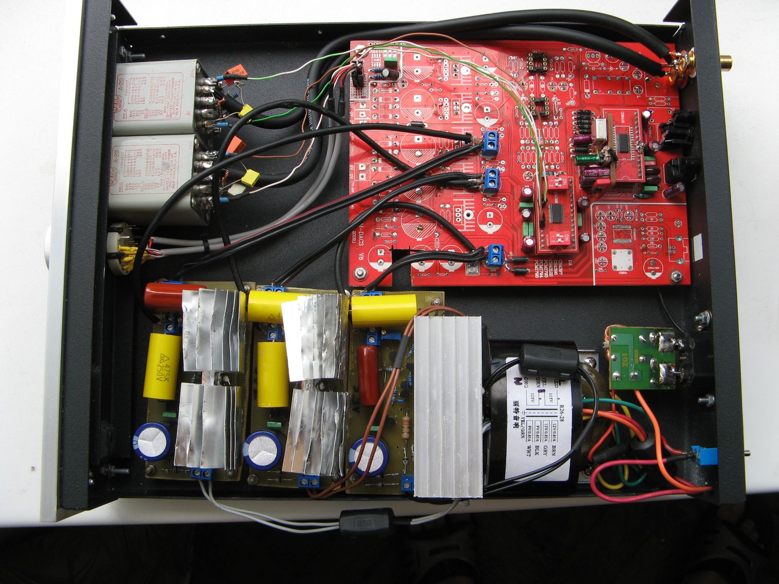

Here it is 🙂 I was little embarassed to upload the pic of my build, because of ugly heatsinks 😱 Those are handmade from CPU cooler. I plan to change them to something more presentable in the future 🙂 Well, this is basically my first and only DAC for now, so can't say how it may compare to others. Your regs are definetely good for the sound, and added lots of 3D 🙂 The transformers on the output is UTC A-20.
Here it is 🙂
Surely shows the way towards my friend's aspirations for regs. Nice one.
P.S. I don't wanna hear about presentational looks, essence counts. I see nice coax for sense, especially good in a digital environment. Congratulations.

At Mhz speed shunt regs are "out of steam" 😀
Your best friends there are capacitors
Will not match the cascoded tail main CCS's PSRR. Even if with cascoded depletions.
All depends on your design priority, there is no free lunch 😀
Somethimes you need to sacrifice some dB rejection for wider bandwith and linearity. Think about IRFP9240 capacitance & what circuits will be feed with 3.3V. There is no need to feed cleanest possible DC to those circuits. More important is to isolate them from interfering with each other. Even simple NPN transistor at supply pin will provide additional ~40dB rejection.
Yeah, there is different priority for phono stage & higher voltage shunt regs than for those circuits & 5v or 3.3V shunt regs
The CCS's cascode tail takes care of that gate. It widens the PSRR's bandwidth. You can use IRF9610 for main CCS position too no problem, I have specified and tested that also right from the start in page 190, better, but not as much as in raw VS more capacitive Mosfets. Anyway, those regs aren't made with digital in mind. If they manage to sound better to people than some others in digital too, all well. If not, mod them or use specific for digital.

Its not bad and its not a heavy redesign, its only changing the main CCS for minimum parts count still with low capacitance, and much acceptably so. I would prefer the 9610 with a cascode on its gate, that's all. What happened with that 3V3 dedicated one you did with Iko? Tested it?
that 3.3V evolved further with parts count reduced to minimum. Learned hard way that more important than single super regulator is local bypass for each chip and to "isolate" each chip to prevent him from interfereing with other chips. For "digital" chips.
Why I choose DN2540? According to Walt Jung measurements & measurements from others, this simple depletion device will give you over 100dB rejection over whole audio band. Just a single device + 2 resistors. Even if shunt MOSFET or transistor not working, there is over 100dB rejection. At 200kHz still 90dB rejection.
No need for overengenering if input voltage ripple is bellow 1V 🙂

Do you compensate for stability at the output, or with lead lag internal, or with both?
