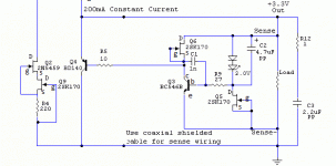

I say better use a 2V LED and a diode in series instead of a resistor and delete the FET's trimmer, just connect gate to source. That will give 3.3V more or less, very steady, super low noise, max CCS current. Cathodes facing towards the Vref's CCS FET. No need to change the bypass cap.
I see, can you please look at the circuit attached, is it correct, considering all the changes?

Salas, I've just tried the new circuit, and the output is 2.94v, LED is shining. Thing is that I've used 2.2v green LED (I hope I measured it correctly), is it responsible for setting Vout? Are there any control points that I can check? Oh, and input voltage is 9v, if it matters.

Did you use the diode too? Vout is Vref+Vbe. Vref are the elements in the former resistor's place. Add one more diode if its not enough and try some combination with the proper LED to go around 3v3 target.
Yes, used the diode too. Tried with two diodes - output is 3.07v. Voltage across Vref elements is 2.40v and Vbe is 0.67v. So this is correct. And we can change only Vref by using LEDs, right?
Then, I guess, I need to go to the store for some 2.0v LEDs 🙂

For Q5 (2SK170): use other 2SK170 with higher/lower Idss. LED's are not perfect voltage references, voltage forward is changing with different current through them.

With one 2V LED and two diodes its kinda weird it won't go at a higher Vref than circa 2.4. A BL under Vbe should be giving 5-6mA if it is 7-8mA Idss at 9-10V. Either that CCS fet isn't pulling enough, or the LED is sleeping (is it glowing enough?) or there is too much current taken by the load versus the main CCS setting and the reg is starved for current in its own shunt elements.
It works now! 🙂 The problem was not in LED but in diode - first I used 1N5819, left from other project, but then I remembered that you've recommended 1N4004, found them when looking for some more LEDs. So final circuit is 1N4004 and generic 5mm green LED. It gives out 3.32v. The sound changed to the good side, highs are crystal clear, scene is widened, some microdetails revealed.

Avoid Schottky diodes in the Vref (1A to go 0.6V)... Nice then (horosho?), please post the total final well working cct for any guy's reference who will be interested in a tested 1.2(ish) based 3.3V solution in the future. We like pictures too.🙂
