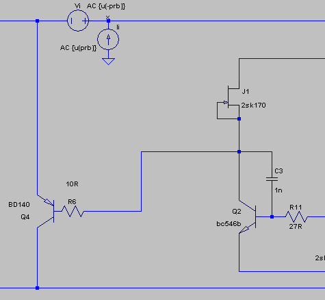

Hi guys, I need a little advice. Just finished assembling 5v and 3.3v versions of v1.2 reg, checked their output with the scope - the line is straight, no ripples (at 0,01v per square), but, I hear some sand in the highs, can it be because of the output config? The regs are feeding DAC chip, ASRC chip with clock and SPDIF input chip. One 5v and 3.3v are using 4.7uF and 1Ohm, other 5v is using 10uF and 0.5Ohm network. Will it be better to use electrolytics?
P.S. Is there any special technique for checking the output with the scope?

How you made the 3.3V? BJTs? What type? I got to see if its OK in Spice first.
Sweep the scope to its lowest us too, so you see all frequencies. Remote sensing implemented?
What's the max frequency on your scope? Perhaps you got some oscillation going on that's beyond what your scope can show?
Hi Salas, I've made it with BD140, just as you've suggested for v1.0. Yes, remote sensing is implemented. Will try with the lowest us today.
Hi Ikoflexer, the scope is little old, so the max frequency is 5MHz. Is it too low?
Thanks,
Fedor
If you got oscillation at 10MHz, you're not going to see it. But then it's not something that you can hear. Possibly though it can still affect the proper operation of the transistors.
That same thing that you hear in the highs, you cannot hear it when your system is powered without the regulator?
Fedor, I looked in it, and your problem is that you used a BJT shunt element to avoid Vgs 4V and go Vout very low, but the buffer won't allow the error amp JFET active load any voltage margin to speak off. Gone is the nice Vgs-Vbe breathing space. So your loop gain is tremendously low, and you got joke regulation and Zo. No oscillation you can see, looks logical. Gritty sound because of no regulation almost. What changes you can test to rectify the situation I show attached. Bye bye buffer and a Cdom change. It will not be a real 1.2 but it will be decent if it will work OK firstly. Use 10R base stopper again if you use a CCS BD140 too.

The problem isn't oscillation. The PSRR and film cap benefits, remote sensing, will be retained from 1.2 after the needed changes I have shown, Zo will be like V1.0 BJT 3.3V but with more flat bandwidth.
Fedor, I looked in it, and your problem is that you used a BJT shunt element to avoid Vgs 4V and go Vout very low, but the buffer won't allow the error amp JFET active load any voltage margin to speak off. Gone is the nice Vgs-Vbe breathing space. So your loop gain is tremendously low, and you got joke regulation and Zo. No oscillation you can see looks logical. Gritty sound because of no regulation almost. What changes you can test to rectify the situation I show attached. Bye bye buffer and a Cdom change. It will not be a real 1.2 but it will be decent if it will work OK firstly. Use 10R base stopper again if you use a CCS BD140 too.
Thank you so much for research. I will try to implement it, so, just to clarify, I need to:
1. Get rid of Q8 and R7 from original scheme
2. Change C1 33p to 1n (ceramic NP0, right?)
3. Get rid of R8 from original scheme
4. Q6 should be changed to 2sk170, or 2N5457 could stay?
