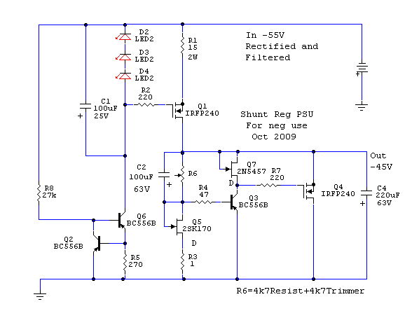

Its not the order a problem, but to be sure you got two legs of the trimmer together as in that little pic I showed on #1971. Because on the original schematic I just describe the Rref with a note on the CCT, I am afraid of maybe a possibly wrong connection there.
Joined 2009
You'r right the middle leg was connected to gnd, now I changed & left like you said.
LED's aren't sining.
Vout 0V.

Just so you know, for testing, The CCS circuit alone can be tested. This is how.
1) 200mA fuse just before R1, in series.
2) Disconnect the drain of Q1 (pin 2), leave it disconnected, or connect from drain to ground a 4k7 resistor, 1W
3) replace R1 with a value that will give you a current of about 25mA total.
The LEDs should be on and you should be able to observe a limit current of about 25mA through R1. The current should be limited even if you short the drain of Q1 to ground.
If this works, then you got a functioning CCS, and you can move on to the next part, getting the shunt working properly.

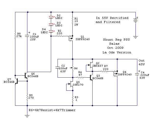

I would like to produce a regulated voltage somewhere between 40 and 50v with about 200mA current both positive and negative. I plan on using it to supply the LME49811 and maybe a second pair to power the driver transistors.

That one will run +/-180mA if your Leds can reach 2V Vf for about 2.5mA. Else, about 150mA. R1 sets that. ICCS=(Vf3LEDStot-Vgs)/R1. Fix it given your actual parts. The trimmer gives you an adjustable Vout. Don't ask more than 65V out. You can use BF245A if you can't get 2N5457, don't use anything more than 3mA IDSS collector load, so to keep the error amp BC546B dissipating conservatively. Remote sensing is recommended. You have seen how on the one I showed for Merlin a few pages back. Good luck.
