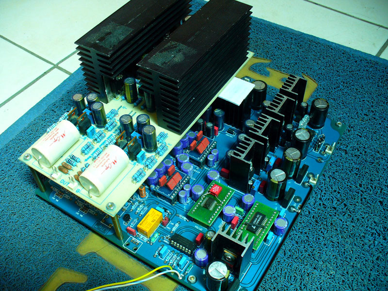

Merlin: Focus on all remaining connections, see detail. Q5's Drain connects up to the 4k7 & 47 node. Trace your work carefully.
La Ode already runs a second circuit like yours in symmetric, this time integrated in his Pass D1 DAC analogue section. Hurry up, we got to compete with Asian productivity, else in IMF we ClubMed soon.😀

That is 6mA on a 10R. Your Jfet CCS works. Your trimmer + resistor seems at full. By turning it off power and measuring across V+ Out and 47R/Jfet node see if your resistance changes when you turn the trimmer. If not, review your connections on it. You will need 7.4k total for 45V.
Now the reg. give a nice 45V, BRAVO I am the happiest man in the world, for all the people will see easy but for me is a big step. The mistake was not connected properly Q4 with C4 & a bad GND connection.
Tomorrow will connect the NJFET RIAA.
Many thanks to everybody & good night.
