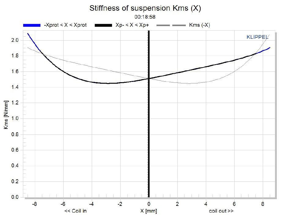

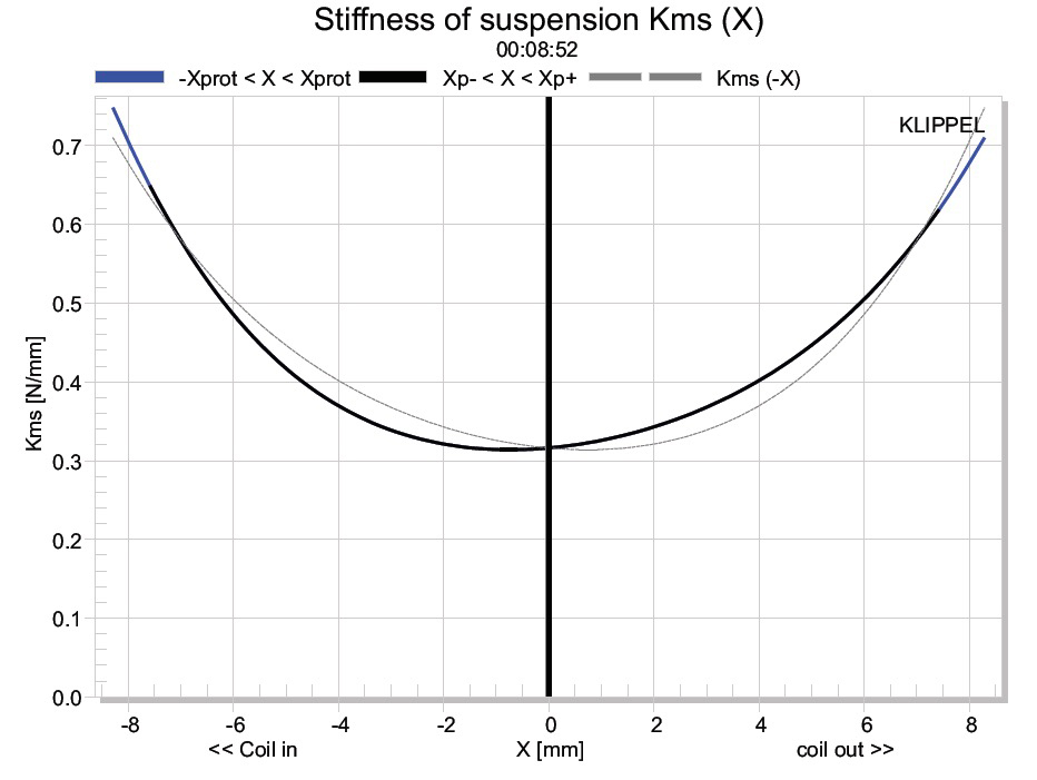

Kippel's Kms (X) however does the job pretty well (..if you've got that data for your driver).
Ex. 1st Revelator 6.5" mid., 2nd SB Satori 6.5" midbass.
