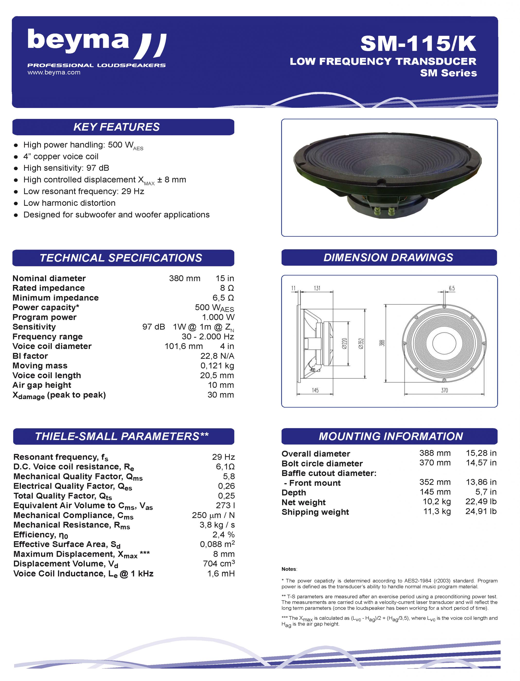

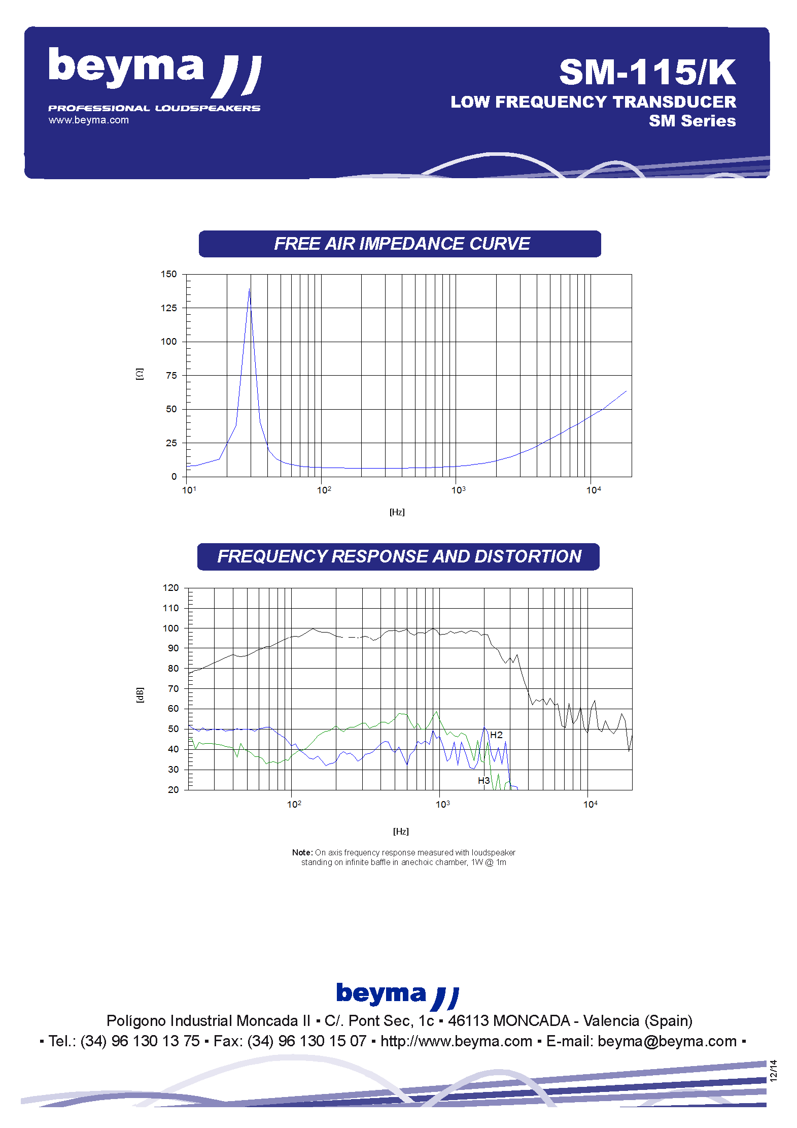

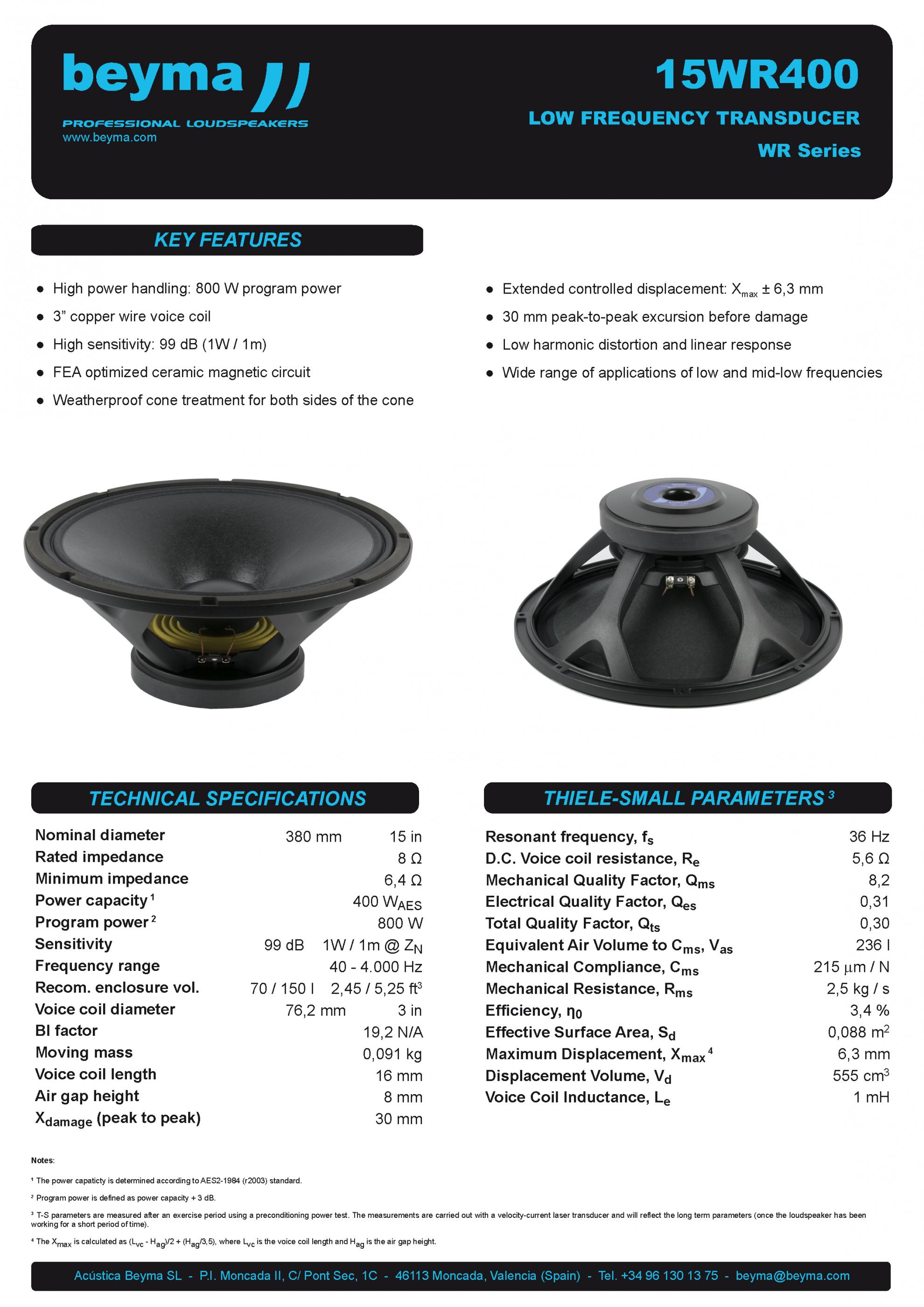

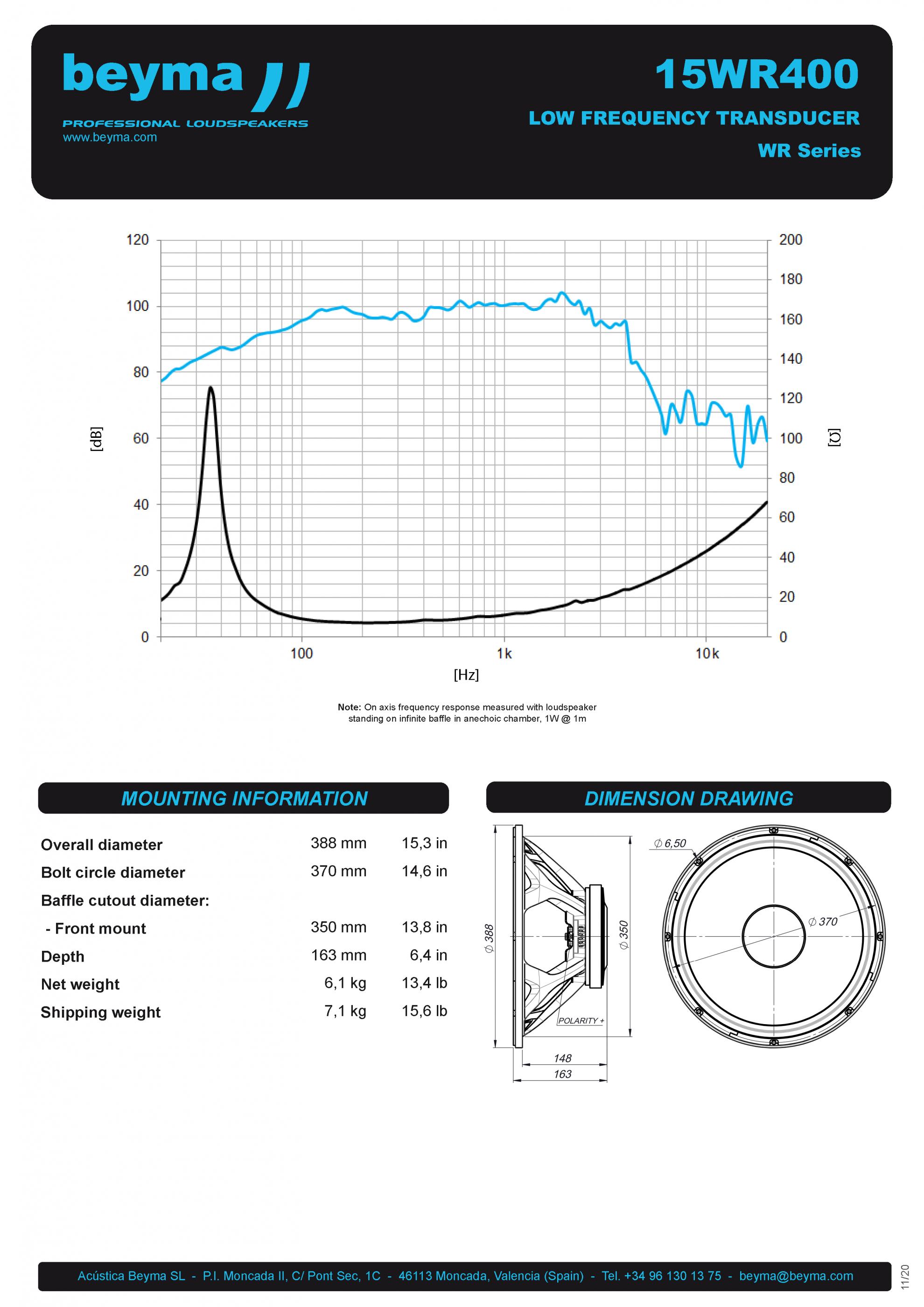

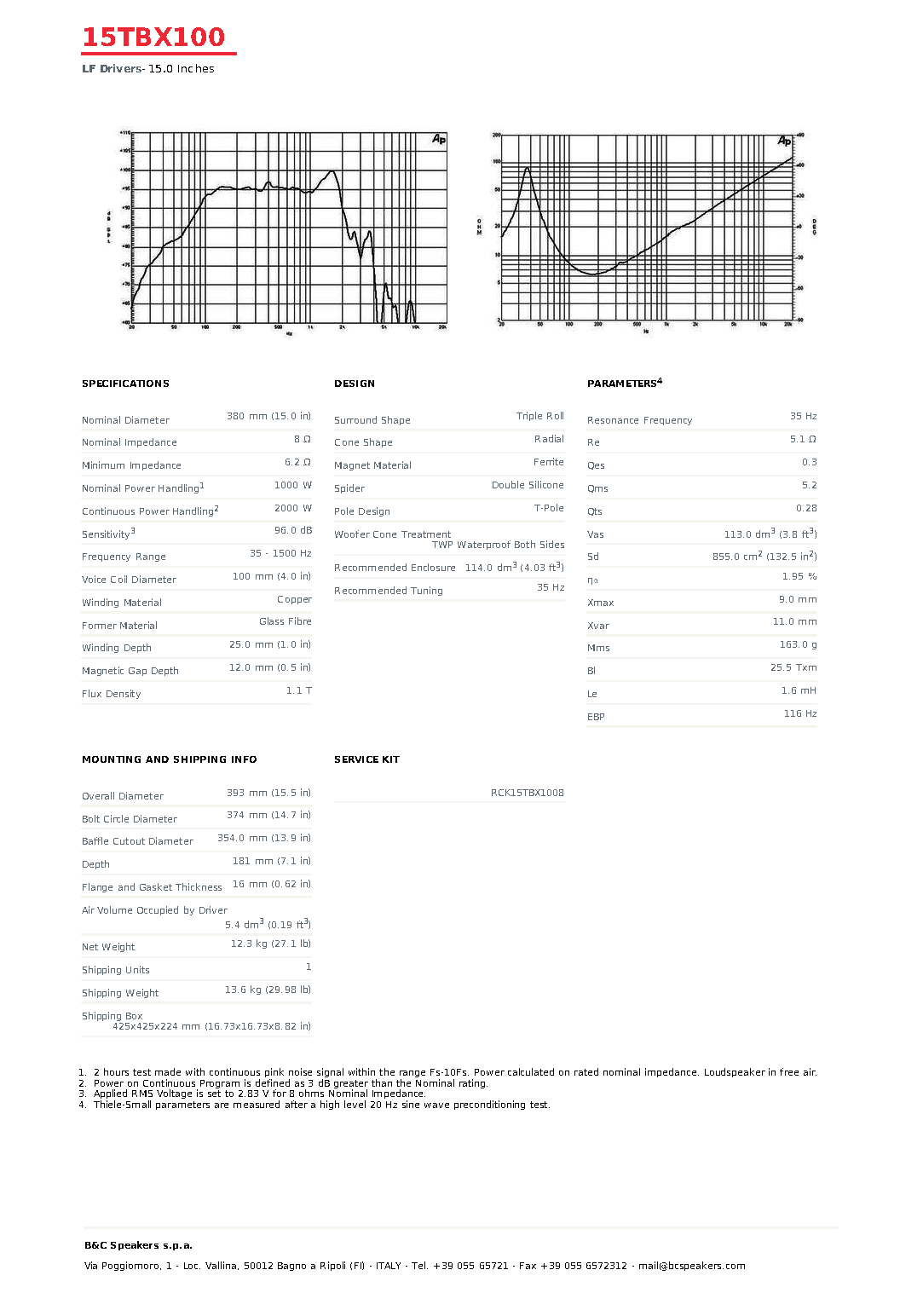

An example of a typical low frequency woofer is the B&C 15TBX100 that was used by Vance Dickason for his big 2 way studio monitor.
On a French forum the B&C was compared to the Beyma 15WR400, a midwoofer.
Unfortunately the plots are lost, but here are some findings:
"The 15tbx100 is a recent techno monster with double spider, supporting 1000w aes with its heavily ventilated 4 inch coil.
The 15wr400 is a relatively light woofer of simple but quality construction with an expo profile diaphragm and simply 3 inch vented coil (400w aes).
Impedance in the open air measured with Limp in sine mode for more precision. fs of 33Hz for the B&C and 40Hz for the Beyma. Basically, it corresponds to the specs, the Beyma gives 4dB more which largely compensates for its "low" power for bass / low midrange use as long as you do not want to go down too much. The B&C will excel in serious low frequency use with very low distortion in this area and the extent of its response. On the other hand, the Beyma wins in terms of distortion over the entire midrange and seems much clearer when listening."

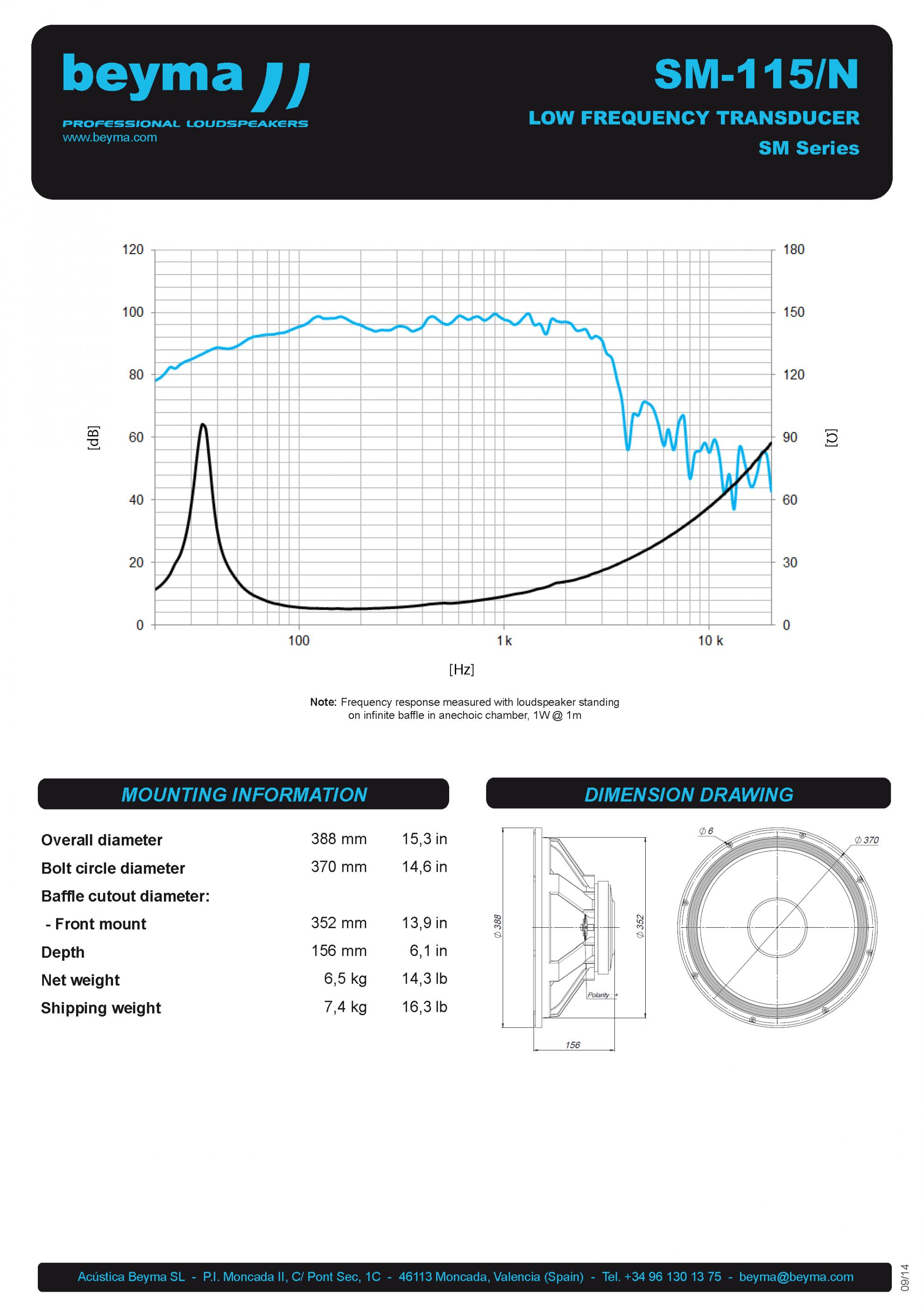

Furthermore, 2 classic Beyma 15" woofers were compared, the SM115K (low. freq. woofer) and SM115N (mid woofer):
"I do not see why they could not go up properly to 600hz, the SM115K does it very well.
If you compare it with the sm115n, it is coherent.
One can be used up to 1kHz and higher, the other to 600Hz or even slightly higher. But there will still be trade-offs, even cutting at 500Hz / 600Hz.
We will either compromise on the bass (sm115n) or the midrange (sm115k).
Ditto, we take almost 10dB more distortion in the midrange or the bass depending on the high pass used, it isn't negligible."

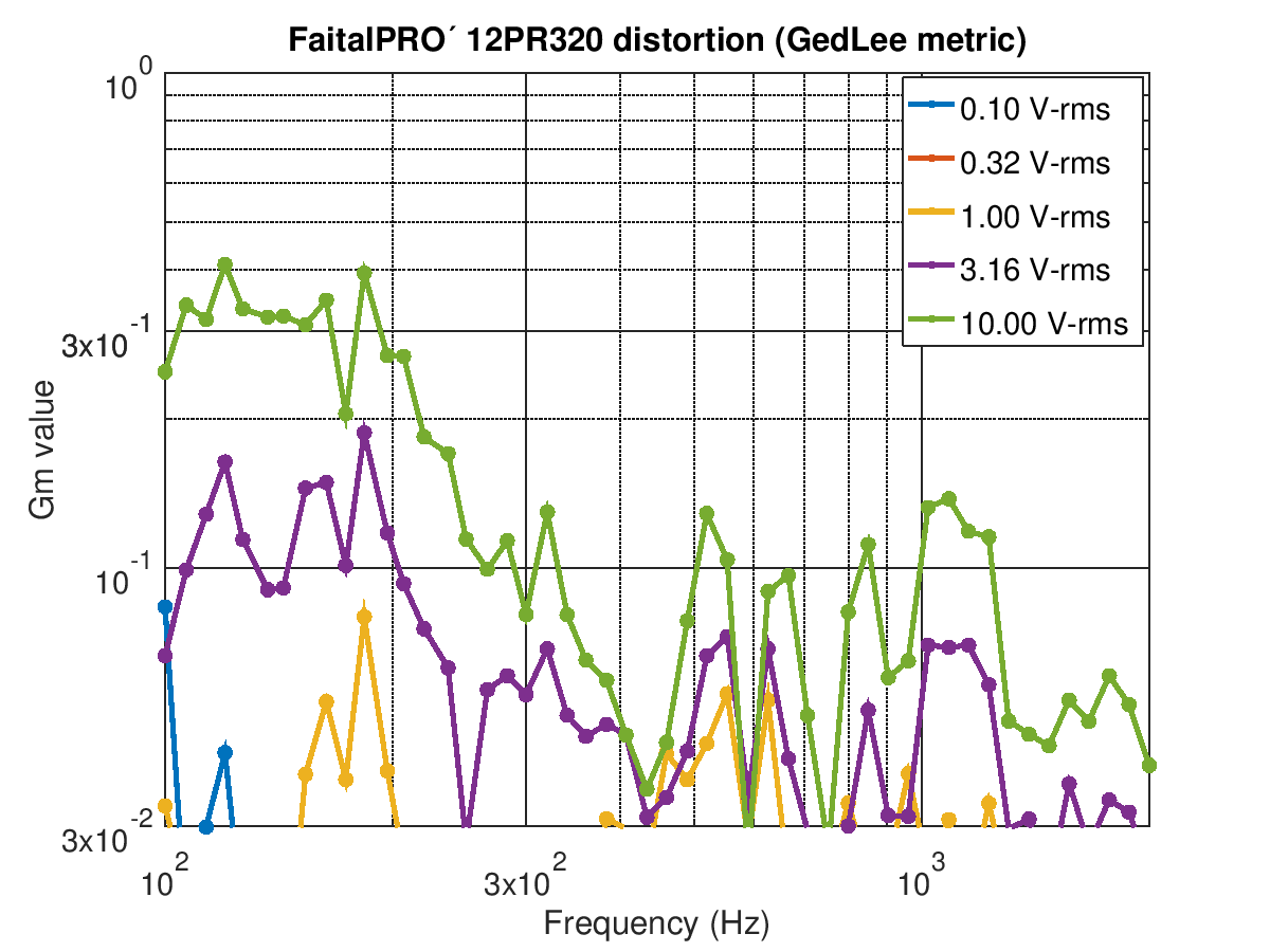

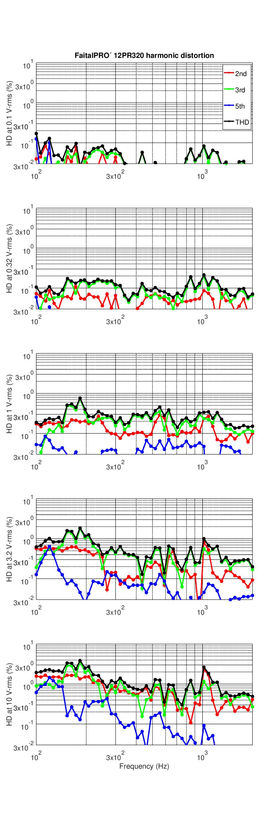

Distortion measurements of the 12PR320:
Obviously, the 12PR320 is not designed for extremely high SPLs, which is illustrated by the AES rating. It should still be loud enough for use in smaller clubs, without premature failure due to mechanical / thermal overload.
Personally, I do not understand the choice of such a woofer in a loudspeaker system which sensitivity is far below that of the woofer.

"Sensitivity" is misleading when considering individual drivers. η₀ is more informative because it's the ratio of the energy dispersed from the cone in all directions to the power applied to the woofer.
Regarding 12-21" woofers, I consider η₀<2% to be low efficient.
From this point of view, the 12PR320 matches the Volt VM752 pretty well, because the efficiency is only 0.5% apart, in favor of the Faital, which is obviously beneficial.
Although my focus is primarily on compression drivers and pro woofers, I can certainly appreciate a large dome mid.
