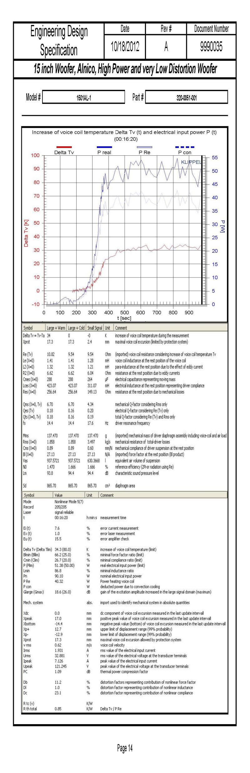

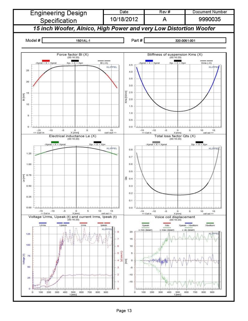

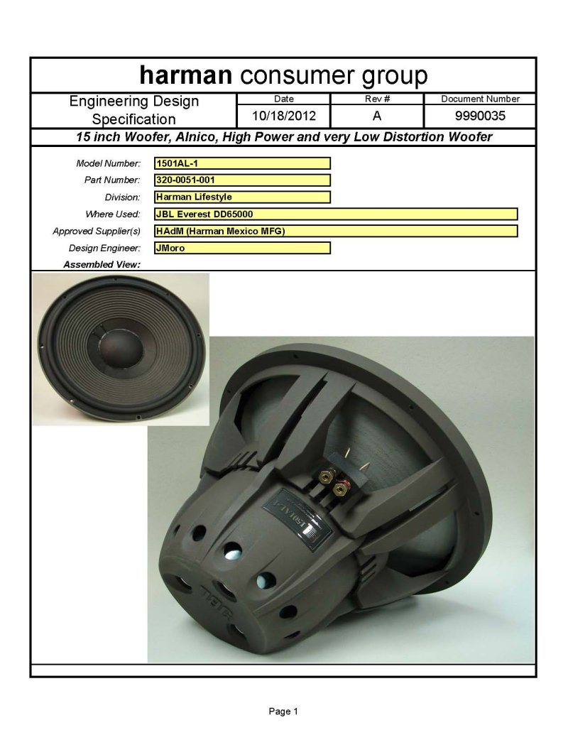

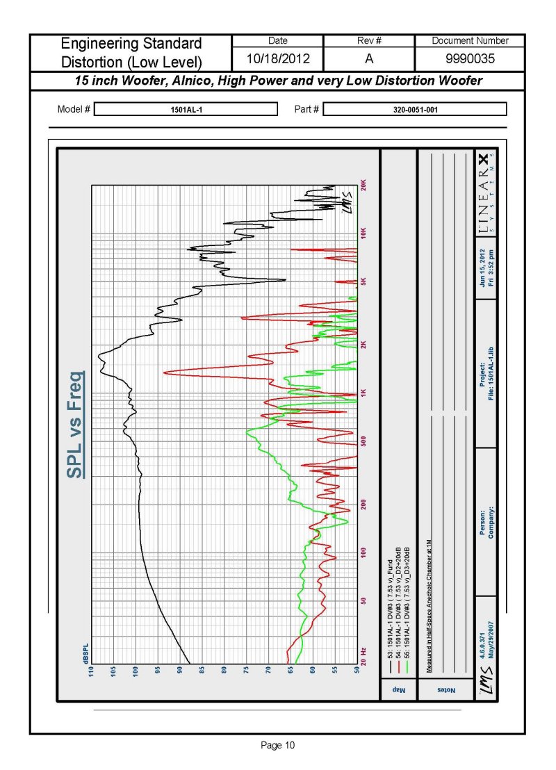

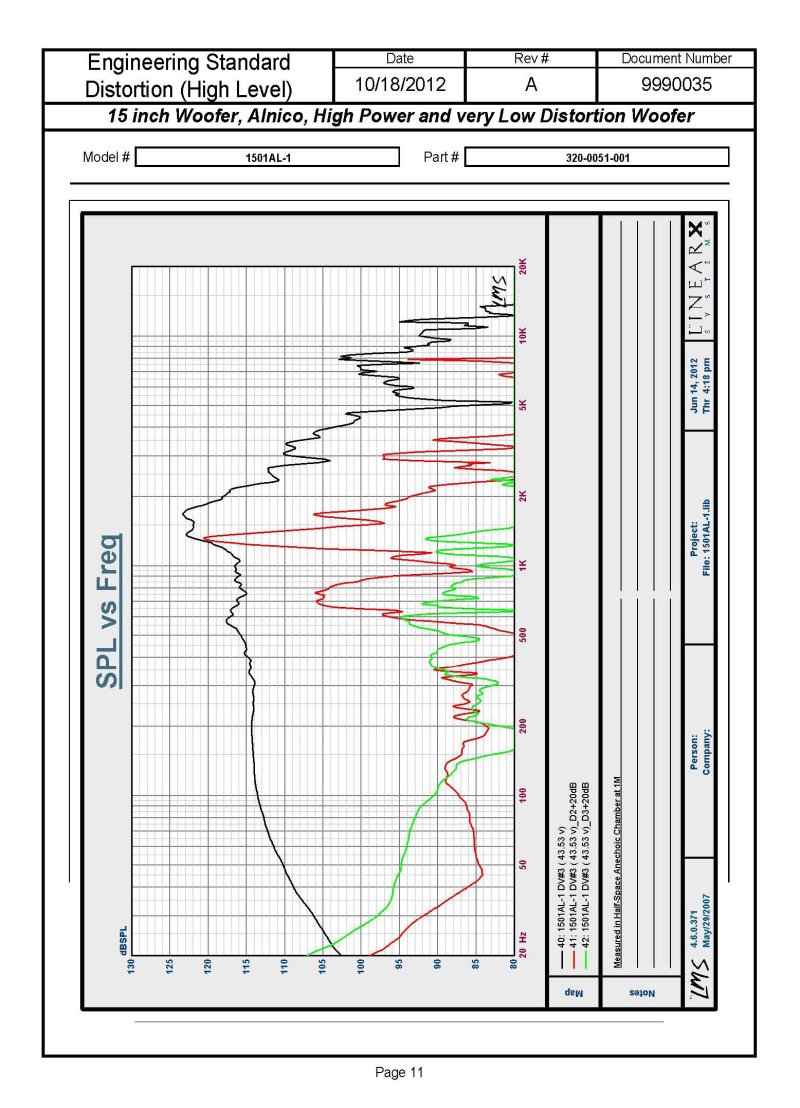

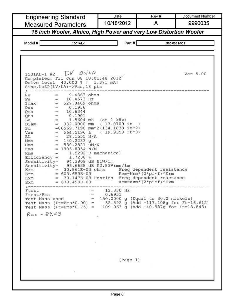

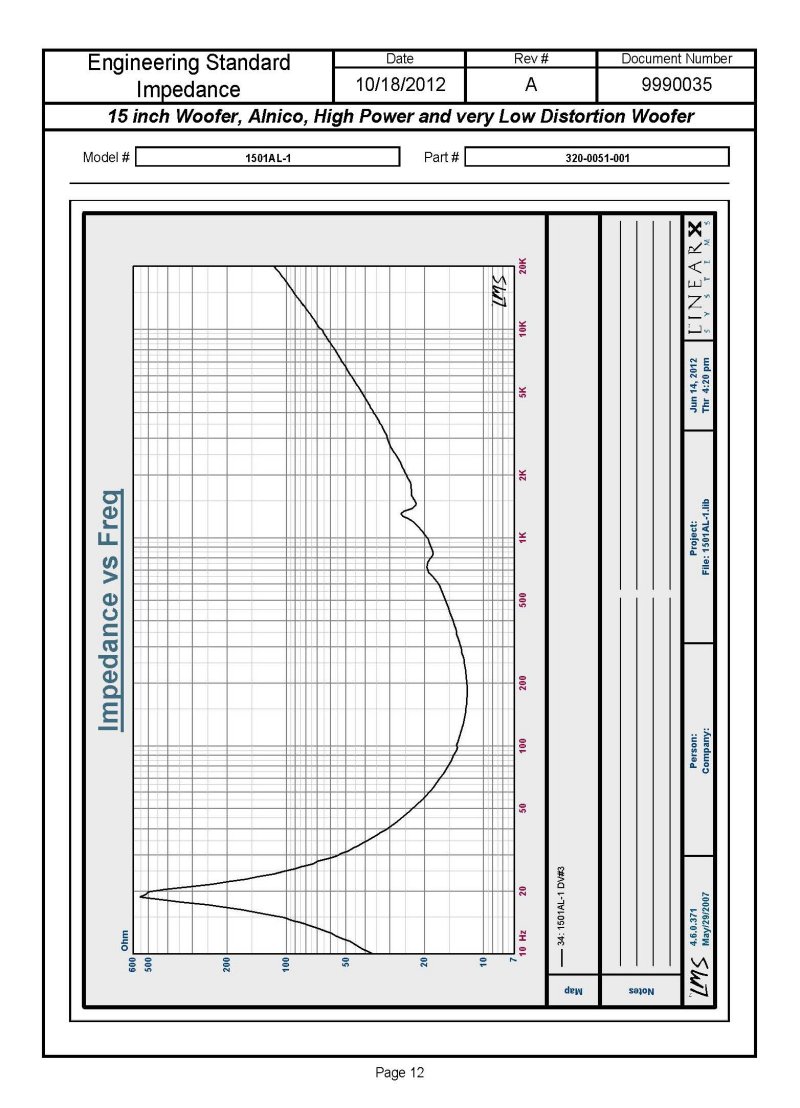

To complicate matters further, here's a beast of a low freq. driver with fairly high Qms.
Obviously this isn't a mid woofer and I know from first-hand experience that it takes a beefy amplifier to breath life into its moving parts.
The force needed to move things is mainly related to the stiffness of the suspension parts and the mass of the moving parts. The mechanical damping / losses are not related to the force needed to move the cone.
Since all mechanical damping is fairly non linear, low Qms is bad when it comes to distortion. 10 or higher should be the goal.
Are you saying that Qms does not depend on Bl?
That's not what I meant. I was referring to Newtons second law, which tells you how much force is needed to move the cone. The driver in post #88 has a very heavy cone+coil and a stiff suspension, so it's no surprise you need a strong amplifier to drive it properly. However, this has nothing to do with mechanical damping/losses (Qms).
That said, I don't see why or how Qms woud depend on BL.
