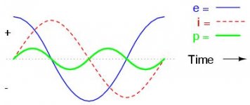

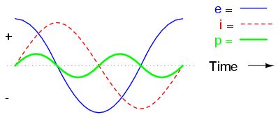

A graphical representation of an idealized inductive circuit.
Since the voltage drop across an inductor is a reaction against the change in current through it, the instantaneous voltage is at a peak when the instantaneous current is at maximum change (the zero line crossing points) and the instantaneous voltage is zero when the instantaneous current is at a peak (zero change).
