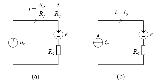

I note that the MATERIAL effects that deliniate current drive from voltage drive is the cancellation of eddy current distortion, which is as I remarked a cubic function, forming a long train of odd harmonics that are mathematically related to the third harmonic, which is the one that is commonly easily measured in speakers and hence can be used as "diagnostic" indicator for eddy current distortion, and the cancellation of thermal compression.
Other effect exists but they tend to be not even of secondary importance (even the Eddy Current Distortion and Thermal compression are really only of secondary importance in speakers compared to sound perception), but of tertiary and lower...
Okay, lets have a look at your list of "current distortion effects" and estimate the magnitude...
Let us take them each in turn (which I neglected to do earlier on...
Okay, you list these first. Let us be clear. If the cone (or voicecoil) is actually allowed to be modulated by external signals (such as those from inside the cabinet or from other drivers) the result will be that the signal is distorted.
In fact, I would note that, if the effect that you mention was sufficiently material to cause problems, it would form the greatest argument AGAINST current drive, as current drive fails to oppose these effects, which are mechanical in nature.
The mechanical and pneumatic non-linearities remain unaffected by current drive. In fact, if drivers are carefully designed to have low distortion with voltage drive (which many current day drivers are) switching to current drive will substantially increase the overall non-linearity, as experienced in one of the reviews of your book where current driver substantially raised the drivers distortion, not lowered it.
Modern drivers tend to carefully control these problems, in fact even many vintage drivers are surprisingly good in this context.
BL variations are caused by varying field stength for different postions of the voice coil. The effect on the impedance in the midrange is minimal, the actual reason the impedance is modulated is varying inductance with the position of the voicecoil respective to the polepiece.
The effect remains minimal in drivers that do not have great excursion and remains still small in the midrange as the inductive reactance of the voicecoil is low at midrange frequency.
It is a problem in full-range drivers however, which is why many (even vintage ones) used some form of inductance control (copper cap on pole piece, short circuit rings etc...) thus minimising these effects at the outset.
By comparison the direct distortion produced by this varying field strength is very large (and 2nd order HD and related IMD) and remains unaffected by current drive.
In fact, if careful design is used to offset mechanical non-linearities in the suspension with those of the magnetic field in Drivers (which modern FEM analysis allows and which modern speaker designs often apply) using current drive will materially increase this primary distortion mechanism.
Now we are at one of the biggies, where current drive does indeed produce large changes.
I have always known that tube amps produce 3rd HD along with other harmonics if that is the great knowledge you thought I was lacking. I am also fully aware that harmonics originating from different stages in the signal path may strengthen or weaken each other. However, the whole issue of 3rd HD is rather secondary in the whole scope of the current distortion effects, that are largely nonharmonic or phase muddling or even indefinite by nature.
Voice coil acting as a microphone for the sound waves reflecting from the cabinet interior and passing through the diaphragm
- Voice coil acting as a microphone for the sound waves from adjacent drivers
- Mechanical and pneumatic non-idealities of the moving parts causing unpredictable EMF-effects
- Bl-variation causing modulation of impedance's angle and hence phase modulation of current at middle frequencies
- Position-dependent inductance of voice coil causing both amplitude and phase modulation (as in post #66)
- Voice coil inductance depends strongly on current level (without any displacement) causing non-harmonic distortion
The effect is quite well measurable and very material at lower mid-frequencies. It corresponds to placing a poor-quality microphone inside the enclosure and mixing the microphone signal thus gained with the original one. Perceiving it requires only application of Kirchhoff's and Ohm's laws. Figure 'a' (attached) represents the case under voltage drive, where u0 is the amplifier output voltage, Rc is voice coil resistance, and voltage source e represents here the microphone EMF, that appears in series with the applied voltage and hence modulates the current through the voice coil. (The actual motional EMF due to intended diaphragm motion also appears in series with the other voltages but for simplicity is not drawn here.)
Instead, in Figure b, where the amplifier is now represented by a current source, the same microphone EMF appearing in the circuit is now unable to modulate the current, which is entirely determined by the feeding current source. Thus, the microphone feedback modulation exists only on voltage drive, and it does not exist on current drive.
Someone is now surely remarking: Hey, the damping factor takes care of all that on voltage drive by controlling diaphragm motion! The truth is, however, stranger than wishful thinking. As I explained earlier in post #202, electrical damping is nonexistent outside the resonance region (above 200 Hz or so for woofers) and therefore is of no help in this issue.
The magnitude of the effect is proportional to the square of driver sensitivity. For low-efficiency woofers of 87-88 dB/W, the feedback ratio is at least 3%, but in poorly damped cabinets considerably more. When the sensitivity is raised just to 93 dB/W, feedback ratios over 10% result; and I don't even go to PA:s.
The outward microphone coupling from adjacent woofers is rather appreciable too. It is lower in magnitude than the inwardly coupled microphone EMF but extends higher in frequency.
In a low-efficiency coaxial driver, EMF coupling from the treble unit to the bass unit varied between 1 and 2 % in a wide frequency range, and the effect doubled when the cone was moved a few millimeters. The square law with sensitivity also holds in these.
(The leakage of enclosure noise through the cone is of course a problem in itself (Only open baffle designs are free from it.) and can also be determined quite reliably. It can only be addressed by heavy use of effective damping material which also serves to lower the mechanical Q.)
This is about non-idealities at mid-frequencies. While the non-idealities in themselves are not affected by current-drive, they have a corruptive effect on the motional EMF, which is yet significant at these frequencies, this degraded EMF then further degrading the current on voltage drive just as happens with the microphone EMF (see the figures).Originally Posted by ETM

Again, the attached equivalent circuits illustrate the principle. The voltage source e represents now the voltage across the voice coil inductance, that is, the inductive EMF produced. Due to the magnetization nonlinearities occurring in the system, e is not a linear function of the original signal but reflects all the iron-based aberrations, that on voltage drive become injected to the voice coil current.Plus, current drive changes neither the inherent magnetic system of the speaker, nor does it change the magnet field from the voice coil so any negative interactions remain unaffected, as far as they impact the output from the Driver.
For audiophiles who regularly refresh their contacts this may not be an issue, but with aged and oxidized contacts in layman use, with poor connectors and switches or relays on the path, the situation is entirely different and therefore worth giving a mention. Mechanical vibration is also a degrading factor, and sometimes outputs are protected by fuses, that itself are also nonlinear.Originally Posted by ETM

So, let me get this right. You are saying the microphone effect is significant (we come back to that later), yet in the train of tought you also comment on the non-existence of damping (correctly so, I may add, if using multiway speakers with passive crossovers). Now no electrical damping (or low electrical damping) is actually in our case caused by feeding the woofer from a high impedance, which approximates current-drive.
So first you are saying the effect is material and then dismiss your own notion (correctly I might add).
Thank you for doing my work for me.
This deserves a little more consideration.
First, the "poor quality microphone" is not anywhere near as bad as you make out. If it was, it would also be a poor speaker.
Secondly, the voice coil can only induce a voltage if the cone is being moved by the sound pressure of the sound bouncing around inside the box, of applied by another drive unit. So in the first instance the problem is that cone is being moved by an unwanted signal, that causes all sorts of interference.
This already has to have happened in order to for the voltage to appear. So, in fact, the voltage that appears is NOT actually the CAUSE for distortion, it is the RESULT of mechanical distortion.
With voltage drive (especially in active systems) the virtual short-circuit of the Amplifier will actually attempt to counteract this unwanted cone movement of the driver, by distorting the current in the voice coil in opposition to the unwanted cone movement.
However as electrical damping is minimal in speaker drivers (except at resonances), as you so astutely observed, the amplifier does not succeed too well. Hence essentially the distortion is only reduced by a small amount, when using voltage drive, compared to current drive, I would be surprised if it would even be measured reliably in the midrange (due to the drivers Z approaching the voice coil DCR closely - exception compression drivers).
So in this particular case the single-minded focus on not distorting the current in voice coil leads to greater distortion in the actual output of the speaker, even though it can be argued that the current in the voice coil is now less distorted. At any extent, my main point was actually that the effect is so marginal in magnitude regarding the driver output, when comparing it between current and voltage drive, that it can be safely consigned to the "insignificant" effects in the context.
First, these "humps" are not down some magical EMF non-linearity, but to cone/diaphragm resonances. And again you vapous statement that are empty. Something can be quite pronounced in something else, meaning it is unlikely in actual reality to be common, even though extreme cases happen.
Yes. To be clear. In the range where the impedance modulus is it is low precisely because the inductive reactance is low compared to the voice coil DCR and the motional impedance is low compared to the voice coil DCR. Therefore effects from modulating either in the very range you claim this effect takes place is the range where it is most difficult to demonstrate.

...electrical damping is nonexistent outside the resonance region (above 200 Hz or so for woofers) and therefore is of no help in this issue.
In many mid-woofers, there can be seen humps in the impedance graph resulting from these EMF irregularities, and notably in high-efficiency drivers they can be quite pronounced.
No, the angle modulation is a separate effect that stems from the geometry of the vectors of the three components of impedance (DC resistance, motional impedance, and inductive impedance) in the range where the impedance modulus is low.

Your reading comprehension fails. I wrote: "As I explained earlier in post #202, electrical damping is nonexistent outside the resonance region (above 200 Hz or so for woofers) and therefore is of no help in this issue." That means the electrical damping is nonexistent regardless of the driving mode, that is, on voltage drive as well as on current drive. Thus, the electrical damping, that is commonly believed to 'control' cone motion on voltage drive, is factually nonexistent at the frequencies of interest and therefore of no help in this issue of EMF feedback on voltage drive.ThorstenL said:So, let me get this right. You are saying the microphone effect is significant (we come back to that later), yet in the train of tought you also comment on the non-existence of damping (correctly so, I may add, if using multiway speakers with passive crossovers). Now no electrical damping (or low electrical damping) is actually in our case caused by feeding the woofer from a high impedance, which approximates current-drive.
You still hold on to the belief that the short-circuit of the amplifier attempts to counteract this unwanted cone movement. It doesn't even attempt. This is also a thing that can be determined by simulation; no need to argue about it.ThorstenL said:...This already has to have happened in order to for the voltage to appear. So, in fact, the voltage that appears is NOT actually the CAUSE for distortion, it is the RESULT of mechanical distortion.
Below is shown the electrical equivalent circuit of a driver (so-called mobility analogy), representing the electrical and mechanical parts. (The dependent sources Em and Id make up the transformer between the electrical and mechanical sides.) The example values given represent a typical smallish woofer in a closed enclosure with the following parameters: Bl = 6 Tm, m = 0.008 kg, spring constant = 2000 N/m, mechanical resistance = 1.5 Ns/m, and Rc = 6 Ω. I this analogy, current flowing to the resonator L-R-C represents applied mechanical force and voltage across the resonator (U) represents diaphragm velocity. Current source Ix represents here the external mechanical force that now attempts to move the diaphragm.
When the switch is closed, the operation corresponds to voltage drive, while an open switch corresponds to current drive. By running an AC analysis in both states with Ix as the input and recording voltage U, that indicated the velocity, the difference in diaphragm motion is that shown in the graph. This is the amount of electrical damping that is obtained when the driver operates short-circuited. At the same time, it gives the difference in frequency response between pure voltage and current modes.
At the resonant frequency, the damping reaches here 14 dB, but already one octave away from the resonance it has dropped below 4 dB. Two octaves from the resonance, only less than a decibel is left. This basic model still omitted voice coil inductance. If an inductance model is added in series with Rc, the falloff will be even steeper.
Thus, the belief that the short-circuit of the amplifier would counteract unwanted movement outside the resonance region is fallacious. It is a widespread imagination indeed and a basis of prejudice against current-drive.
Hence, the unwanted cone movement caused by the bouncing pressure inside the enclosure is independent of the driving mode, and so is the microphone EMF voltage component induced according to the law e=Blv. The only difference is that only on voltage drive the current becomes distorted.

You haven't understood the basic equivalent circuit in my post #267 and its relation to driver impedance. Everything that appears in the impedance curve in addition to the DC resistance is due to EMF:s, either motional or inductive. Resonances itself cannot affect the curve unless they modulate the motional EMF, and all irregularities in the EMF do not give rise to visible changes. Examples of how likely they are can be found in this Pass articleThorstenL said:First, these "humps" are not down some magical EMF non-linearity, but to cone/diaphragm resonances. And again you vapous statement that are empty. Something can be quite pronounced in something else, meaning it is unlikely in actual reality to be common, even though extreme cases happen.
In the range in question, the inductive impedance and motional impedance are typically some 30% of DCR, but due to their phase relationship they largely mask each other in the impedance curve. The effect can be demonstrated by simple reasoning as the motional impedance varies according to (Bl)^2.ThorstenL said:Yes. To be clear. In the range where the impedance modulus is it is low precisely because the inductive reactance is low compared to the voice coil DCR and the motional impedance is low compared to the voice coil DCR. Therefore effects from modulating either in the very range you claim this effect takes place is the range where it is most difficult to demonstrate.
I would not call it "non-existent", but limited by the voicecoil DCR.
