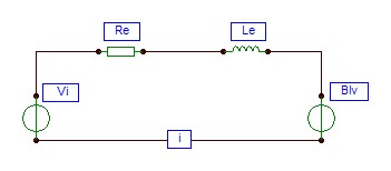

the conversion of electrical to acoustical energy takes place at the cost of high distortions and large losses. Unfortunately, from a practical point of view, distortions and losses are inversely related. The main energy conversions carried out in loudspeakers are voltage-to-current, current-to-voltage, electrical-to-kinetic, kinetic-to-electrical, and kinetic-to-acoustical.
The familiar law of winding force
F = Bli
where
Bl = motor strength
i = input current
The back EMF induces an opposing voltage proportional to voice coil velocity by converting mechanical energy of motion to electrical energy. Due to the presence of an external electrical load a harmful current will enter the amplifier.
e = - Blv
where
e = induced voltage
v = velocity of motion
When the input signal is a voltage, the course of events gets considerably more turbulent as the voltage-to-current conversion occurs according to
i = Vi - Blv / Ze + Zem
where
i = output current
Vi = input voltage
Ze = electrical impedance, consisting of voice coil DC resistance and voice coil inductance
Zem = electrical motional impedance created by the back EMF; during an expanding magnetic field the back EMF acts as a load, the voltage is 180° out of phase counteracting the current flow, thereby increasing the electrical impedance, basically Zem = e / i
Ze = Re + Le
v = Bli / Zmt
where
Zmt = total mechanical impedance (the ratio of force and velocity)
Substituting Ze and v provides a more detailed definition
i = Vi / (Re + Le) + (Bl)² / Zmt
Now the electrical motional impedance appears as
Zem = (BL)² / Zmt
And the motor force is given by
F = (Bl)Vi / (Re + Le) + (Bl)² / Zmt
The function of the permanent magnet moving-coil motor is governed by instantaneous, constantly varying, strongly interactive parameters, constituting a well-founded basis for concern when a linear mechanical motion is desirable. The most deleterious product of the nonlinear interaction between the static and the AC magnetic field is an inductance that brings about a rise in impedance, restricting the driving current, altering the frequency response, causing harmonic, intermodulation and phase distortion.
The intrinsic fluctuations in load impedance undermine the accuracy of the crucial voltage-to-current conversion and exacerbates the vicious circle of nonlinear modulations.
In order to significantly reduce distortions both in the loudspeaker and in the amplifier, the signal needs to be a current, supplied from a transconductance amplifier with high port impedances. The aim should be high isolation between amplifier and loudspeaker, between amplifying stages and between their input and output terminals.
Not very oddly, for good proportionality between the output voltage and the input current, the EMF voltage source needs to approach the properties of an ideal voltage source, and again, it needs to be supplied from a (nearly ideal) current source.

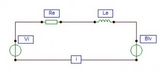

F = Bli
where
Bl = motor strength
i = input current
e = - Blv
where
e = induced voltage
where
i = output current
Vi = input voltage
Ze = Re + Le
v = Bli / Zmt
where
Zem = (BL)² / Zmt
