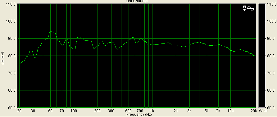

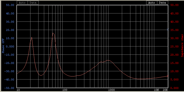

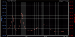

I am interested in Salas "tired2way" speaker. I have purchased the drivers for it and am now thinking of the cabinet and filters for it. From what I can see the filter is a second order Butterworth with an additional RCL-link. Can you please explain the filter a little for me? What is the crossover frequence? I have tried to figure that out but I am unsure of it.
The cabinet: do you recommend me using the dimensions or altering something? I know you reused a cabinet for this construction so I wonder if you thought about something to modify to make it even better?
Since I am building the speaker from scratch I see this possibility.
I hope I am not asking too much with this, but it would be nice to read your opinions.
Hello. Unfortunately I could not find the full Leap files for it. From some notes I found, it has 2.4K cross point, 35Hz port resonance, the impedance does not go below 6 Ohm. Its not adhering to textbook roll off, acoustically is 2nd order. It was tweaked by ear +/-10% after the best crossover topology got homed in. What I posted is what used finally. I don't recommend altering box volume or dimensions anything because the diffraction is going to change and the bass resonance was well defined anyway. It still serves in my friend's system very well. TT, DAC, pre, amps, many times changed or tweaked, but he is happy with the speaker still. I recommend 50-100W amp. Will be happy to see your version finished and posted in the threads, maybe opening a build thread for it.
On a luckier note, I found in a portable computer some measurements for it. Here is the impedance, and a frequency response chart from the pair in room at 2.5m distance on sofa sitting, ear axis. This is not bass near field spliced, or anechoic, its pink noise one point, 2 speakers playing.The impedance shows it does not fall below 5 Ohm, not 6 as my notes were saying. Maybe the notes were older with a higher testing tweeter resistor, or just noting the power range region of interest. Its 3 years now and I don't remember exactly.
