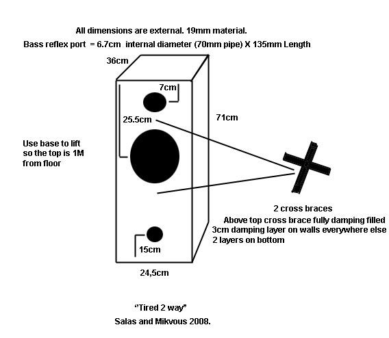

Tired 2 Way Box
roger_lew said:
Salas,
Your Seas/HDS 2 way looks intriguing. Where is that one documented?
Roger
Salas said:
Nowhere. I have the Leap crossover schematic data, I must measure the cabinet dimensions when I will visit my friend's place really soon and I will post here.

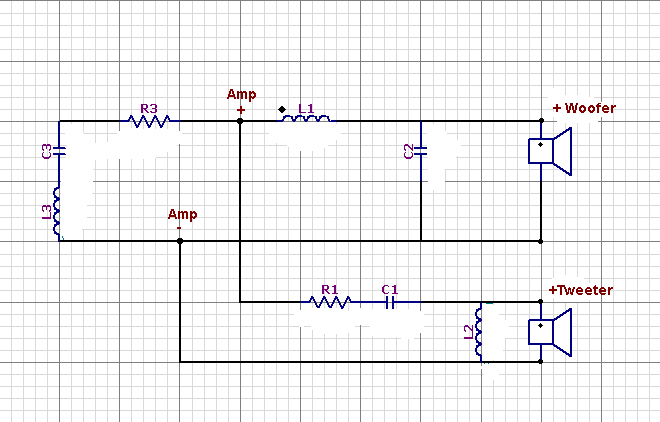

Tired 2 Way XO
Woofer = SEAS CA22RNY
Tweeter = Peerless HDS
L1 = 2.5mH (2mm d. wire)
L2 = 0.25mH (1mm d. wire)
L3 = 1mH (1mm d. wire)
C1= 4u7//0.68u PP high quality
C2 =10u//2u2 PP high quality
C3 =33u NP//0.22u PP high quality
R1 = 3R9 10W Mills
R3 = 15R 10W Cement
No polarity inversion nowhere. All inductors air core.

Salas,
Thanks for the drawing and the crossover schematic. I'm very impressed. I can definitely see the value in this combination.
My dad's been talking about getting some floor standing speakers. Maybe I can talk him into letting me build him a pair.
Roger
