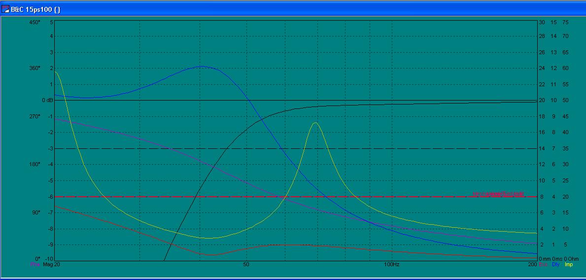

Yeah, maybe so. The B&C 15PS100 is pretty good. The -3dB point is about 45Hz, sensitivity is about 94dB, in a 2.5 cu ft vented box tuned to 42Hz. Group delay peaks about 12ms just below the -3dB point. With 300watts in, I see about 115dB at the -3dB point. The tweeter would have to be padded down heavily of course.

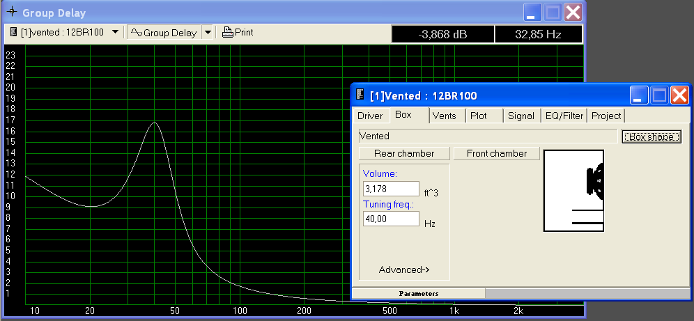

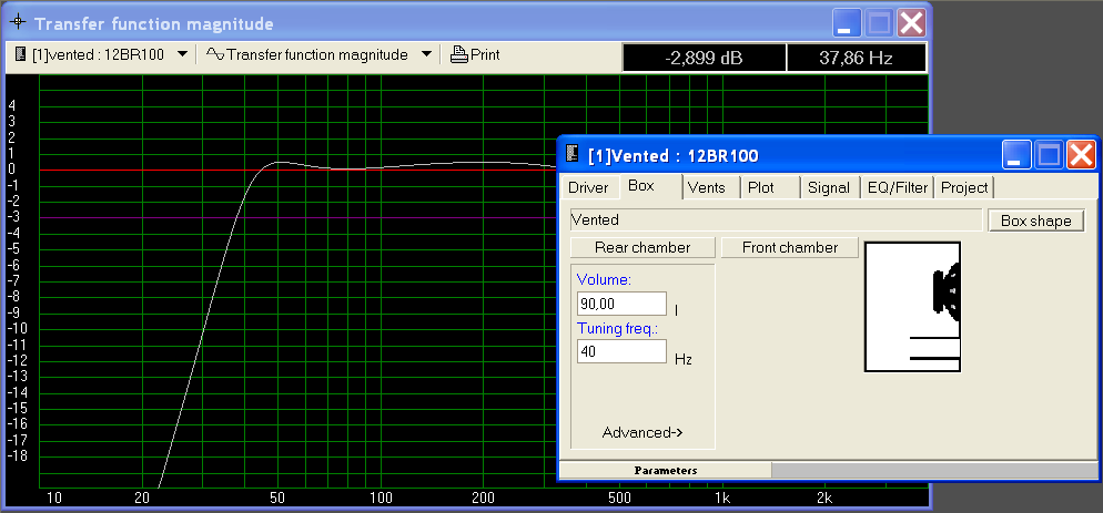

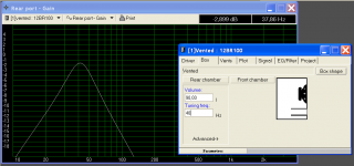

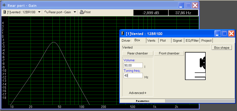

attached simulation 12br100 94dB 1wmtr tuned to 40Hz 90liter.3,2cu/ft -3dB 35Hz. group delay 17msec on tuning frequency. Higher delay does mean more resonant.
The 12br100 and the 180 sound horn plus driver will cost you some where between 250 and 350dollar for a set. So you can build a hornloaded studio monitor -3dB 35Hz-18kHz 94dB 1Wmtr under 1000dollar.:spin:
first picture driver response second basreflex port response last groupdelay.

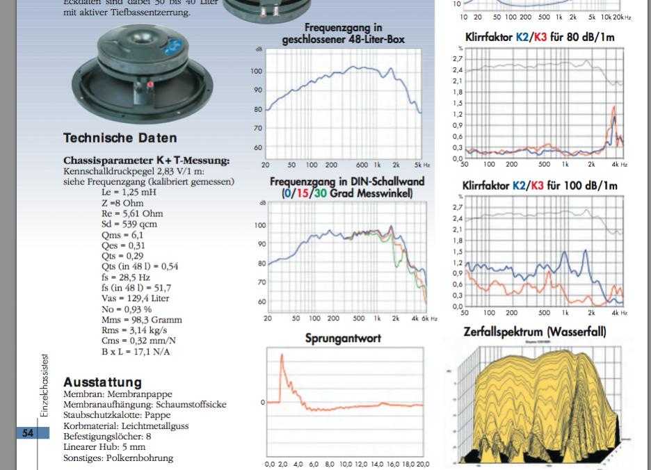

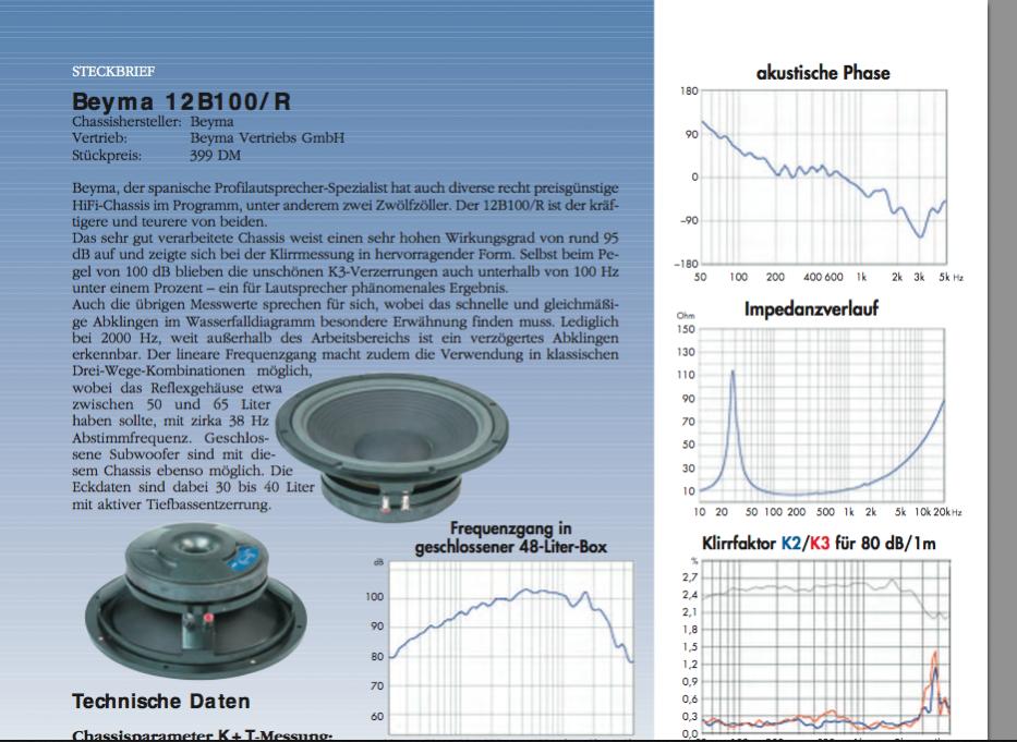

additional data on the 12br100 from "Klang und Ton" a recommended diy loudspeaker magazine. Very good controlled THD with low third harmonic even at 100dB.

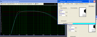

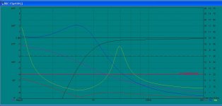

Do not forget great bargains of eminence most of them have great TS-data for good bastuning.
Here Kappalite-3015LF 97dB/1Wmtr (big enclosure) and the beyma 12br100 94dB1wmtr.
