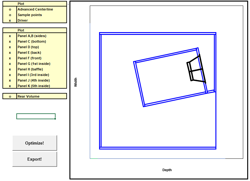

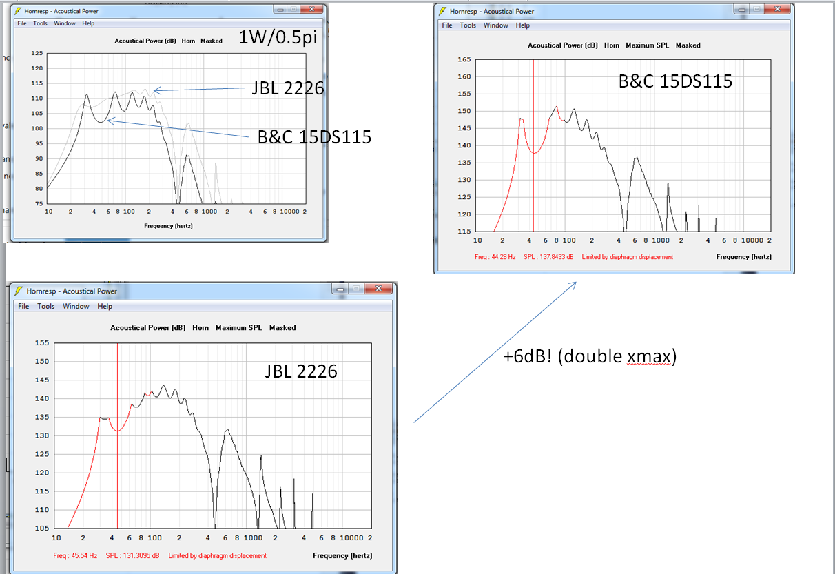

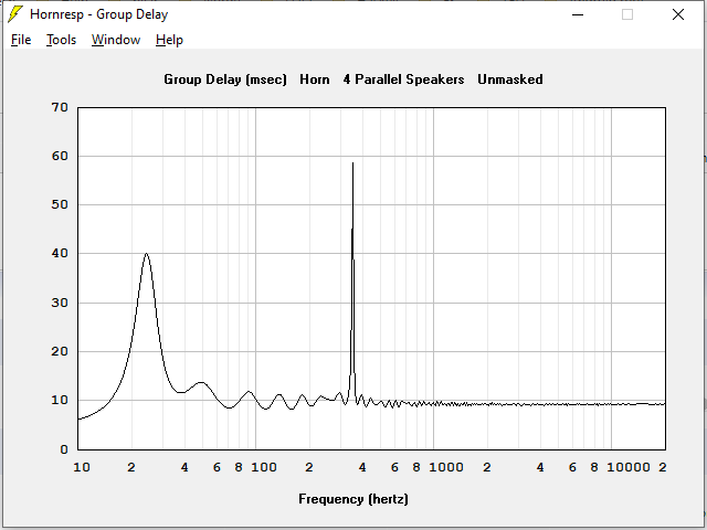

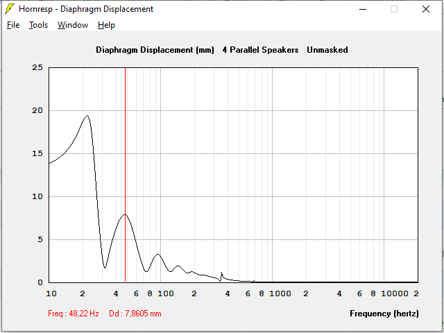

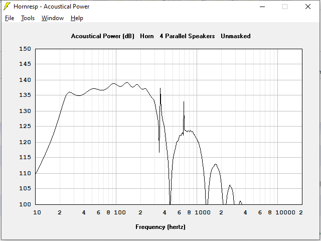

Hi everyone.
I'm new to this forum, and i plan to build a 30 Hz horn with 2226J and drive it with a tube amp that i also planning to build. Live cabinets built right is MY way to go. After i heard the Ocellia Kedros Silver in 2003 i was absolutely stunned. 2 watt of tube amp and it really define what's possible if you are truly up for the match.
