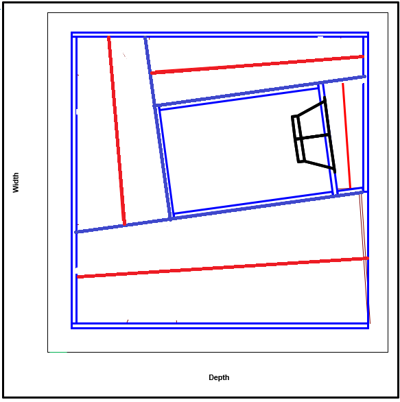

Its a really nice design. Convenient shape with the square inside a square, but tilted.🙂
While the other has a moving mass with momentum to keep it smooth, while probably a lower Fs and Qts combo for a lower FB potential and the lazy air column shaped for the deep pipe or BLH like air column shapes that suit it?

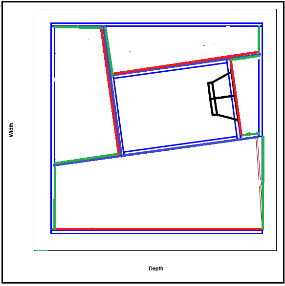

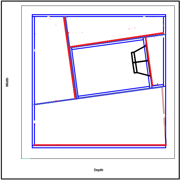

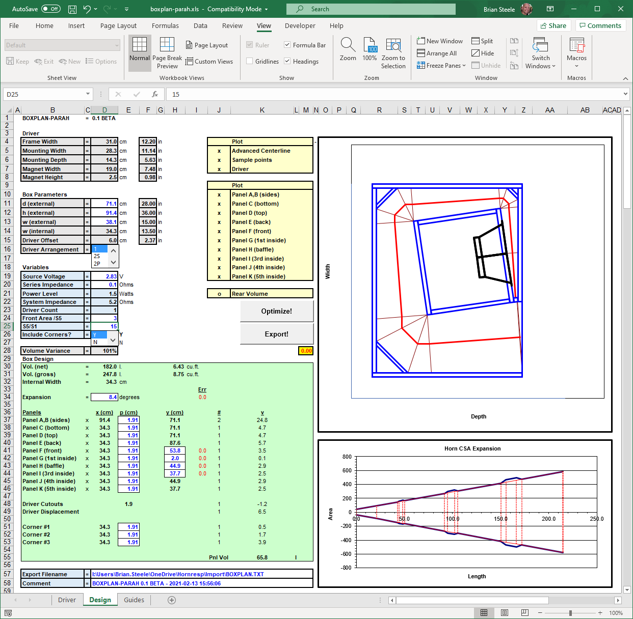

I had a go at simulating it with the 15DS115 as a higher performance driver
I did a few simulations with the 15DS115. I tried various alternative shapes using my parabolic layout. I could not find a better layout than the 2226.
I also made a Hornresp optimized horn. And in a horn optimized for JBL 2227. The 2227 is much better. Quite surprisingly.

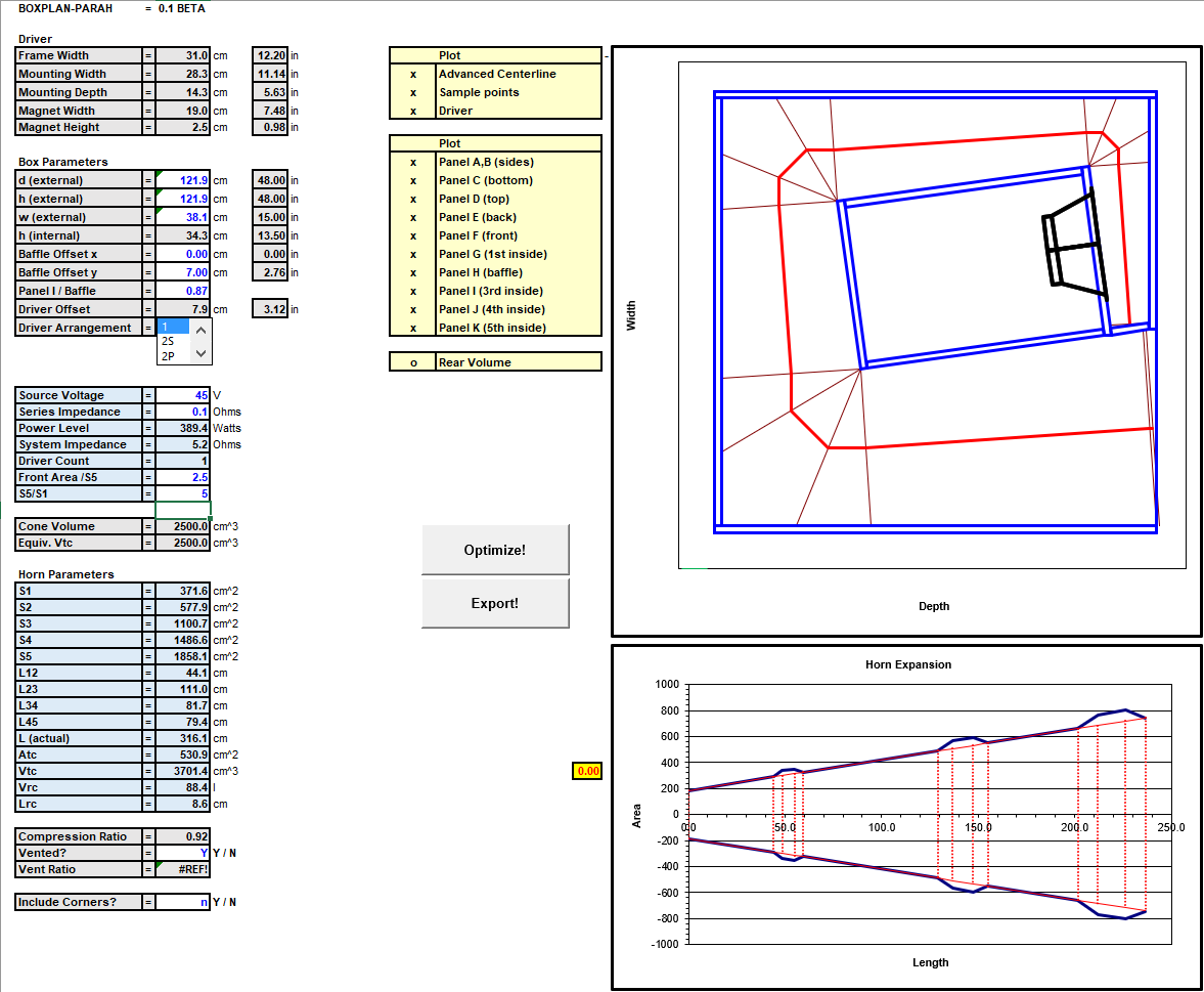

The Optimization process turned out to be surprisingly simple after I mapped out the path. Now it's just to clean up some of the calculations and the layout of the workbook, and it should be good for use.
Note, with a simple tweak this can be converted to an approximated conical or exponential horn. Might look into that over the weekend.

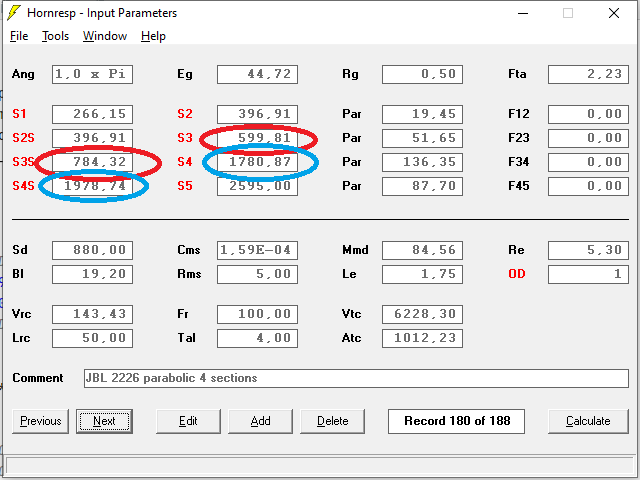

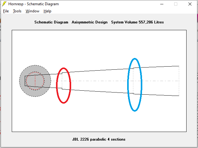

It is possible to change the area at two corners. And still be Hornresp compatible.
I'm not sure I understand what you mean.
Great work Brian, I will check it out. I am particularly excited by the possibility of other flares so I can try to maximize output for PA use.
It says v0.1 BETA, but I think it's just about finished, unless someone turns up a bug in the workbook when they play with it.
On my site, it's the BOXPLAN-PARAH workbook.
Great work Brian!

It should be possible, but require quite a bit more work. The challenge is defining exactly where the "step" takes place in the model of the physical layout. It's possible that some path length errors might be introduced in the process.
Doing it that way is probably going to introduce a few path length inaccuracies, resulting in the built horn having a slightly higher Fc than the Hornresp model predicts.
The key is to end up with a Hornresp model that has the same (or less) net volume than the box design suggests it should be. If you have a folded design that has the same net volume and path length as the corresponding Hornresp model, then it's likely the effective path length is going to be a little shorter, because each rectangular fold in the horn results in a slight shortening of the path.
That's the lesson that I learned with my POC2 build, which was designed using a simple centerline method for determining the path length. Net volume and path length matched the Hornresp sim, yet Fc turned out slightly higher than expected. Now I use the Advanced Centerline method, which produces measured results that are much closer to what the sim suggests they should be.
