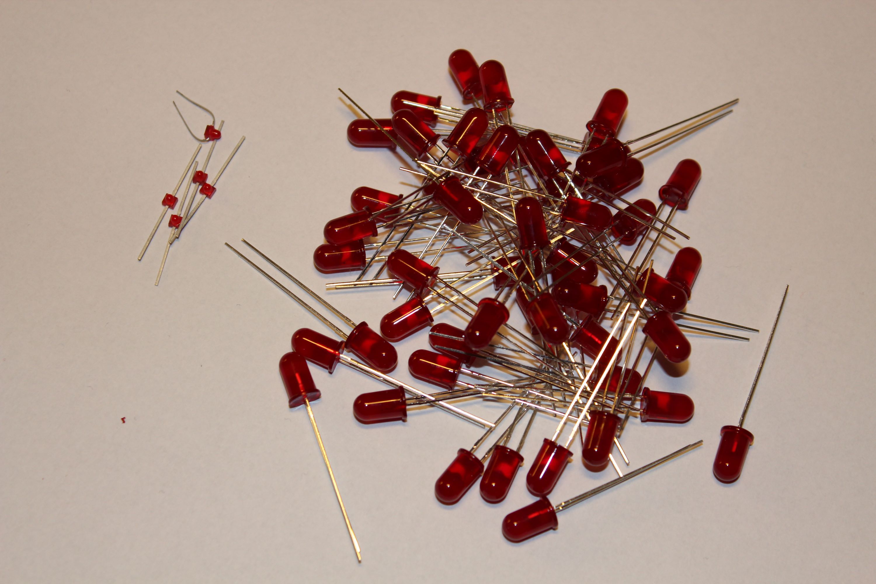

SY could you confirm I am using the right LEDs? I ordered some 630-hlmp-6000 but they are very small
Its easy to get fooled by size and looks regarding LEDs. Heres some tiny HLMP-6300, max current 50 mAand nominal 10 mA and a big gang of HLMP-D150 with 30 mA as max current nominal 1 mA.
Sorry, JZ, I didn't see this post before. Yes, the 6000s are tiny, yes, they work perfectly for this.
So Stuart, I dont remember if I have read or asked before but why did you stick with red models when putting them in series? Like the colour? All others have larger drop and you might getaway with fewer?
/Staffan
/Staffan
SY thanks for letting me know, I put the project on the shelf but plan on getting back to it at some point.
Reds have the lowest AC impedance per volt of drop.
