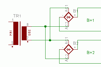

SY, Thank you for you explanation about power supply.
But my friend (who also has plan to build this amp too) doesn't have second power transformer for the driver and his plan is put 2 bridge diodes for generating power supply. One for B+1 and Screen Grid and the other for driver.
Is that okay or it will any detrimental effect on the amp?
rgds
Ferry
Well, remember that you're going to want 350V or a bit more for the driver, but 320V or a bit less for the output stage. That's tough with one transformer. You also sacrifice (potentially) some stability unless you use another regulator for the driver. And at that point, it's cheaper and easier to bite the bullet and buy a small 270V/20mA (or more) transformer.
It is possible to use one transformer feeding two rectifiers. One rectifier operates into a capacitor input filter and gives 350 V. The other rectifier operates into a choke input filter and can be tweaked to give 320 volts.
A very similar scenario, with one transformer and two rectifiers again. the rectifier that feeds the power amp is a tube rectifier with 30 volts loss. The rectifier that feeds the driver stage is SS. The cap values can be tweaked to get the desired voltages.
You don't need to regulate B+2. Just the screens.
Tubelab, that is a good approach, though separating the supplies completely means that any sag in the output tubes' B+ under hard drive will not be reflected back to the driver. I think that helps tighten up the bass and definitely banishes any tendency toward motorboating.
