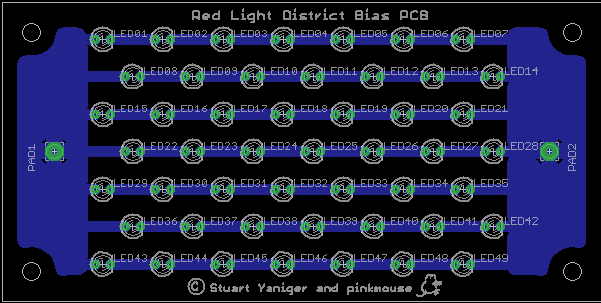

Hmm. The only other thing I've found so far for the RLD is the LED board. I'll keep looking though, I'm sure it's around here somewhere.
Hey Pinkmouse,
When you zoom out the image it grows to about 3 1/8 x 6 1/4. Is that the actual size for the board? Since I'm going to Paint this board to etch it I can just photocopy it. I'm not familiar with the other types of files, except maybe the Acrobat PDF.
Kevin
