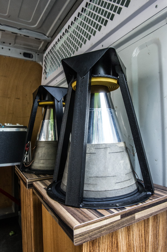

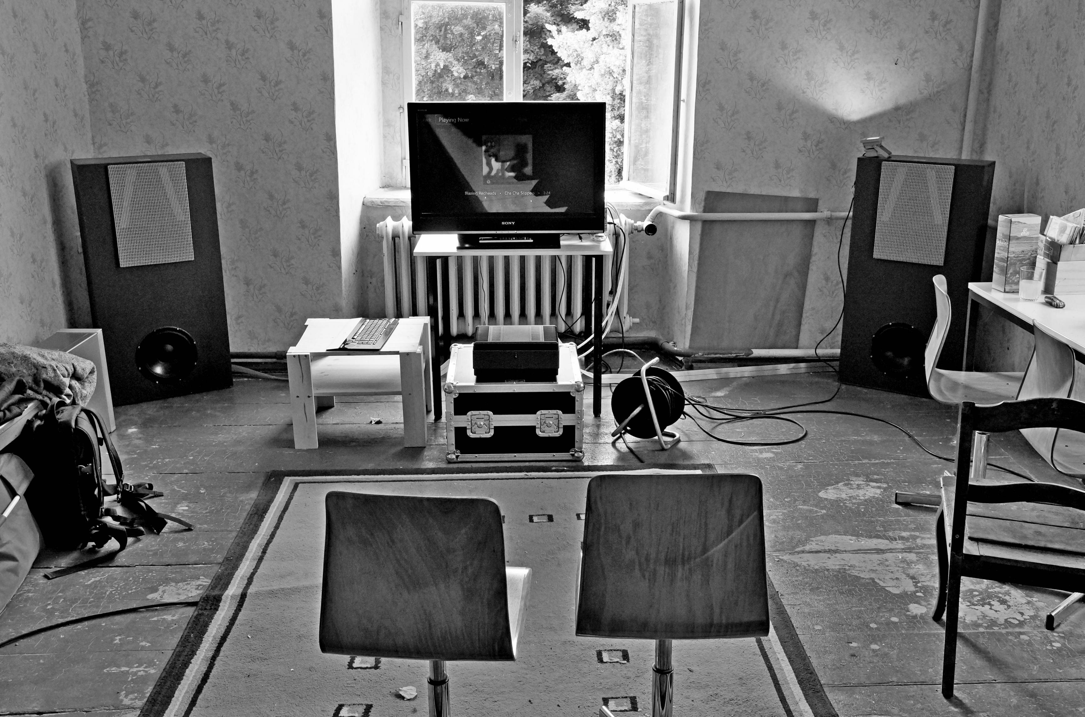

I made an openbaffle with two Neo 10 th an a Mundorf AMT in the middle that works very well.
Unfortunately i can not post the speaker because it is propriatary work for a customer.

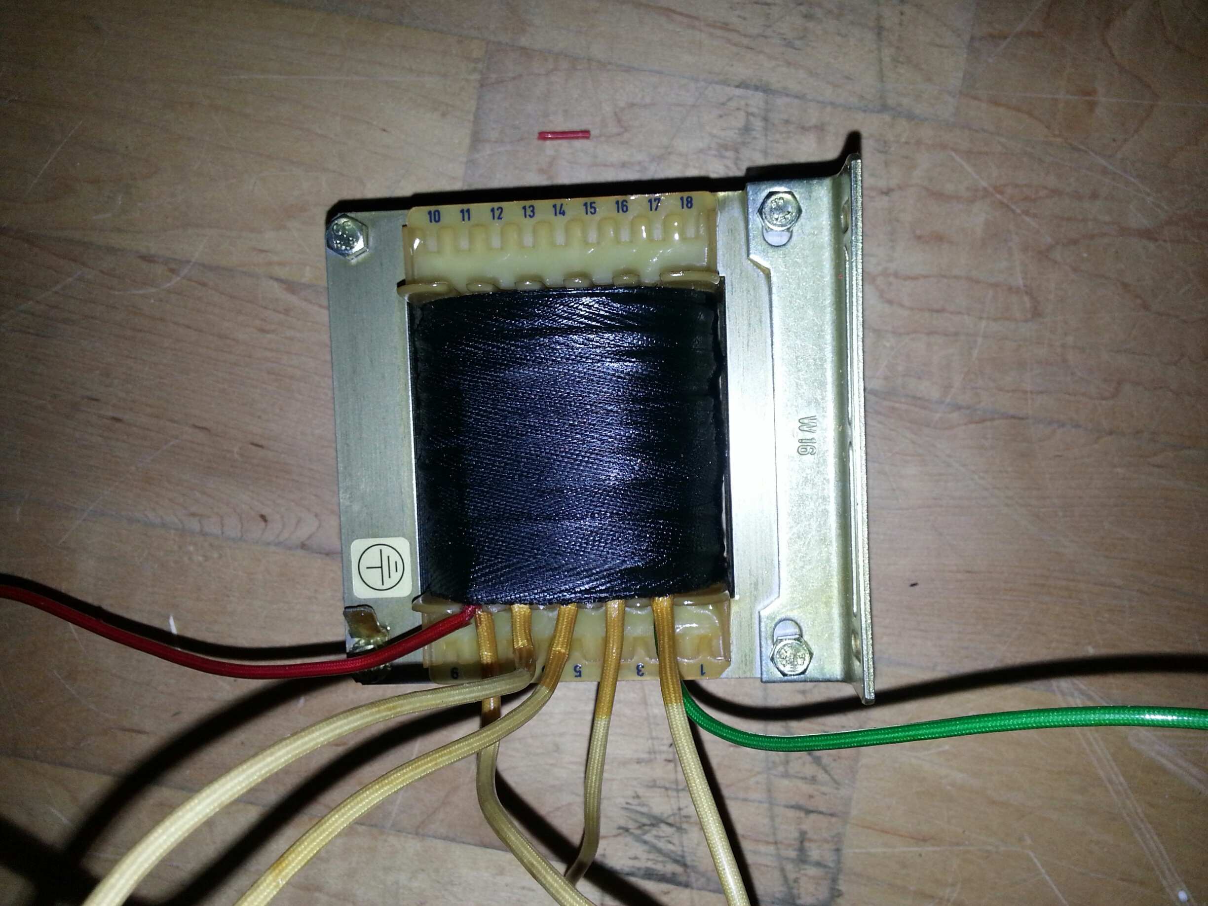

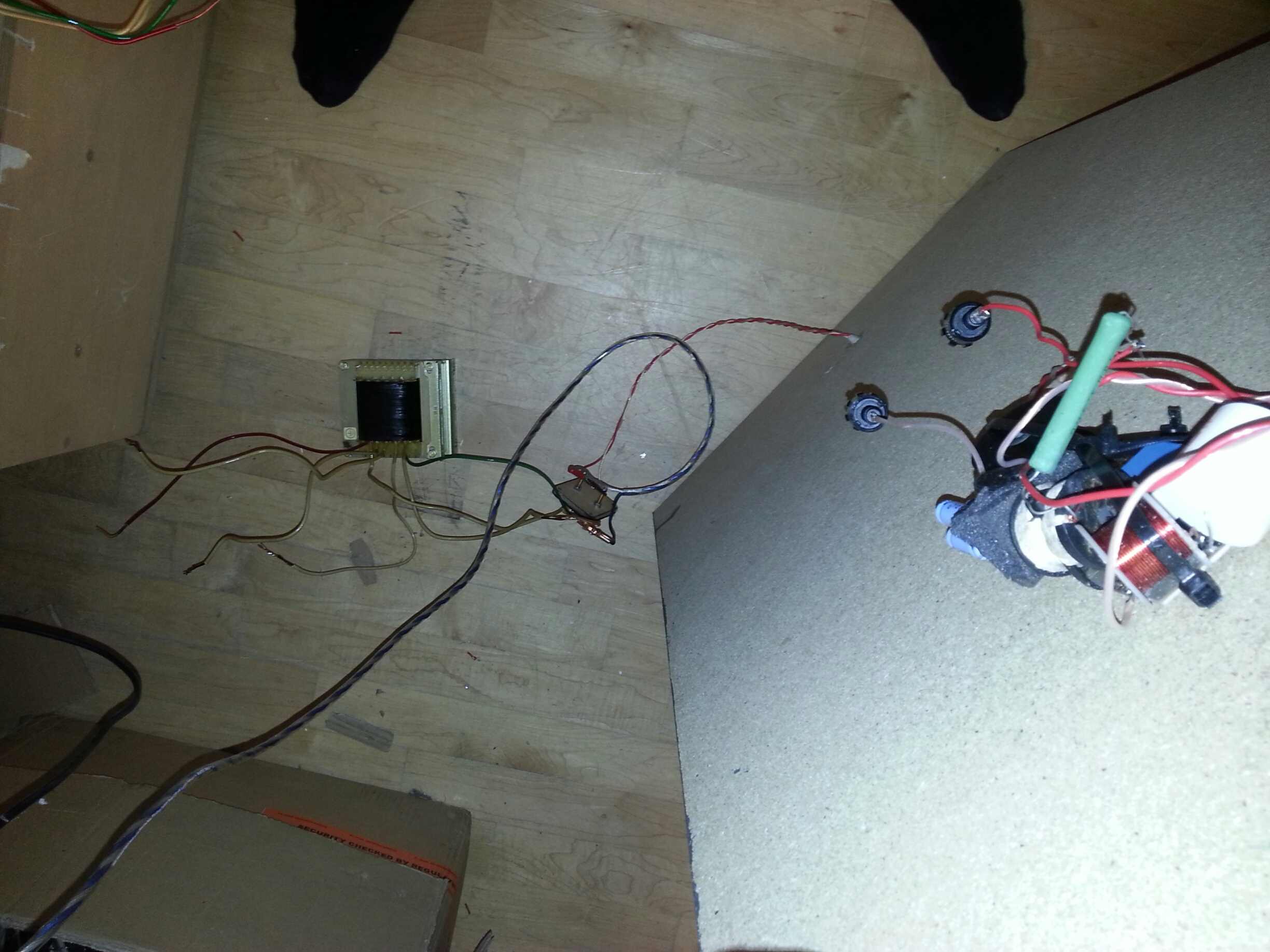

Today i got two Auto Formers.
Using them i can transform the 8 Ohm woofer to 4 Ohm.
That way i get more voltage sensitivity on the woofer ( 3dB )
I hope i can make a passive version of the German Speaker that way.
I can even transform to 2 Ohm for a voltage gain of 6dB but that needs a stable amplifier.
I have now made a passive version that stays over 3 Ohm.
I will order some parts and when it playes like expected i tell you more.

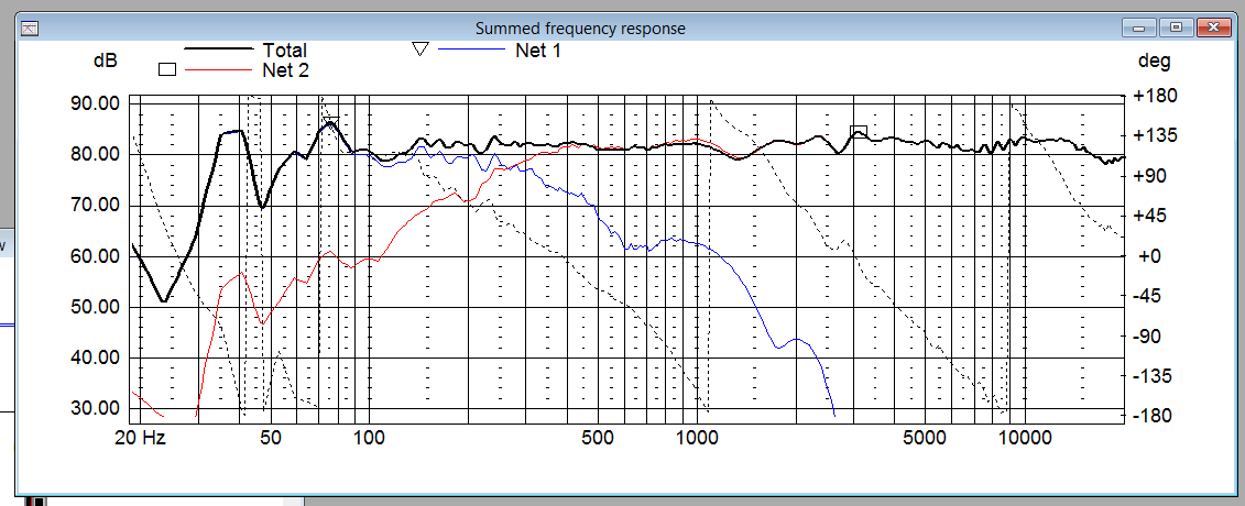

You've really made me think about floor bounce and the Allison Effect. Troels is getting it here at 250Hz with his Poor Man's Strad:
Poor Man'
He's also getting some boom from a reflex curve interacting with room gain, which is something you mentioned before in favour of closed box with near 12dB rolloffs. I do think that 3 ways are really hard. The theory from Steen Duelund seems to say you use 4th order filters throughout, just they look like 2nd order slopes on the wide bandwidth mid. Flat baffle seems to be a game changer though.

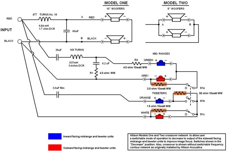

I looked at Roy Allison's lovely IC20 design, and see that he goes for series wired with MTTM. Which makes sense to me with a shared enclosure to avoid the drivers interacting. Also the unique Gaussian mid and tweeter profiles.

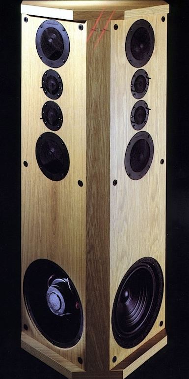

Wow, that Model One has even push-pull woofers for second harmonic cancelation.

Similarly, the problem I see with the Allison design is the secondary arrival from the tweeters on the "far side" of the enclosure ... about a half-millisecond later, at a guess.

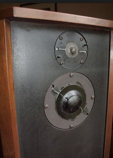

Back when dinosaurs walked the Earth, I used to sell these at Pacific Stereo in Los Angeles. The imaging was very poor, but on the positive side, the 2.25" Peerless cone tweeters were very sweet sounding, not harsh like majority of dome tweeters in the early Seventies. A single Peerless cone tweeter didn't have enough power-handling (unless it was crossed very high at 5 kHz), but if you used them in groups (of at least two), there was no problem with overload.
The Peerless cone tweeters were the sweetest tweeters you could get until the first Scan-Speak silk-dome tweeters came out. With the exception of RTR and JansZen electrostats, the other tweeters of the day had much rougher responses, and didn't "play well" with early transistor amplifiers. Back then, the Phase Linear 700 and Crown DC300 were considered advanced designs, and they certainly ate their share of tweeters.
Speakers with good imaging were very rare. Only the most sophisticated British speakers were manufactured in mirror-imaged pairs, diffraction control was unknown, and American crossovers were primitive (typically only a level control and a series-cap for the tweeter).
Sorry to break any illusions, but I also sold the AR LST (predecessor to the Allison), and the imaging was noticeably more diffuse and vague than the Advent, which was half the price. We didn't sell very many of them, to be honest. Maybe one pair during the year I was there.
The ones that flew out the door were the JBL L100's, the Advents, and a fair number of Bose 901's (first edition). Although we knock 901's today for diffuse imaging, the imaging on most bookshelf speakers, with asymmetric tweeter locations that were not mirror-imaged, was just as bad, and the 901's also sounded a lot more spacious than the competitors. One of the demonstrations we did for our customers was aim a pair of Advents right at each other, space them from the rear wall at the Bose-recommended distance of 20~24", and A/B compare them to the 901's. They sounded more alike than you might expect.
Memory may not serve well, but I think the best-imaging (American) speakers of the day were the Ohm series of speakers with the famous Walsh tweeter.
