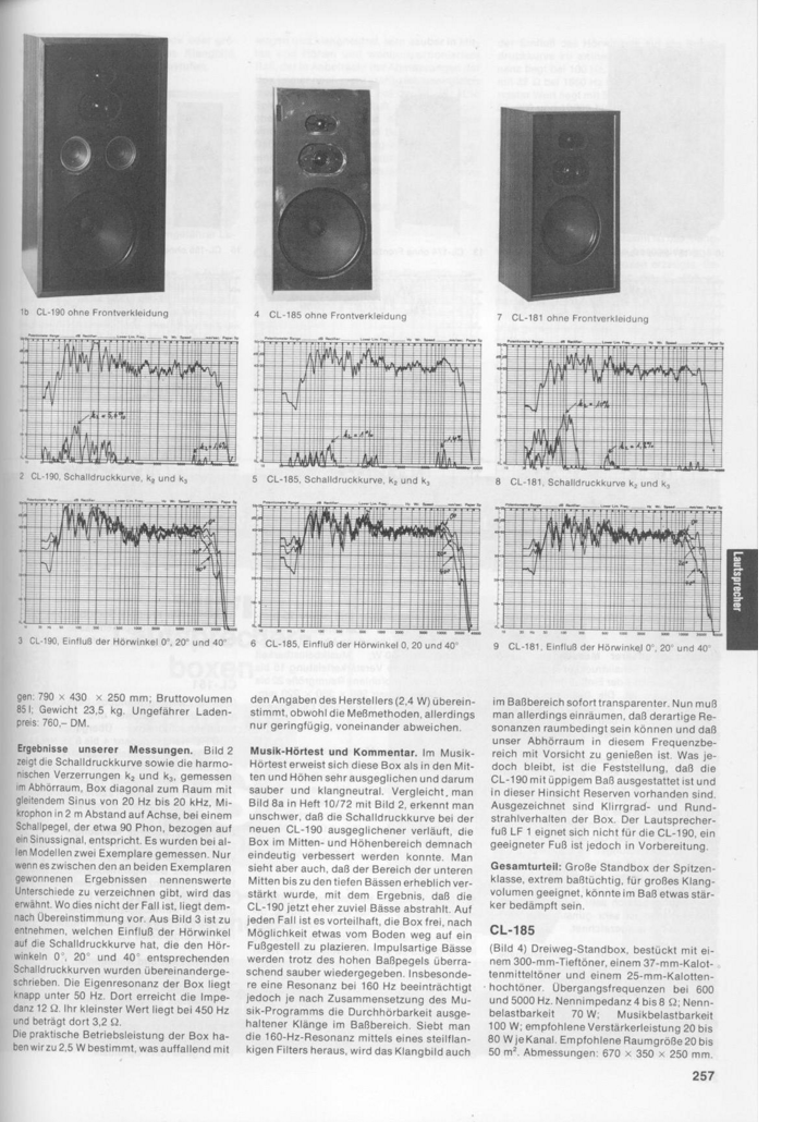

Here are measurements from 1975.
I do not know from what distance and on what axis they measured.
I am quite sure it was done in an anechohic chamber but i do not swear on it.
The response is a bit ragged but ok i think but there is a tilt from the bass to the treble.
The samples i heard sure sounded quite heavy compared to modern standarts.
Not bright as many speakers do today and it was fun if not accurate in any way.
I could also not make the right speaker measure the same then the left speaker so yes, tolerances where higher.
The BBC inspired british speakers where better in the 70th concerning pair matching, that is known.
Now i see it. They measured in 2m in the listening room.
They even mentioned that the bass is too heavy in the CL190.
There is a peculiar resonance at 160Hz, maybe the room, maybe not.
Reading further into the text reveals that they EQed the 160Hz Peak out and that cleaned up the sound.
That was the time of the Graphic Equalizer and then came Mark Levinson......

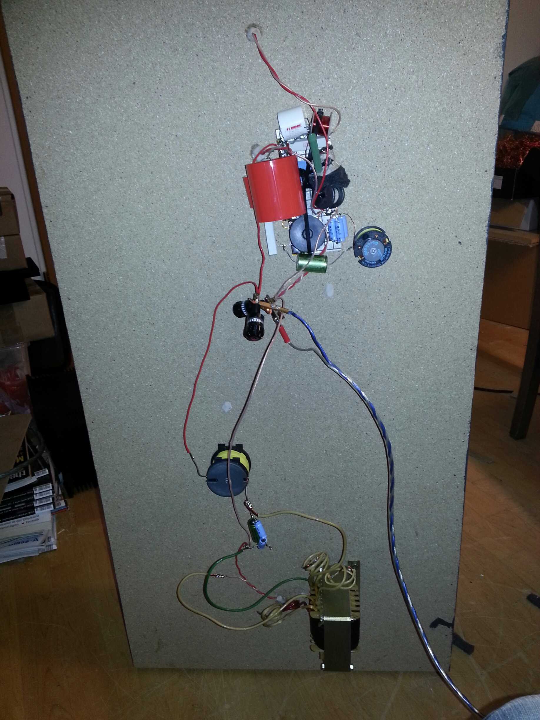

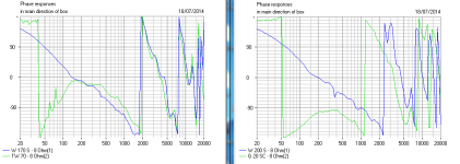

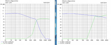

I build and measured the passive version. All looks good.
I put it now in my system.
When i like the result i will post a full schematic.
I have put the speakers now in my system.
I use my tube system at the monent.
I listened to vinyl on my Spriral Groove SG1 with Lyra Atlas.
The phono stage is tube. I designed it. It even does not have an input transformer.
I use selected 6C45Pi at the input and one one pair in 8 that was suprising quiet.
My Power amp is a modified LA Audio from 20years ago.
At the input there is an ECC803S, then ECC802S and a pair of KT120 in triode mode.
I use 60mA idle.
The speaker cable is a big Wire World Platinum Eclipse.
First the sound was a bit overblown but after i had put some BFly dampers under the speakers balance was fine.
I think the bass is in good proportion. My lab measurements do not show this but it is likely that the bass in the listening room is more pronounced then my nearfiled lab measurements show.

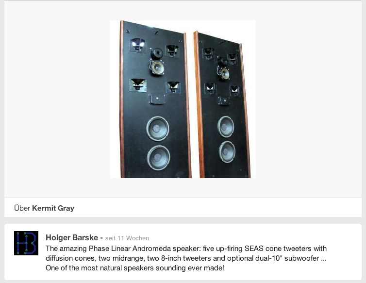

This is another speaker of the 70th with multiple tweeters, this time firing up.
It is the Phase Linear Andromeda.

Here is some more information about the Andromeda :Phase Linear Andromeda Speakers

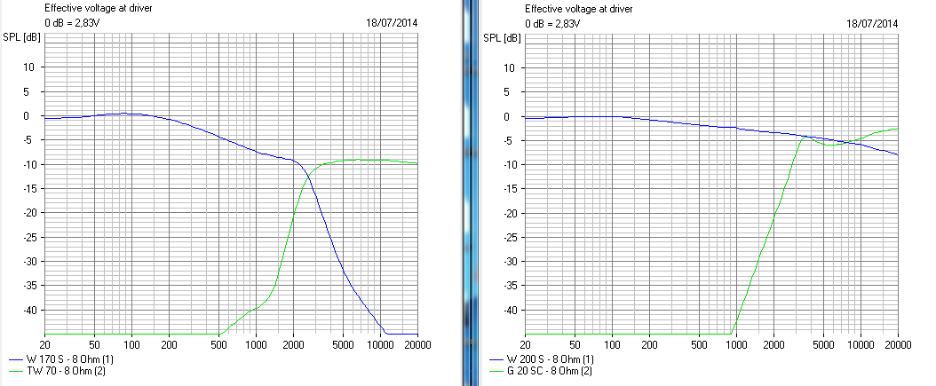

Very pleased you do help out here. Here's a piece I did some time back:
I'm always impressed by the best old designs. Celestion had Steen Duelund's 4th order 3-way theory almost exactly right. The "British Sound", like KEF, was constant power 18dB/octave BW3 and the BBC tilt in 2-ways really.
SEAS, interestingly, made 12dB/octave LR2 work nicely in a 3-way, though I wouldn't fancy LR2 in a 2-way: SEAS Kit 503
We are very obsessed with parallel 24dB/octave LR4 2-ways these days, but I find series filters the natural stomping ground of odd-order filters and 9dB/octave and 15dB/octave. Why do odd order filters sound so good in two ways? And why does doubling up the mid drivers seem to be such a good thing in three ways? 😕

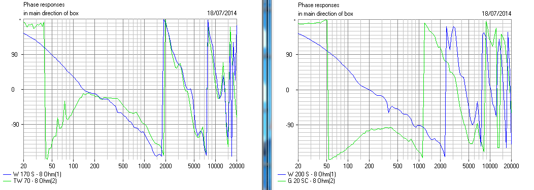

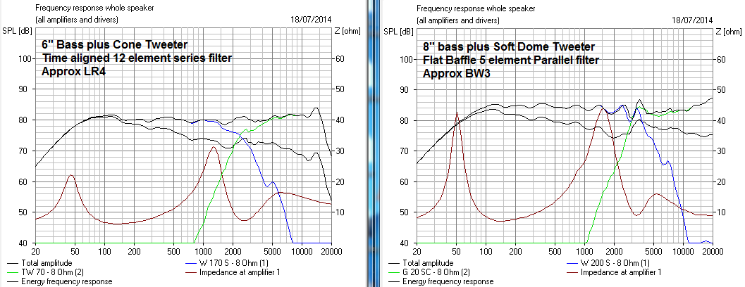

I am not a fan of series filters, sorry.
Problem is that a shelf in the tweeter response ( in a two way ) screws up the phase response.
At Sonics i made a very successful 2 way, the Argenta.
It had 5 elements in the crossover and measured very flat, also off axis.
I then made a resies filter THAT HAD THE EXACT PHASE AND FREQUENCY RESPONSE and ended up with 11 passive components i think.

Why does a speaker like the one i present here sound good ?
First the closed box woofer. It is more tight and clean then a reflex.
Having it close to the floor gives 6dB gain so the theoretical advantage of a reflex to have some more output capability in the upper bass does not look so atractive any more when the woofer is further away from the floor.
The two 13cm midranges have the same area then say one 18cm midrange but have a much better relation from moving mass to magnet strength so they are faster.
The smaler membran is stiffer and breaks up higher.
The two tweeters alow a lower crossover from the bigger tweeter to the midranges.
That gives a better off axis response and where the ear is most sensitive, say from 1.5Khz to 5kHz the mooving mass is only 0.4 Gramms.
Even a very light coned 17cm crossed at 4kHz in the midrange like the english do ( not always ) has 10 Gramms minimum.
That is 25 times less giving tremedoes resolution and dispersion-
The double tweeters give less doppler and intermodulation distortion so does the 4 way contruction over the whole range.
The challenge then is to make a crossover that blends well.

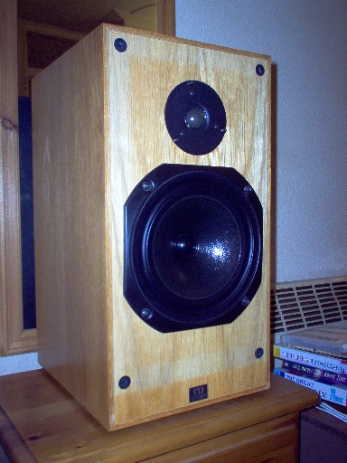

I think the best English speaker ever was the Wharfedale E70:
English BBC polycones are kinda unexciting IMO, and we shouldn't think that anyone except the splendid Harbeth and Spendor even takes them too seriously any more. But I like the BW3 stuff, just like in your time aligned Anima speaker, which deserves a picture for folks who don't know it:
Lovely. I was inspired by that design. And I think you're onto something with doubled mids here. 🙂

A guy like you doesn't make bad speakers, though I think your ceramic tiles on one model might have been "an interesting failure." Your Argenta doubtless works because you are using very good and well-behaved quality drive units as usual. But admit it, cost aside, you could do a better LR4 speaker with more components, perhaps a newish SEAS U18RNX/P and one of your sloped boxes! 😛
The time aligned LR4 target response is quite simple:
And Steen Duelund laid down the typical time aligned 3 way LR4 response for all time, IMO:
But LR4 is just one of the filter theories, there is BW3 and LR2 as well. Then there are pistonic dispersion metal drivers, and gaussian dispersion plastic ones. And stuff in between like ring radiators, which all seems interrelated since they are mechanical filters and apertures. I'm sure Prof. Leonard Susskind could sort it all out PDQ for us if he joined Diyaudio.
But endlessly fascinating. Which is why we do it. Looking forward to seeing the filter here. 🙂
To give something back, below is some modelling of a series filter which I haven't built yet, and a parallel filter which I have. The parallel filter owes a lot to your ideas, and it sounds sweet! Isn't it weird how the dip in impedance corresponds to the crossover point with both designs? 😎
