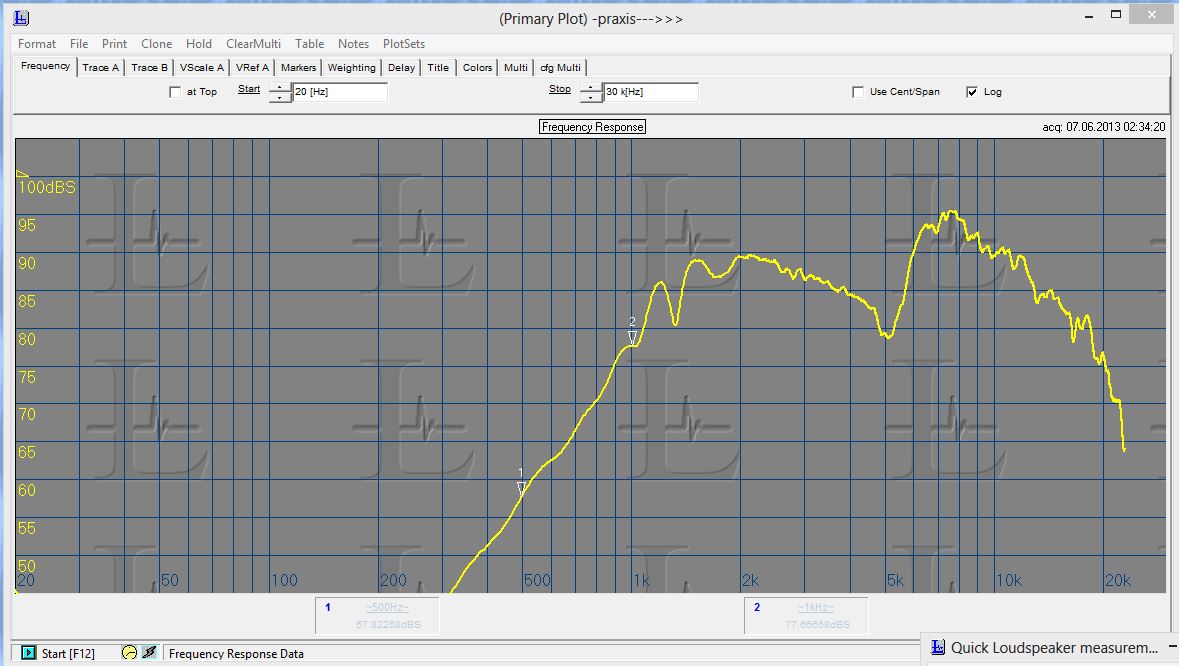

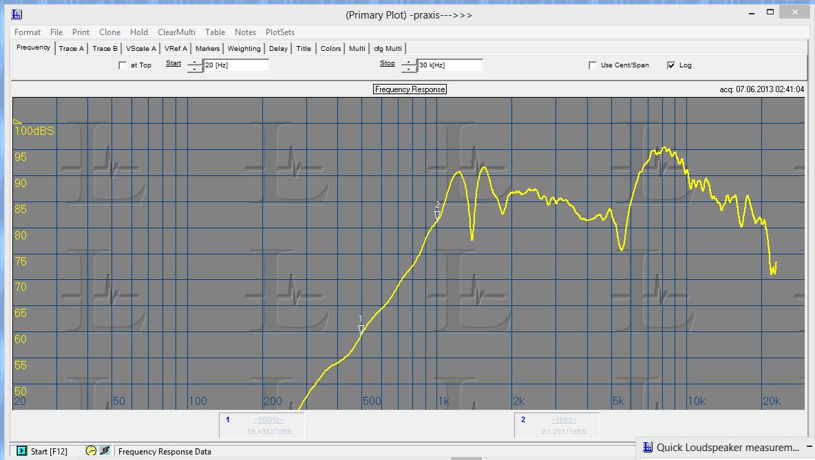

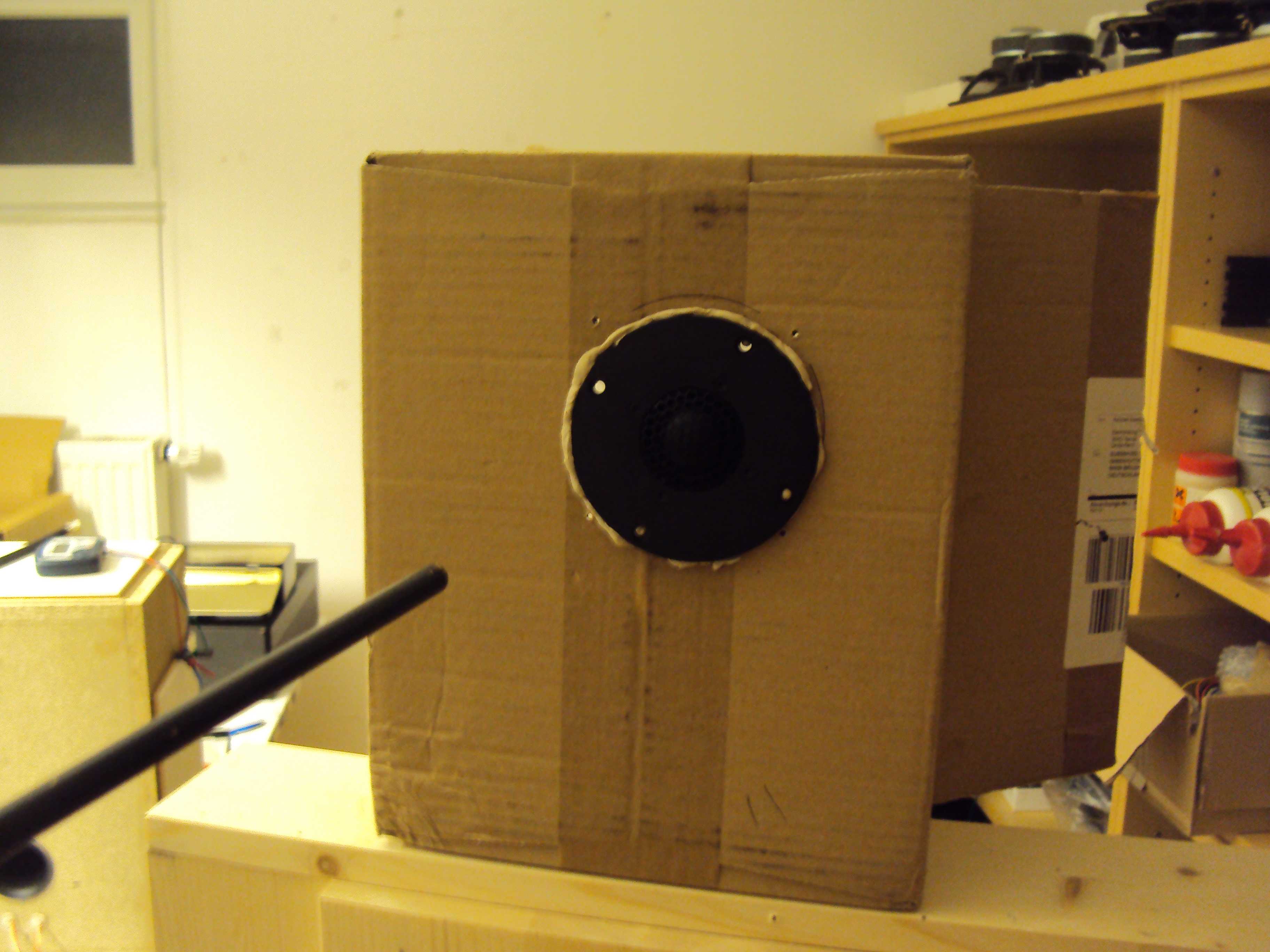

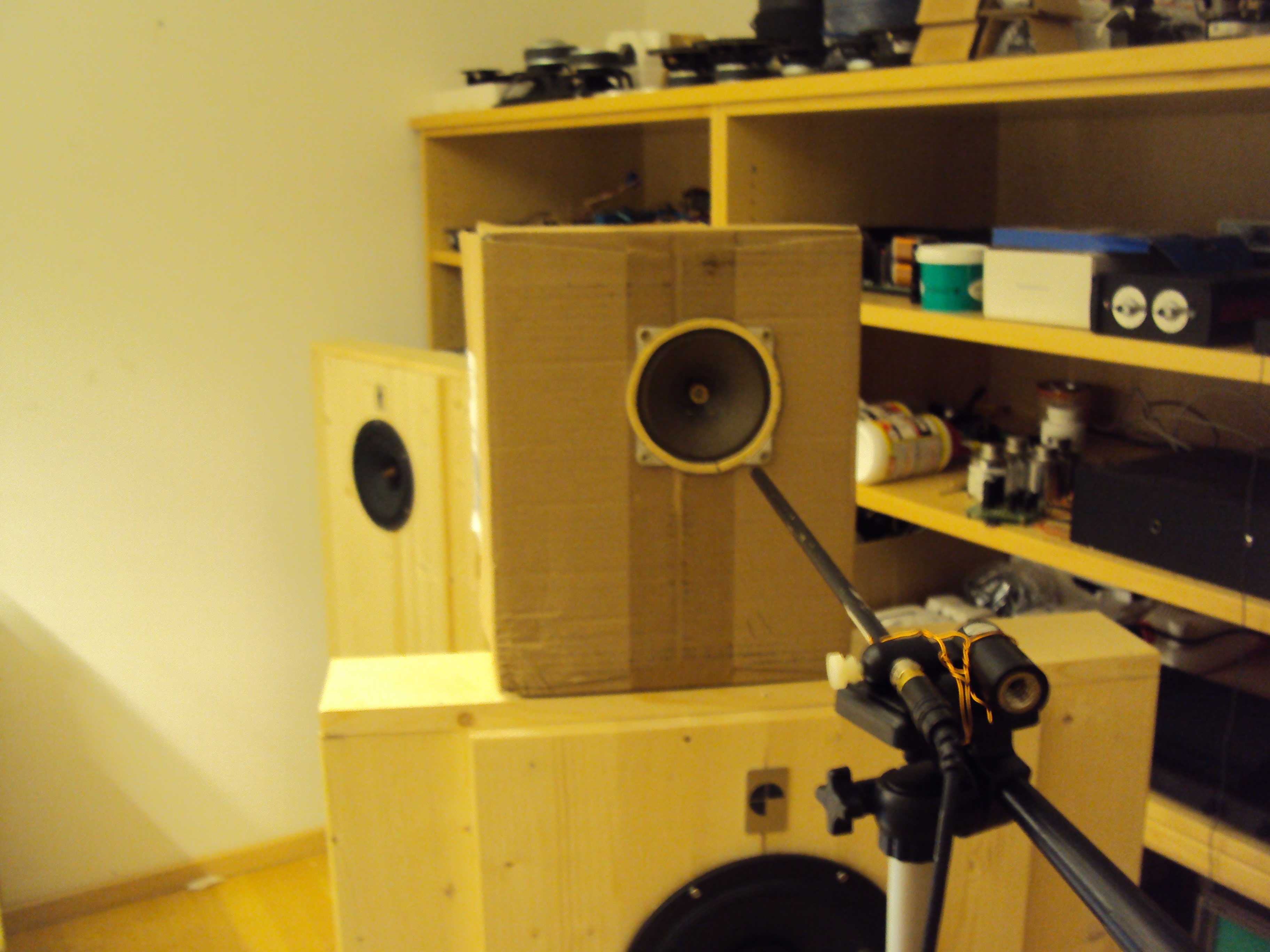

Here are the maesurements. The cone tweeters are not very linear and the matching is poor, the second measurement shows. That may be due to age, they have 50 years on their sholders. There is a lot of energy around 10kHz so they sure will sound brilliant.

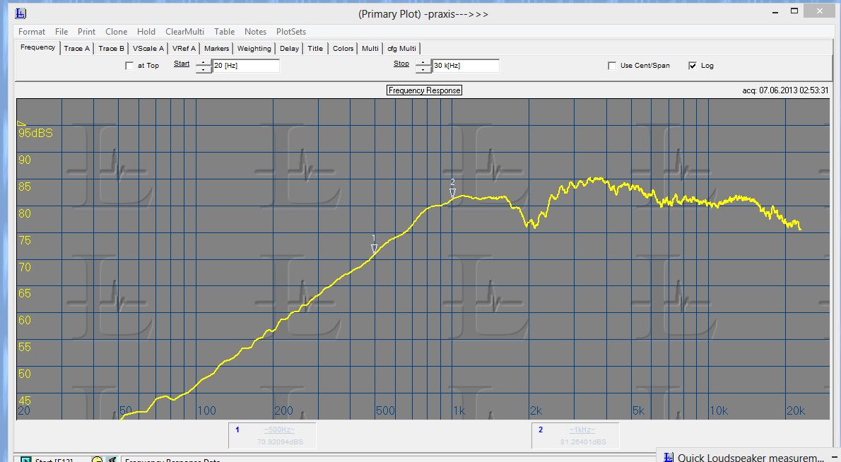

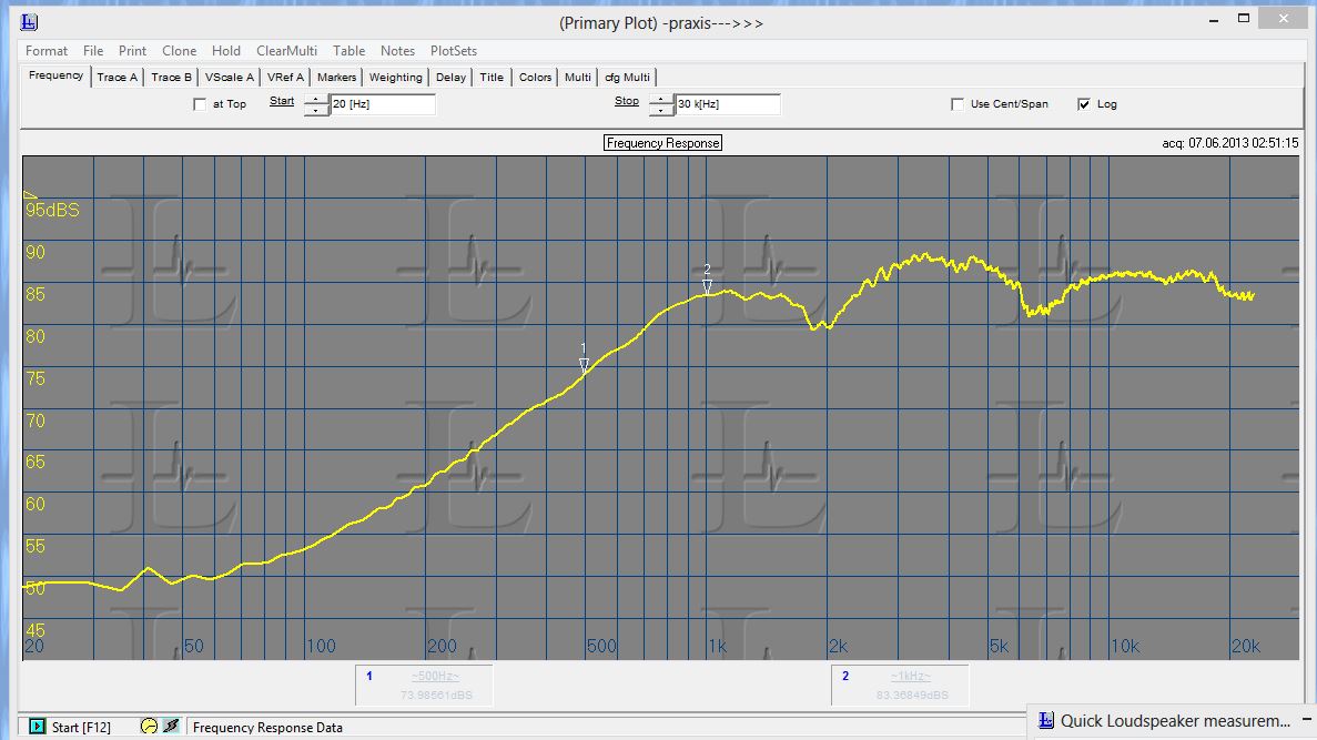

The SEAS soft dome is 6dB less sensitive on axis. That is not immediately obvious but it has 5 Ohm DC impedance and the cones have 10 Ohm.
The SEAS has of cause a wider radiation pattern and much more energy in the deeper regions. The cones drop of drastically at lower frequencies so the total radiated energy in both tweeter types is not extremely different.
The cones will sound more penetrating though.

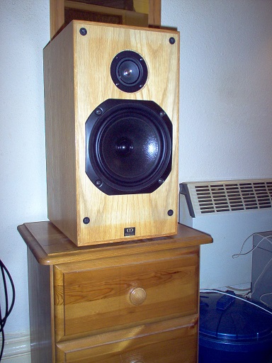

I've been using a Monacor HT22-8 cone 92mm cone tweeter in one system shown below lately, Joachim. It is incredibly smooth and mellow sounding. And the price is right! It's VERY cheap. 😀
Needs a third order crossover around 3kHz, IMO.
