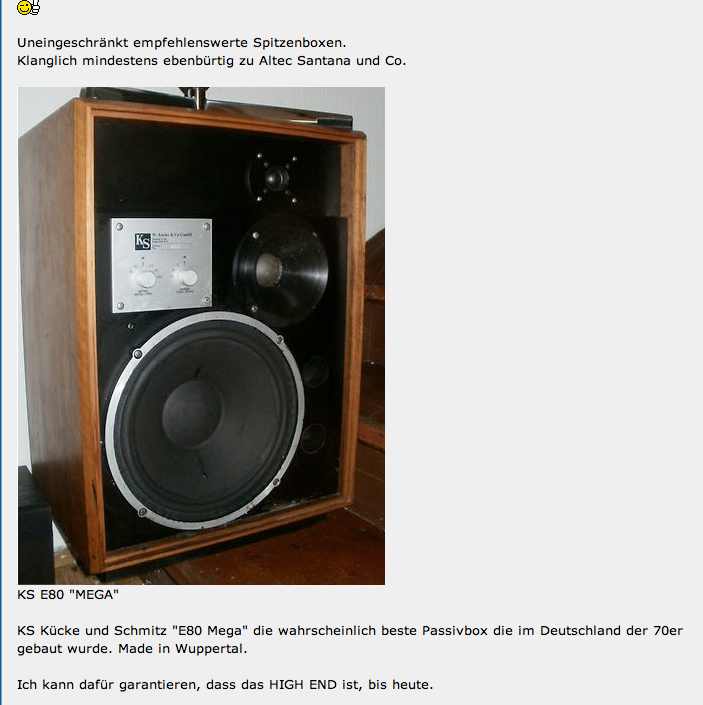

Whereas british speakers of the 70th where mostly reflex in germany only one company made reflex boxes in the 70th ( more to the end ), that was Kücke.
When this speakers came out we first thought that closed is history, and so it goes....
Here is the KS E80 "Mega"

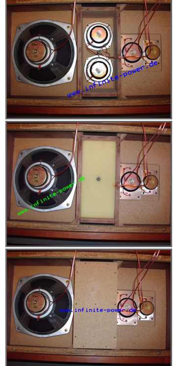

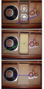

I hope your interpretation of Dual will not be amp killer! No need to use two woofers. I think your first idea will be just fine: 1 woofer, 1 midrange (with it's own compartment), 1 tweeter + big closed box.
I think i can design crossovers that do not tax the amp to much.
Yes, i will go the easy way :
One 25cm woofer in a closed box, one 13cm in a closed box and one 25mm soft dome.
