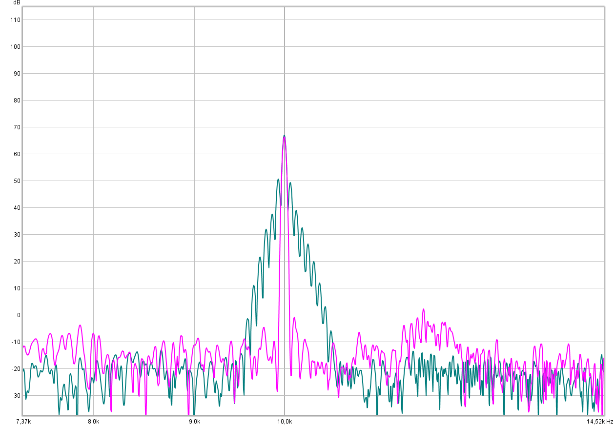

One test can be seen at
it is in russian language but images and sound are self explaining.
Here are my measurements of fullrange, green line is 10 kHz+70Hz signal both about 0.5 W, purple only 10 kHz.
Any 5" brand and model you would recommend?I should have made clear that was I talking in the context of largeish pro coaxes. With smaller 5” like the Sicas I’ve worked with it’s another ball of wax.
@carlmart Sorry but no.
@kaameelis If you’re going to refute my source I’m afraid you’re going to have to do better than a russian youtube clip and a graph.
As does mine.My practical experience with fullrange speakers shows opposite.
Couldn't find it when I tried. 12" Tannoy Gold, ~2.5 kHz on the tweeter and ~30 Hz on the woofer. Maybe 3/4" peak-peak excursion. Absolutely no change down to the noise floor in the tweeter's harmonic distortion profile with the woofer driven or not. I was tensioning the tweeter diaphragm screws for minimum THD and got into the 0.15% range so it should have been pretty sensitive. Granted, it was on-axis only.The bass driver movement modulating the HF dispersion is not really "Doppler distortion", but is very real and should be easily demonstrated with a large subsonic signal
If you look at green line in my measuremet, it has similar shape as digital signal jitter, only 70 dB or more higher than worst device jitter@kaameelis If you’re going to refute my source I’m afraid you’re going to have to do better than a russian youtube clip and a graph.
