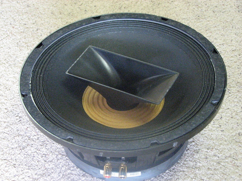

I've enjoyed some of Eminence's cast frame 12cx and 15cx but not seen them for sale in a long time. Many had a horn pretty much like the front horn from the ancient Electro-Voice CDP ("Compound Diffraction Projector", and magnet slug ranging from 54/56oz to 109oz. I liked the 80oz magnet 12cx with 2.5" coil, but the 12cx with 4" coil and 109oz slug magnet is decent.
An LC-LC allpass on the woofer seemed to help things congeal.
I've heard "gargle" from a Beta15cx with sustained bass with flute. DJK (R.I.P.) indicated that coax were more prone to it than having the tweeter element offset - so a K-tube 2-way Karlson coupler might sound a bit cleaner than a CX. (case dependant - 604 are pretty good)
This is a 109oz magnet 12cx with 4" coil and 4.6mm overhang. It sounded pretty good with Fritz Wunderlich singing lieder in a Karlson 12.
I had Beta10cx - dismally bland and opaque with EM's 2K5 network - maybe Mike Chua got it right with his Osprey xover.
BTW - on CX with a secondary spider/dust cover, its helpful to have a felt or foam damping ring over that piece as it emits nasty HF junk which interferes with what we want from a speaker.
