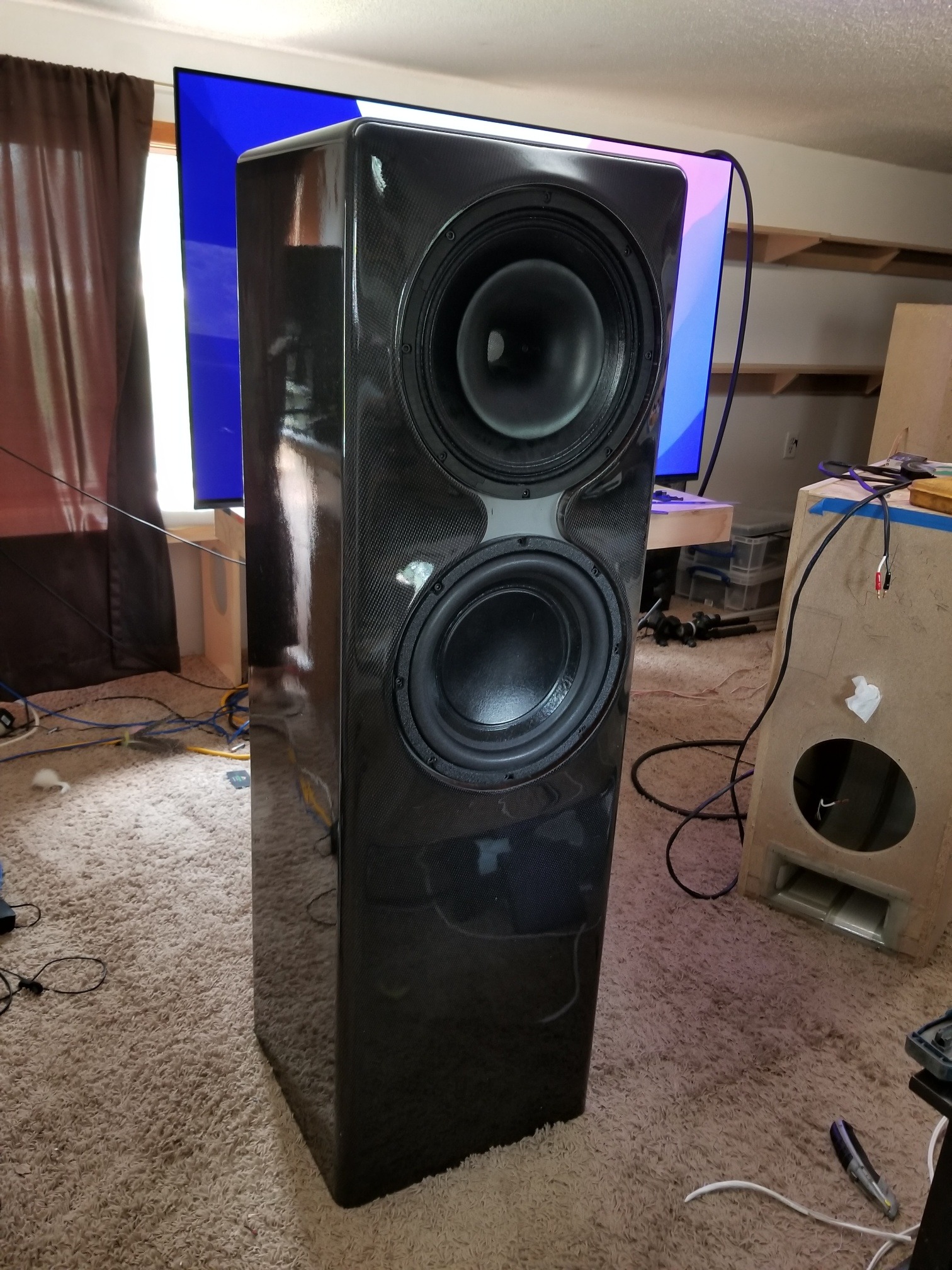

I feel somewhat obligated to chime in. I'm using B&C 12FHX76 coaxial drivers in my build. The sound is pretty detailed, and they measure pretty well.
Their directivity is well controlled, as in there is a wide horizontal and vertical sweet spot. But still a fairly narrow directivity 60 degrees x 40 degrees.
At this moment it is crossed at 1,200hz and 100hz, but I'm working on an overly complicated plan that will allow me to cross to the front subwoofer @300hz, while maintaining a summed signal below 100hz with an independent delay for multi-sub tuning. (Each cabinet has 2 subwoofers, one ported and one sealed...like the Genelec W371A.)
I built one to see if it works as intended. It isn't "done"...but should give you the general idea.
