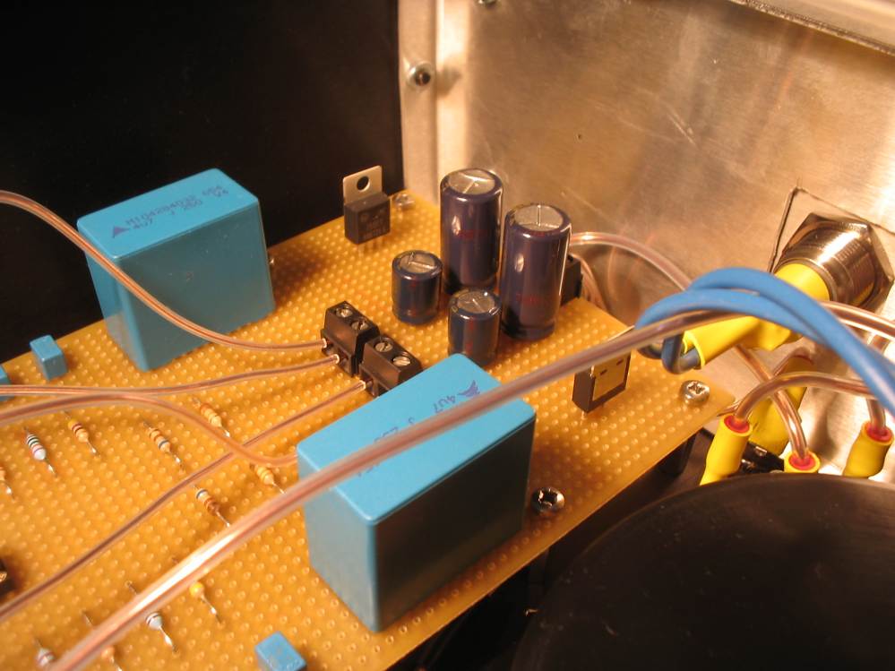

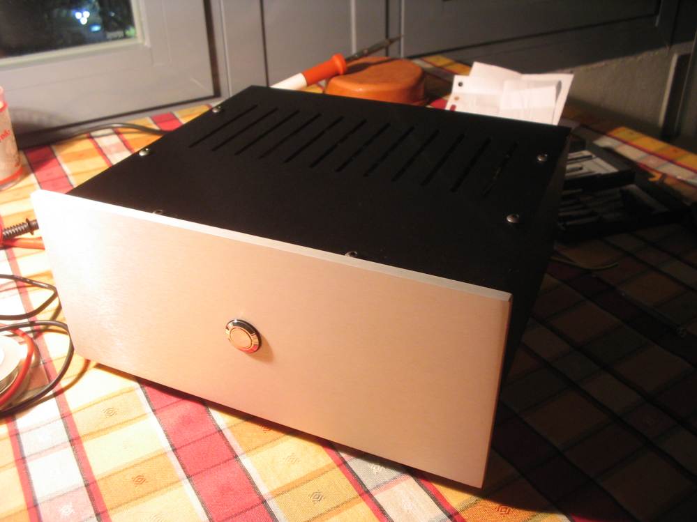

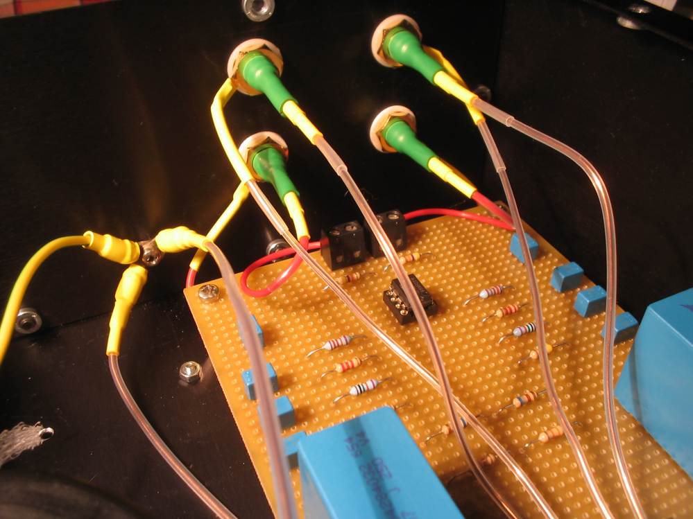

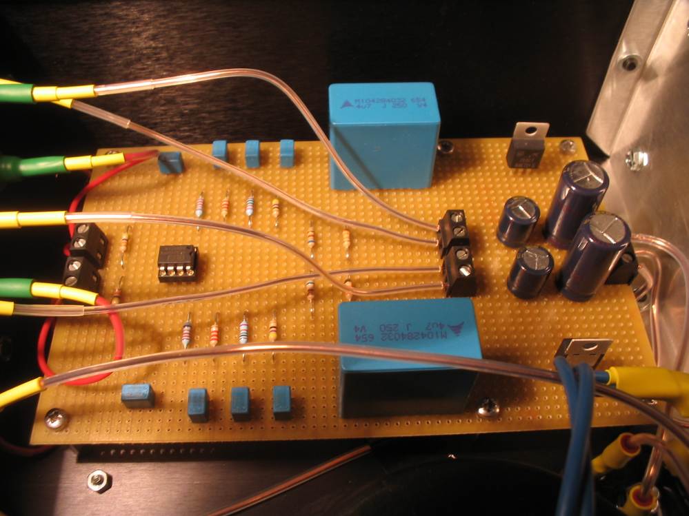

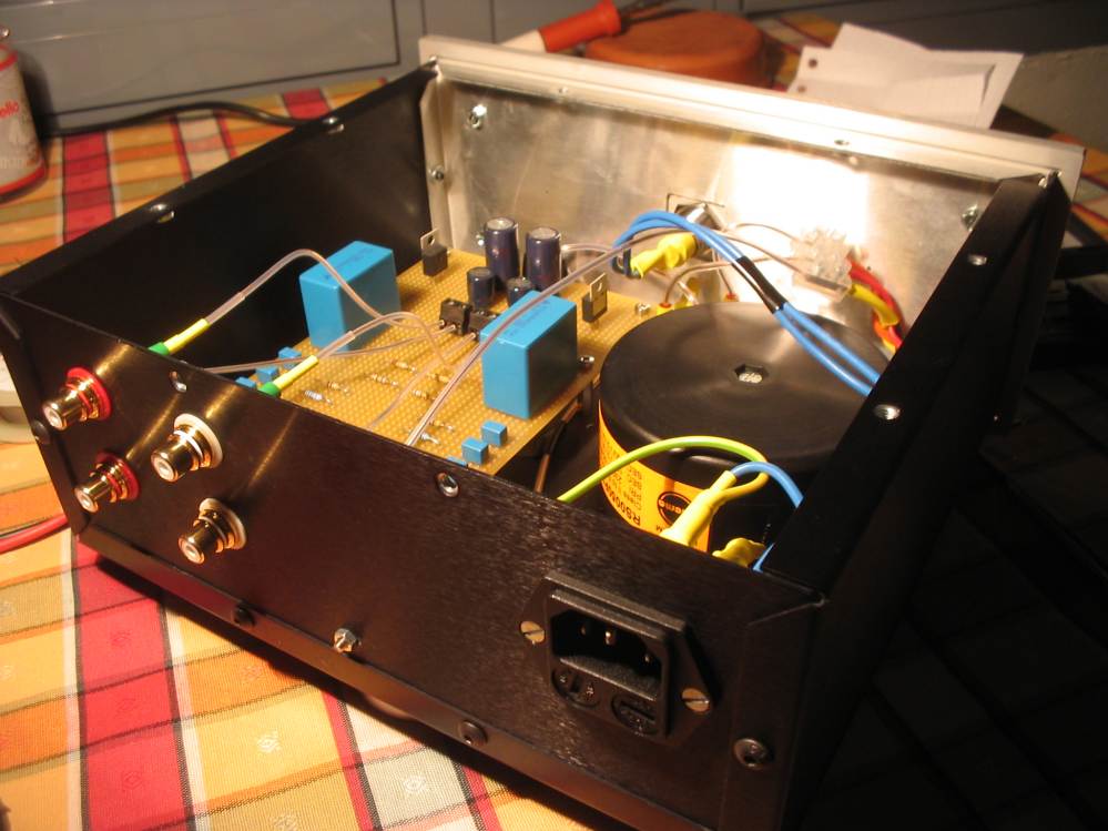

VSPS HISS PROBLEM
I just finished my VSPS. It sounds very good but has a high frequency hiss proportional to the volume that disturbs me. I guess I have a problem with grounding or in a cable. Look at the photos and see if you think of a solution.
Thank you.
Thank you.
