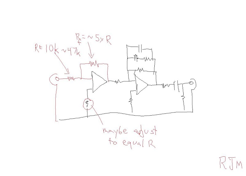

is it possible to use the Phonoclone with this cartridge?
Or with a modification of the Phonoclone maby lower the gain or 1 stage bypased or so ?

The quick answer is "no" of course.
However, if your realy have to: add a series resistor at the input equal to the recommended cartridge load. Adjust the feedback resistor of the first stage as needed.
Even if the nominal recommended load is 47kohms, try to use a smaller value if you can get away with it, 1kohm, 4.7 kohm, or 10 kohm.
Lets say its 47kohm. That goes in series between the cartridge input and the inverting input of the first stage. Total input impedance is 47k + 1k or so from the cart. The feedback resistor will need to be about 220kohms. The gain of teh first stage is then 4x, the second stage about 30x, total is 120x or just over 40 dB.

hello Richard
i will try it tomorrow
i try the 47k and the feedback resistor at 220k
what do you mean with the third resistor adjust to equal?

In principle the inverting and non-inverting impedances should balance, so if 47k added to the inverting side, then R1 should be 47k to match. Likewise it would be advisable to use a unity gain stable FET input opamp instead of the OP27 in the first stage.
But its not necessary, and I assume you are looking for quick and dirty, I need it to work, now! solution.
Its not meant to be a "good" design. From a noise standpoint its a poor design by nature, no matter what you do.
