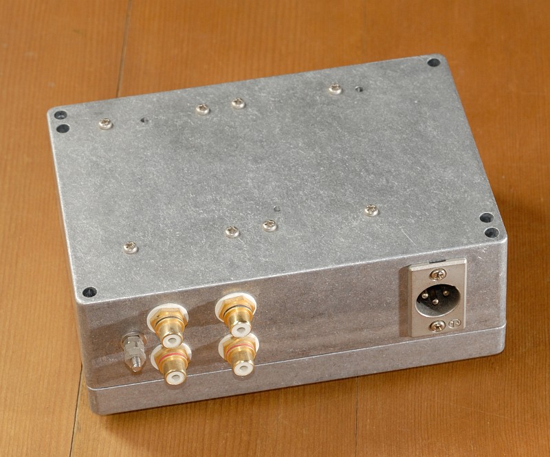

Hello, just ordered phonoclone3 kit and now in process of ordering rest of parts. I use Denon DL-103 cartridge on Rega P5 turntable. As I understand, in gain calculator by default are listed optimum values of resistors R1 40ohms and R2 1.333kohms for above mentioned cartridge. However in BOM R1 is listed as 47,5 ohms and R2 1kohm.
Should I order resistors according to gain calculator or stick with BOM? Cartridge impedance is 40 ohms and output 0,3mV.
Another question is enclosure - I plan to use one chassis for pcb's and psu, isolating pcb's from dual triad 50va transformers by metal shield. Is it ok or it will affect performace a lot?

I will stick with R1 40,2 ohms and R2 1,33 kohms, hopefully it will match my DL-103 perfectly.
Just stick with the kit resistors, they work fine with the dl103.
Single chassis, metal shield should not affect performance vs. external supply.

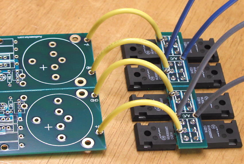

If I want to use the Peter Daniels rectefier bridge,pcb, what do I do about the com?

The rectifier pcb for a split supply should have positive, negative and ground terminals. These connect to V++. V-- and COM, respectively.
Peter' s instructions are clear enough

Rjm: thanks, but the hole in the vsps vises for com is to small to fit two wires...
Can i run one wire between pg+ and pg- and connect one wire to this?
You can solder a standoff into the pad, and solder the two wires to the standoff (standoff: a short length of resistor lead, etc.). Or you can do what I sometimes do: solder in one lead with a little space left between the insulator and the board, wrap the lead of the second wire around the first in the open space, and solder.
