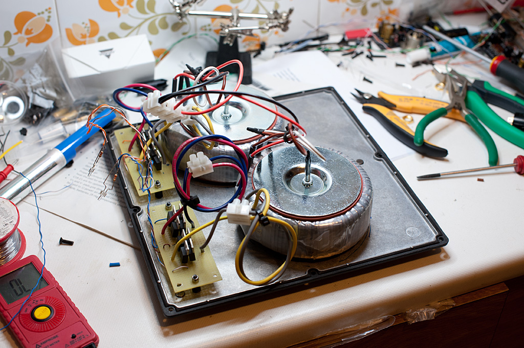

Here is some porn from the new setup.
I finally switched to a 6pin XLR to keep the cables on the back tidy. The cable was custom made by removing the solid core wires from a 3wire power cable I had around, and wrapping it in polyflex tube. Nice, tidy and beautiful. I forgot to take a photo and now I m listening to my new toy, so I ll post one later.
Setup on the PSU remained the same. I changed only the XLR socket. Here it is before soldering the wiring to the socket and closing it.

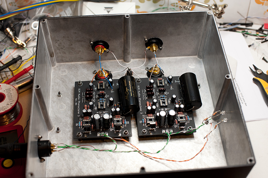

And here is the phonoclone boards on their new home.
attachment.php
The ground cables are soldered on the bottom side of the boards to keep the wiring as clean as possible. If you remember my previous photos, you will notice that the input is still on the top of the case to allow for shorter tonearm cable and keep it away from the power and output ones.
And as stated above, the RCA sockets are insulated, but the - ends go to the ground post instead of to the boards, and meet there with the GND from the boards. Nice and tidy.
Mundorf Supremes were used again for C3.
And if you look closer you will notice that I chose to not use the Nichicons caps. I decided to give the Panasonic FRs a chance.

Thanks for the photos, your latest build looks really nice. I'm a surprised your connection scheme worked, as formally connecting IN- and OUT- at the ground lug means the a short but textbook "ground loop" is created : the output currents are impressed onto the input signal over the length of wire going back to the board.
The phonoclone boards have the IN-, OUT-, GND pads clustered so close together they can be considered interchangeable, but IN- and OUT- should best be kept separate whichever pad you use. That said I doubt you'd be able to hear any difference.
Well my wiring is not elecrically different from you suggested connections. I just moved the IN-/OUT-/GND meeting point from the one side of the GND wire to the other. If there is a ground loop there, it is present anyway.
