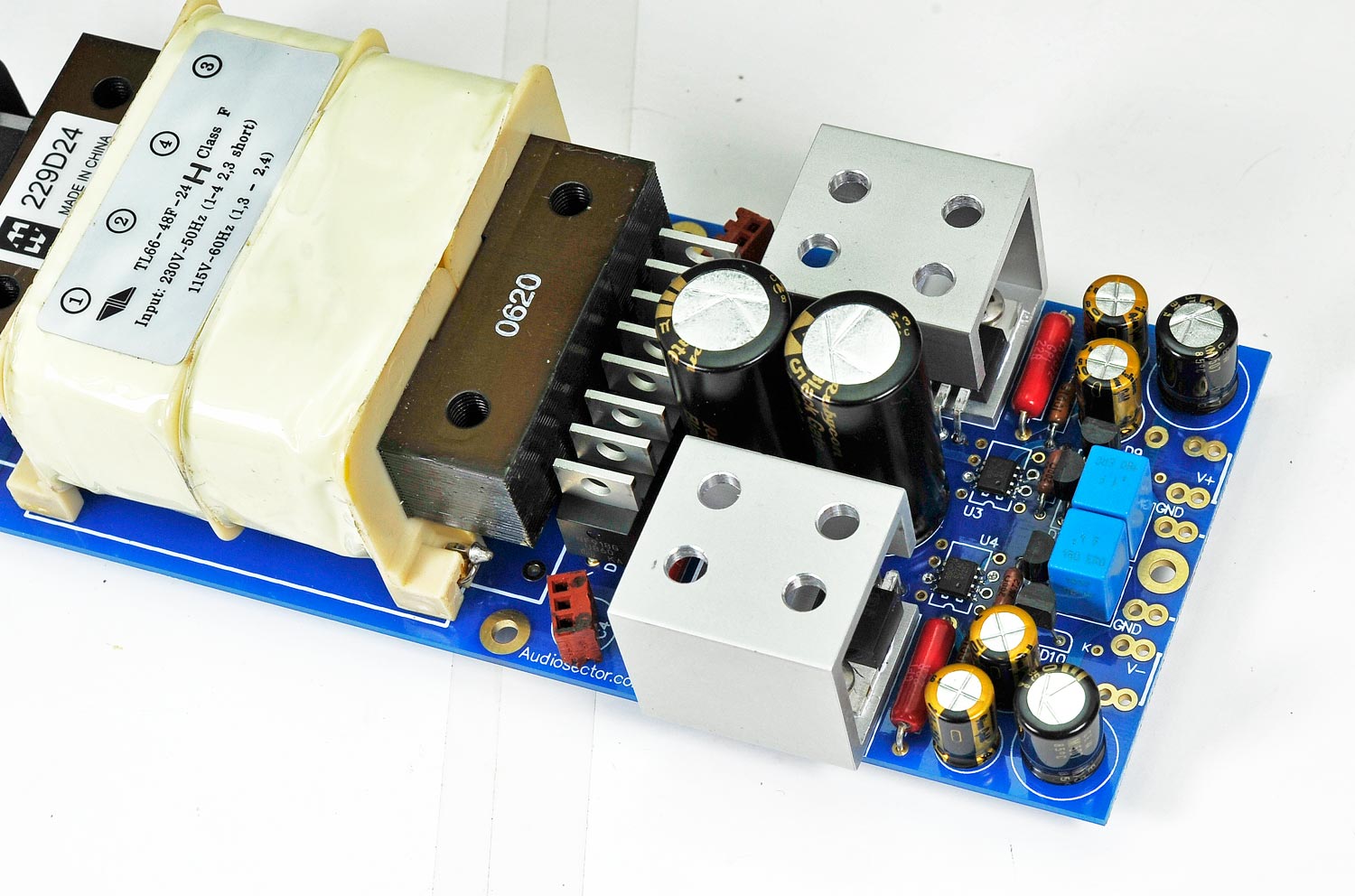

I had a chance today to do some careful comparisons with PS and as suggested earlier, I did remove C3/C4 across current source: the sound become noticeably better without those caps (less coloration). I also removed C5/C6 and further improvement was observed. I tried without C9/C10 as well, but circuit actually sounded better with those caps in place. Nichicon FG was preferred here over BG STD, something I suspected already. BG N 10-47uF could be another good choice, although not that much better than FG.
I also did some testing with constant current regulator types. I really liked the old production ON Semi, National was second, then the new production ON Semi while Linear Technology LT317 was the worst; nice sound but too technical, ON Semi was OTOH much more musical.
Attached is updated PS schematic.

I'll have to follow up with some pics at some point as I have mine all nicely boxed up in one of Peter's integrated/amp enclosures. My hum was virtually all but eliminated by grounding my tonearm to AC/Chassis ground. Now it seems I will be playing around by removing some caps, but at this point I have already replaced my Pearl with Ono MC stage, very happy with the sound out of this phonopre. Thanks Peter!

My main reason for using Hammond 229D24 was convenience: I wanted to keep the phono board in a same format as DACs, I wanted transformer to be pcb mounted and most of all, it all had to fit inside 2x3 aluminum tubing.
I'm pretty sure toroid will work here quite well too.

Another completed
First, very nice work by 04dgmsilv! I use similar RCAs (Vampire PCB2F/S), and your technique of mounting the PCB directly on the jacks never occurred to me - great idea.
My unit is just now running breaking in, but already sounds great.
I used Peter's recommended parts for the power supply, but in the audio circuit I used 1% film and foil polystyrene caps I had on hand, along with PRP resistors. I found some 1" by 2" square aluminum stock for Peter's suggested heatsinks which work out great. They barely get warm.
I measured the frequency response of mine (using the Hagerman inverse RIAA) and its very flat (well within the 0.25db tolerance of the Hagerman) except for the very high end, where mine measured up 1.1db at 20Khz. It could well be a measurement error.
My unit draws 5.3 watts of power when on.
I'm using it with a high outpur moving coil - a Dynavector 10x4, so the gain is a bit low (2.5mv, 270 ohm impedance), but only a bit lower than with the ARC PH-3.
Thanks to Peter for all his work on this project and his help sourcing parts!
