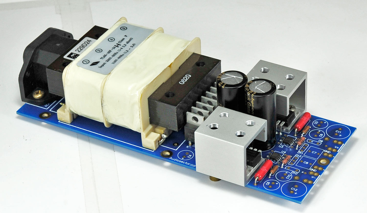

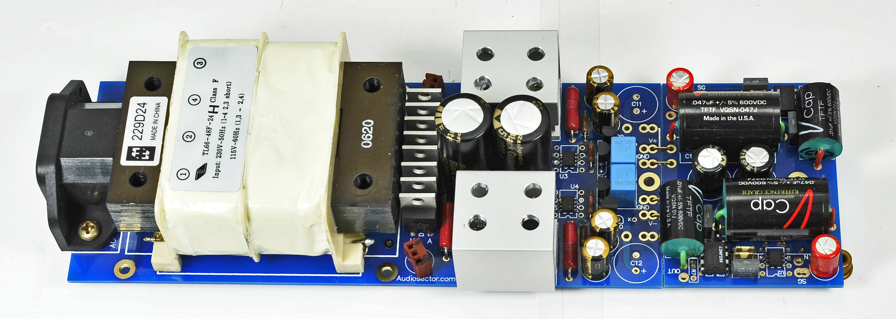

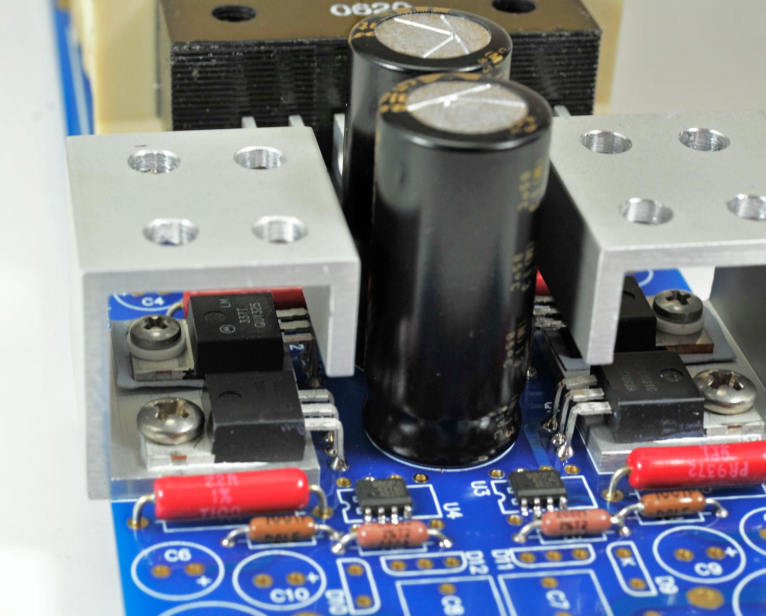

The LM317/337 are running quite cool and don't need much heatsinking; the MJE devices need a lot though.

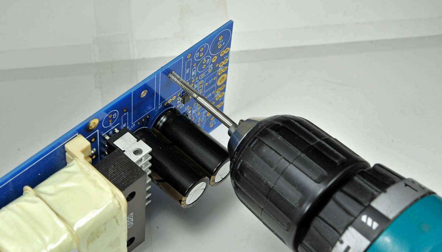

When using 6-40 screws, you can tap through hole plated mounting holes in the board without a need for additional nuts.
While mounting LM317/337 and MJExxx on a same heatsink, at least one of the devices need to be isolated. I used the pad on LM317 and mounted MJE directly, using 4-40 and 6-40 machine screws respectively.

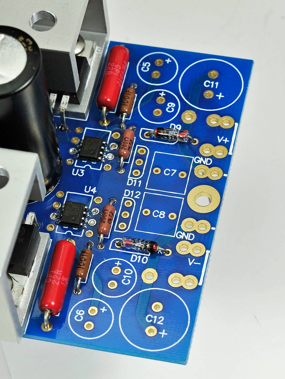

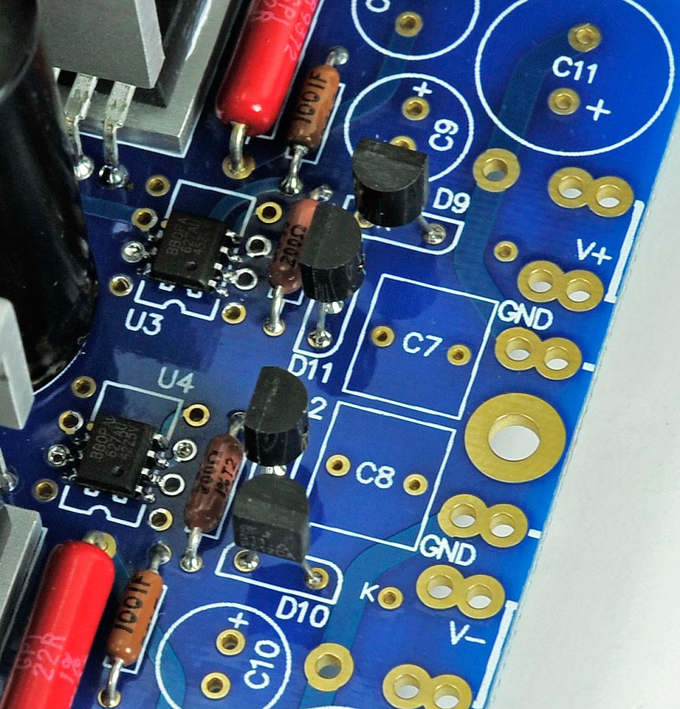

Please note position of 1k and 200R resistors. A trimpot can be installed in place of 200R for output voltage adjustments. Also, since J511 is hard to get, I added pads for Motorola 1N5314 which is a good substitute (K indicates Cathode)

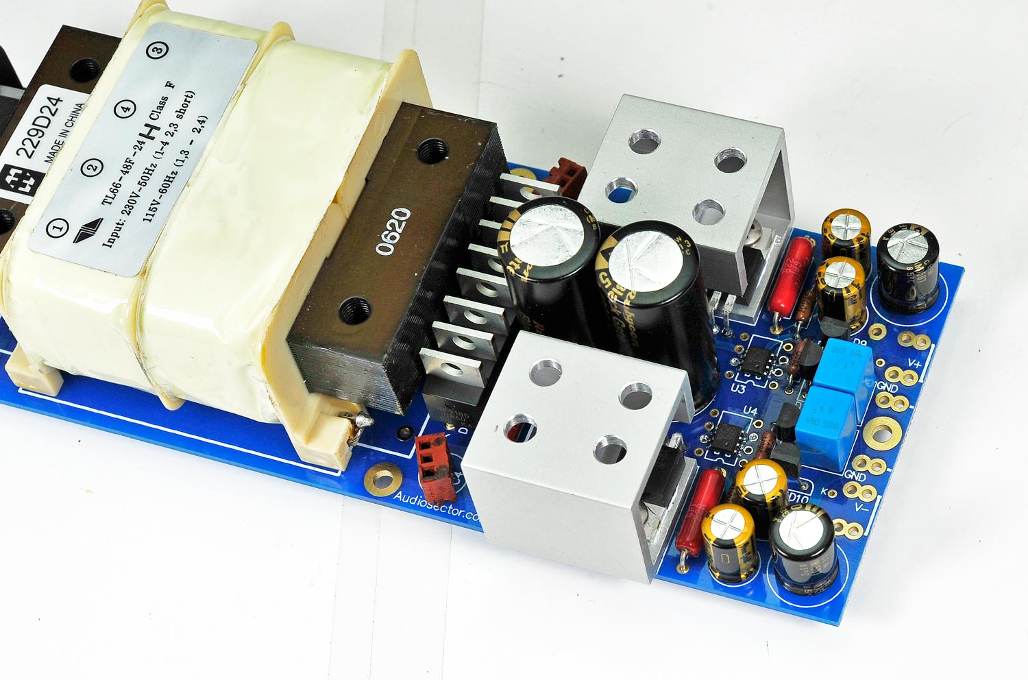

I use Nichicon FG 100/25 for all small bypass caps, I'm not sure yet, but they may be actually better than BG STD here. You may also notice that this time I didn't install the controversial cap across current source, instead, I have quick install sockets and be doing some comparisons 😉
When using PS board with phono section attached, C11/12 does not need to be installed as it installs in phono section instead.
For a free standing, separate PS only board, those caps are needed.
Using Variac, I checked what is the minimum voltage on main filter caps to still support 15V output: it looks like anything below 17.3V is already too low.
In case you have transformer with secondaries too low, simple adjust with R7/R8 for lower output voltage; OPA627 will work fine with 12V rails as well.
This concludes PS assembly, I will follow with phono board soon.

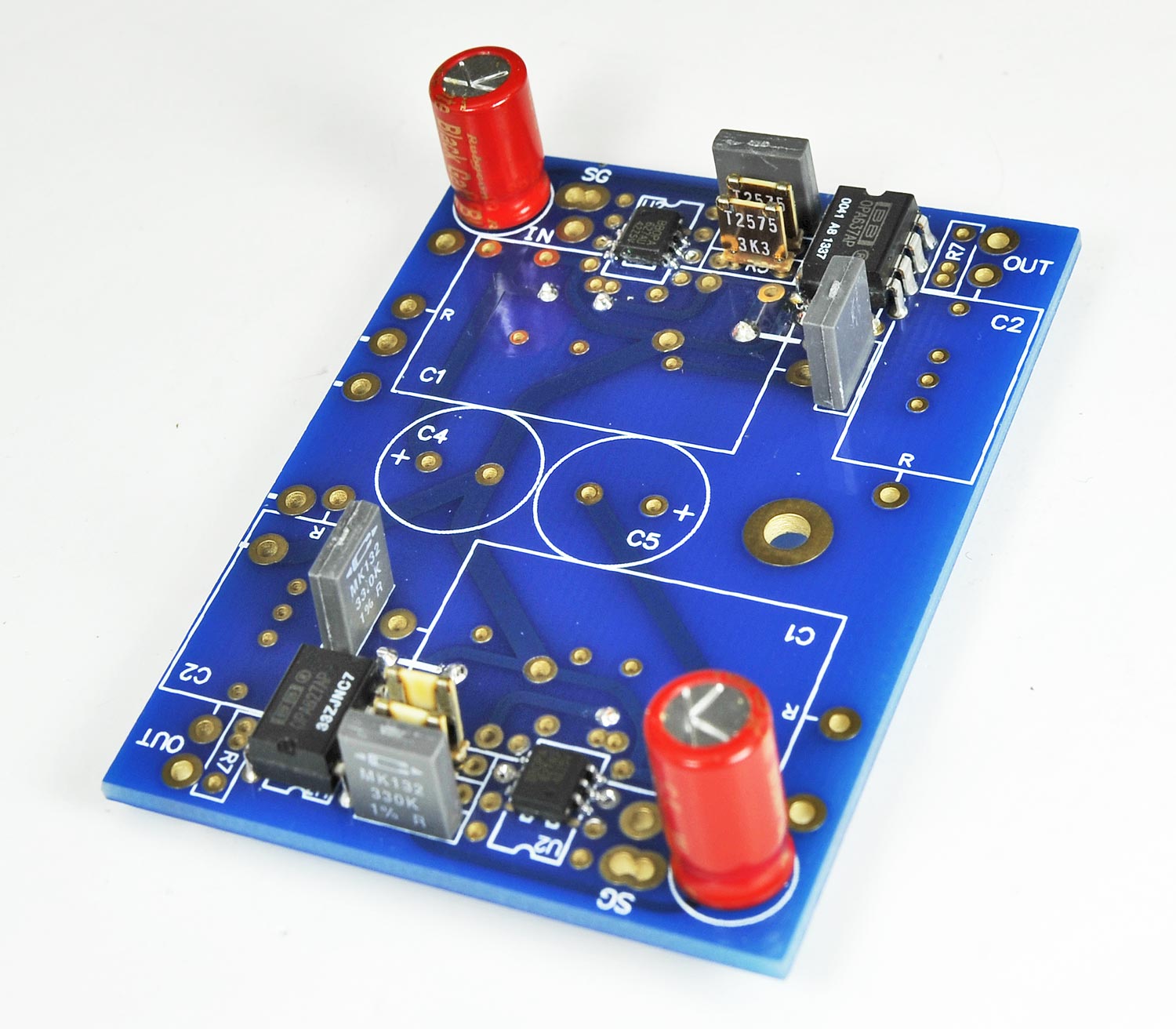

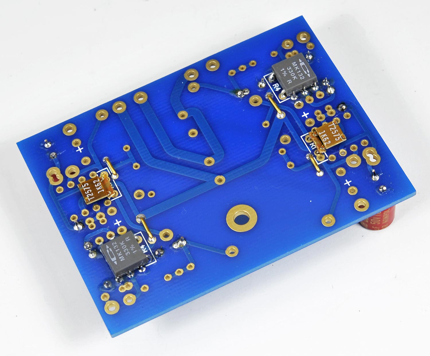

This is how I install resistors.
Price of Vishays is proportional to resistance value, and 330K resistor will cost more than $30pc, so I use nude Vishays only for 1k6 and 3k3.
Besides, I had very good results with Caddocks as well, especially in feedback and input shunt positions.
1k6 and 330K fit very nicely in a bottom layer, between the pins of op amps. I normally do not use 47R output resistor and take the signal directly from the second chip.
You will also see BG N for 10uF cap, short pin on +.

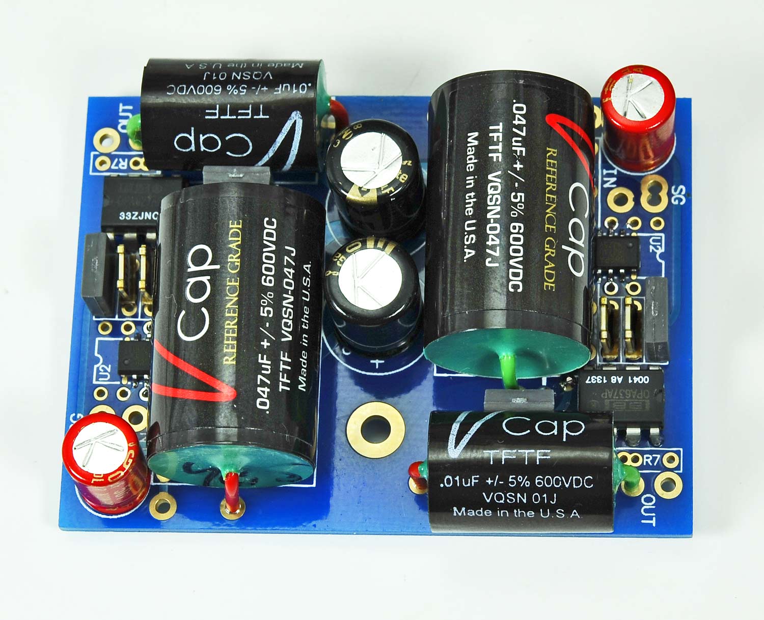

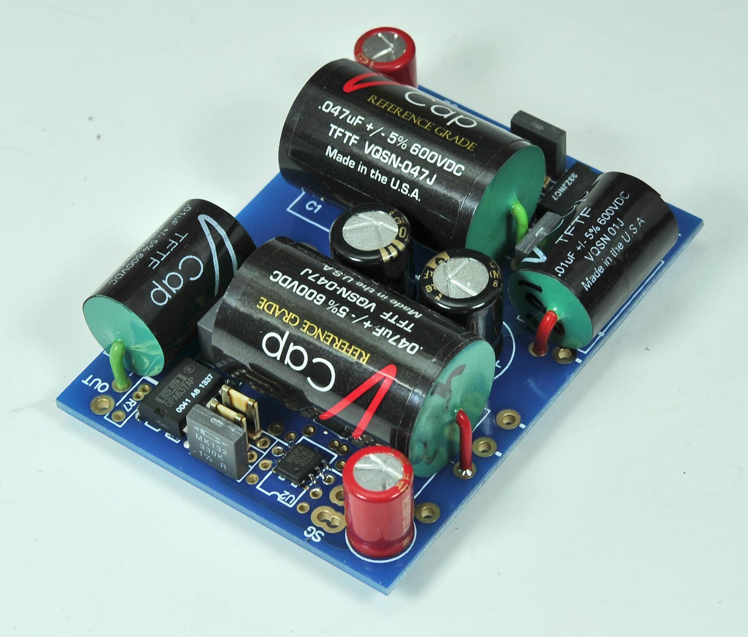

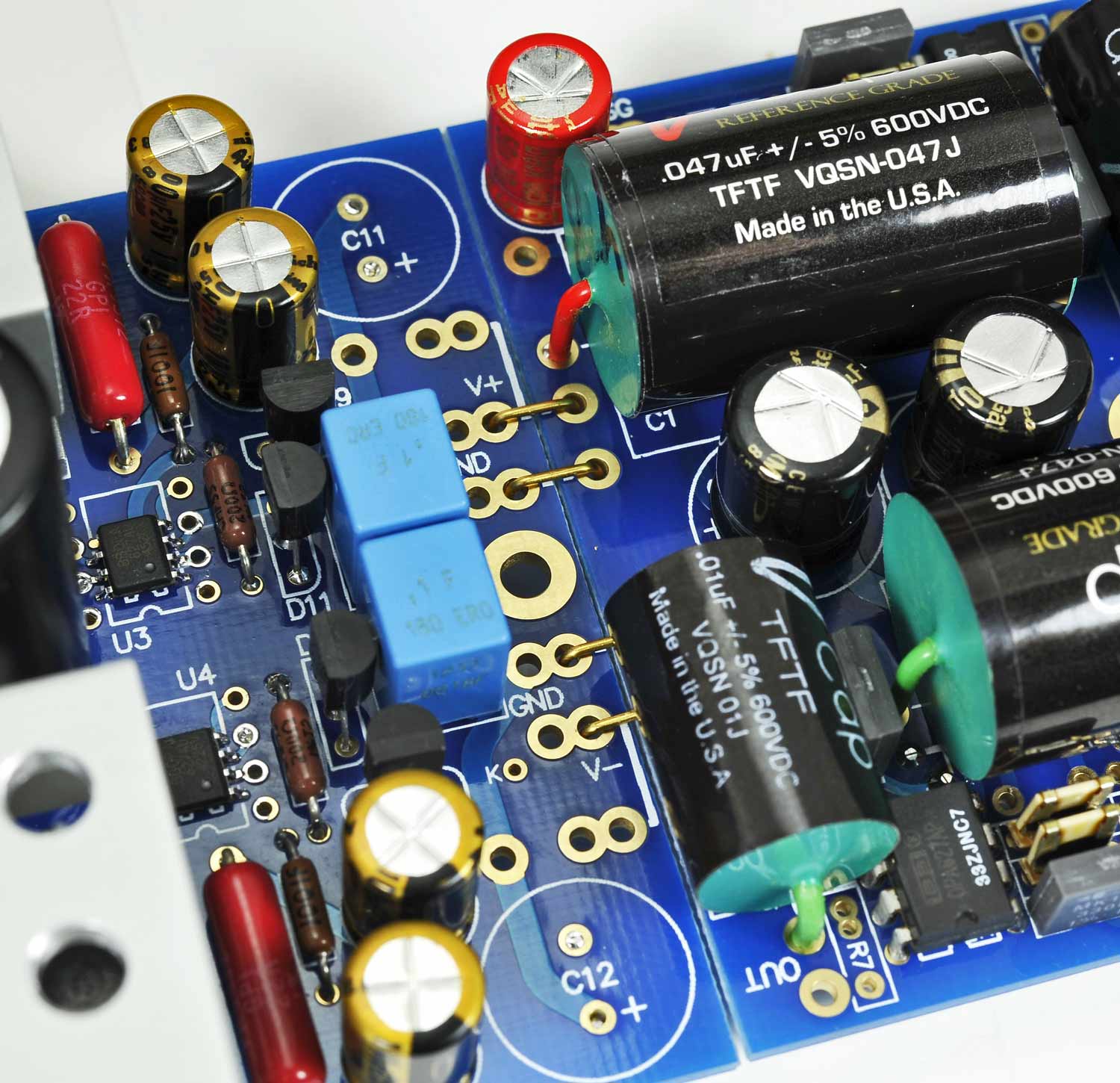

The caps go next, and here you see Teflon V-Caps. I didn't even consider using anything else in a phono stage of such caliber, but I can imagine that MIT RTX or Mundorfs will work almost as good. 😉
BTW, you will see "R" next to cap's pads, that indicates red lead, since those caps are directional according to manufacturer.
The filter caps (BG STD 100/16) have been moved from PS section in here. I use 2 sets of caps only if PS and phono board are separated by umbilical cord.
All that is left is to supply power to phono board and we do it with 4 jumpers that can be put either in top or bottom layer.
And that's all, the assembly is completed.
