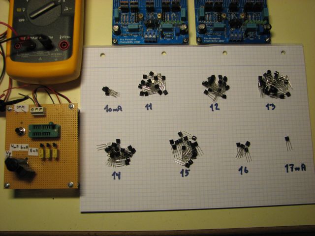

Distribution of 100 sk170V's, just rough Idss sorted. Anyway, they are much lower Idss than the sk369V's in general. Notice funny little testjig with all sorts of possibilities😎 The momentary switch, connects both gate and source to -v for Idss reading. Interesting no? 🙄
Some of them was meant for poor Pumpie on pic, but it might be better sticking the 369v's in there. The J310 are just under 40mA Idss 😱

Hmm, conclusion: They're all over the place, so better measure if Idss is of any importance.

EDIT: copy/paste from the datasheet:
Note: IDSS classification GR: 2.6~6.5 mA, BL: 6.0~12 mA, V: 10~20 mA
To be honest, I never checked the datasheet for the Idss figure, as I have measured all the fet's I have, but as I recall, mine are BL, and they were around 15mA.
Go figure.
Go figure.
Could be your stash of 2sk369bl's you recall there? Would be within spec, then.

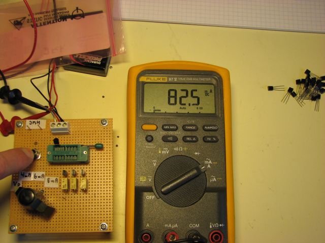

How about these insane little critters for high Idss? Check the pic.
