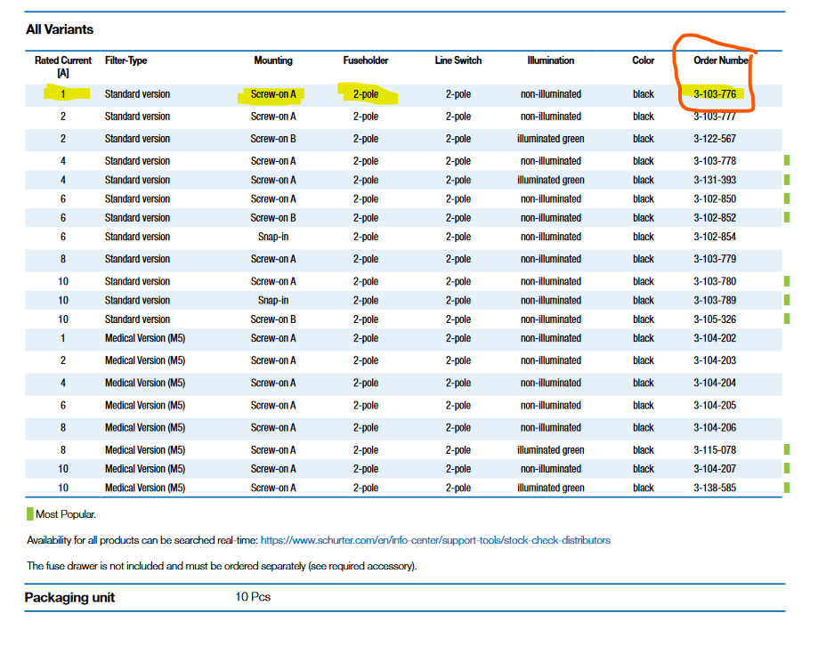

That has only a 5A rating compared to Shurter's being 10A. So they aren't quite the same.
I don't believe the cheap Amazon one listed above will fit the Pearl 3 Modushop chassis, which uses a type A style Schurter layout. The Pearl 3 Modushop chassis has a slot cut out specifically for the Schurter DD11, DD12, and DD14 PEM's. I agree that the Pearl 3 shouldn't be drawing more than 1 amp though (I'm often wrong, so please correct me if I am).
A good choice in my mind after poking around the datasheets is the 1 amp, dual filter, dual fused DD14, part number 3-103-776 (formerly called part number DD14-12121-12111-1100). I'm picking up two of them, although I'm going to use an 8A DD12 Schurter near term as I won't be making the Mouser order for a week or so.

@ItsAllInMyHead , I think you're comment is spot on. If @Toys4Boys was intending to use it for Pearl 3, 5A is probably plenty, but I don't think it will fit the slot and I know it won't line up with the bolt holes. I'm assuming the person who suggested using it was cutting out their own slot and not using the Modushop chassis. Since both Toys4Boys and myself are using the Modushop chassis, I was just clarifying that the right choice is a Schurter DD11/DD12/DD14, and that if you don't mind spending a little extra, the DD14 1Amp, dual fuse, is probably the ideal choice. I look forward to be corrected though. I'm a bigger dodo than most 🙂

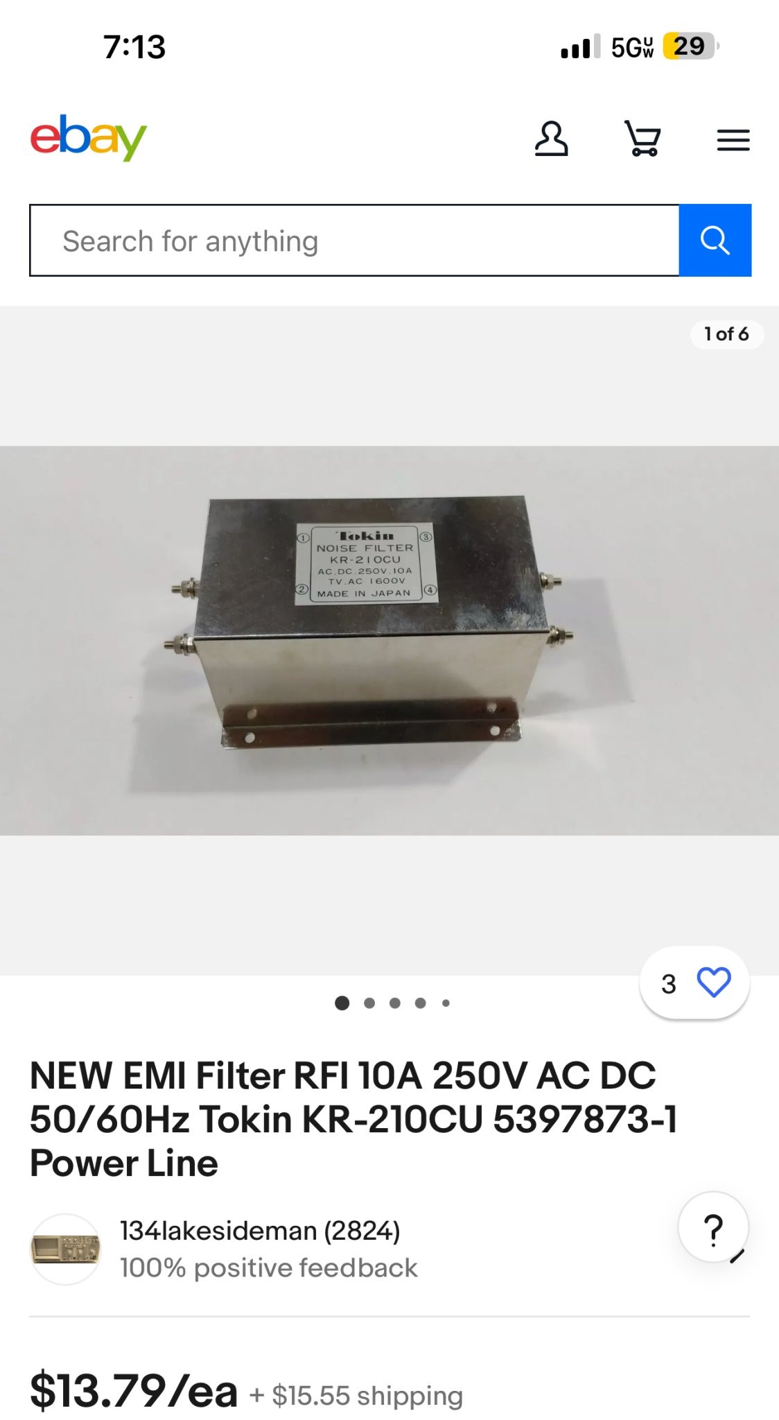

I know we got a couple of master electricians in the forum. I was searching for tokin products on fleabay. Saw these tokin filters below. What are they used for? What can they be used for?
