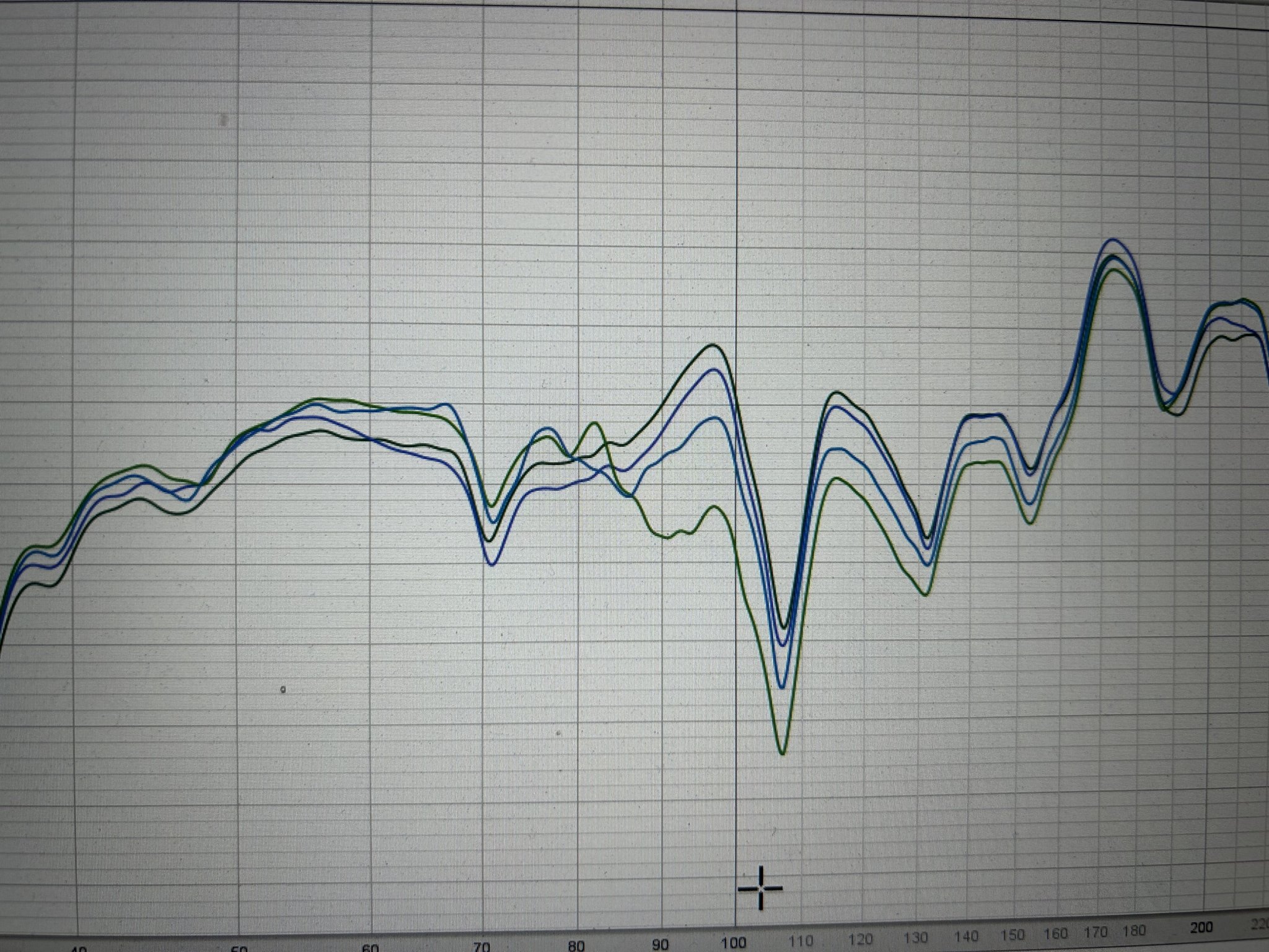

Hello ancient dodos. I hope that you are doing well those days, x-mas coming up and all that. Just popping in to say hello. Im doing experiments with concrete cast pipes filled with damping and REW, for room treatment. As for now I cant even see a difference when measuring in the pipe opening. New experiments tomorrow, stay tuned for more rock’n’roll
Thanks friend, likewise! I think I have found the trick for a bass eater. 25 cm diameter cardboard tube for concrete casting, 90 cm tall one end closed. From top: 1. No tube. 2. Tube loosely filled with isover up to the rim. 3. Two grabs of isover in the bottom of the tube. 4. Empty tube with a fleece blanket on top. Just need to cut it a little more and ditch the filling. Cheers!
