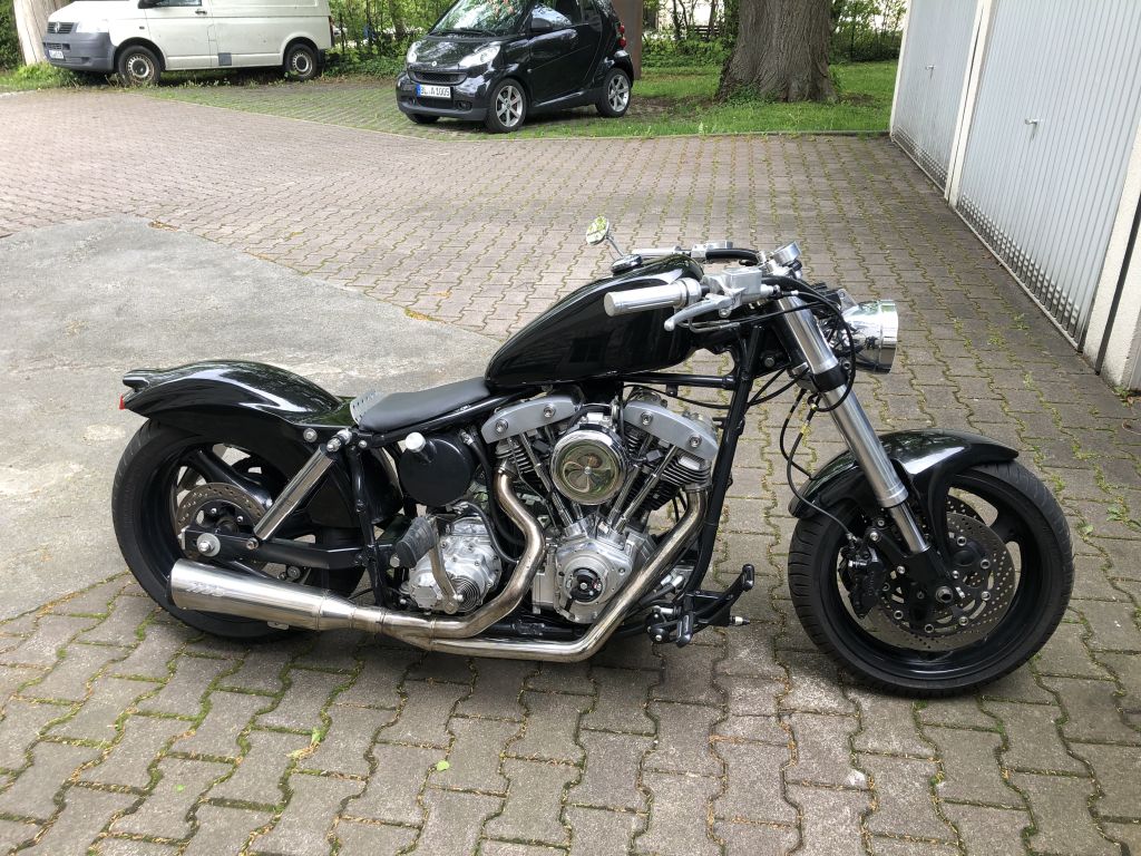

I am working on the bikes - it is springtime! Re-animated one of my 'toys' today. Her name is 'Eleanor'. 93cu.in. or 1530ccm at 10.1 compression ratio is no fun to kick. My right thigh is double as thick as the left one.... 🙄 But she is running again.
Cheers
Dirk

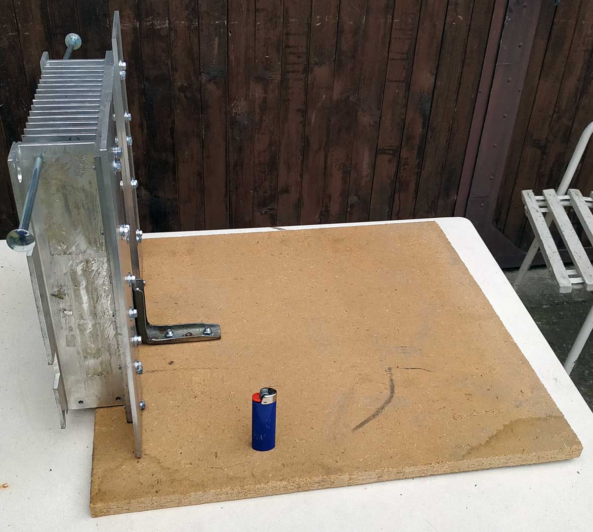

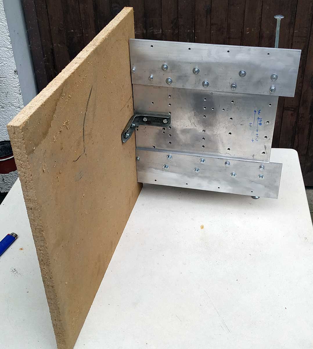

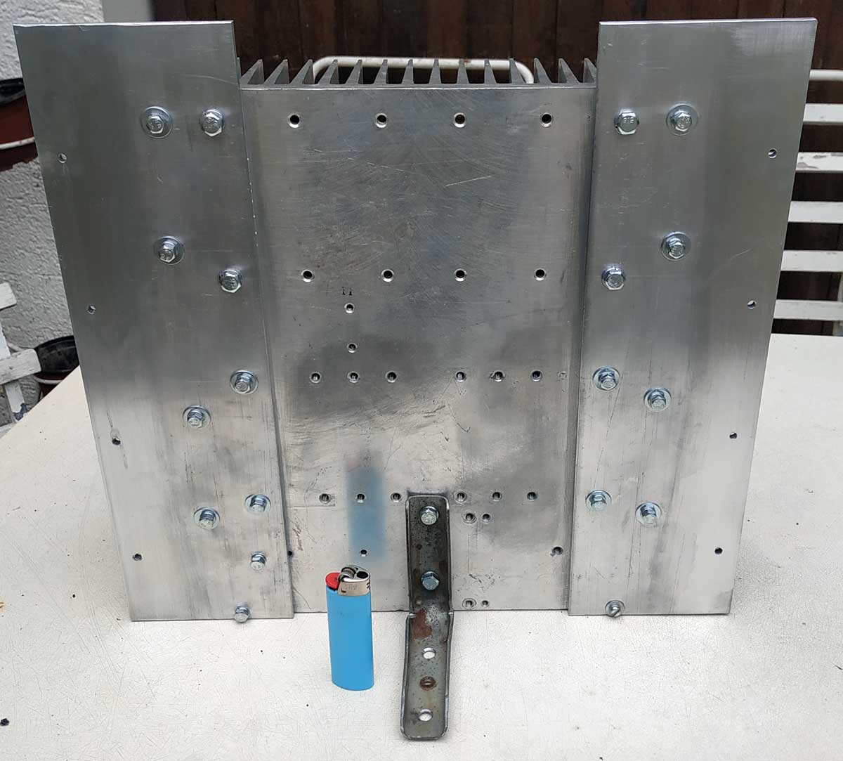

T-Bed 2 in progress
hope when I finish 5-6-7 amps I have more on the list, to finally have some time for my bikes🙂

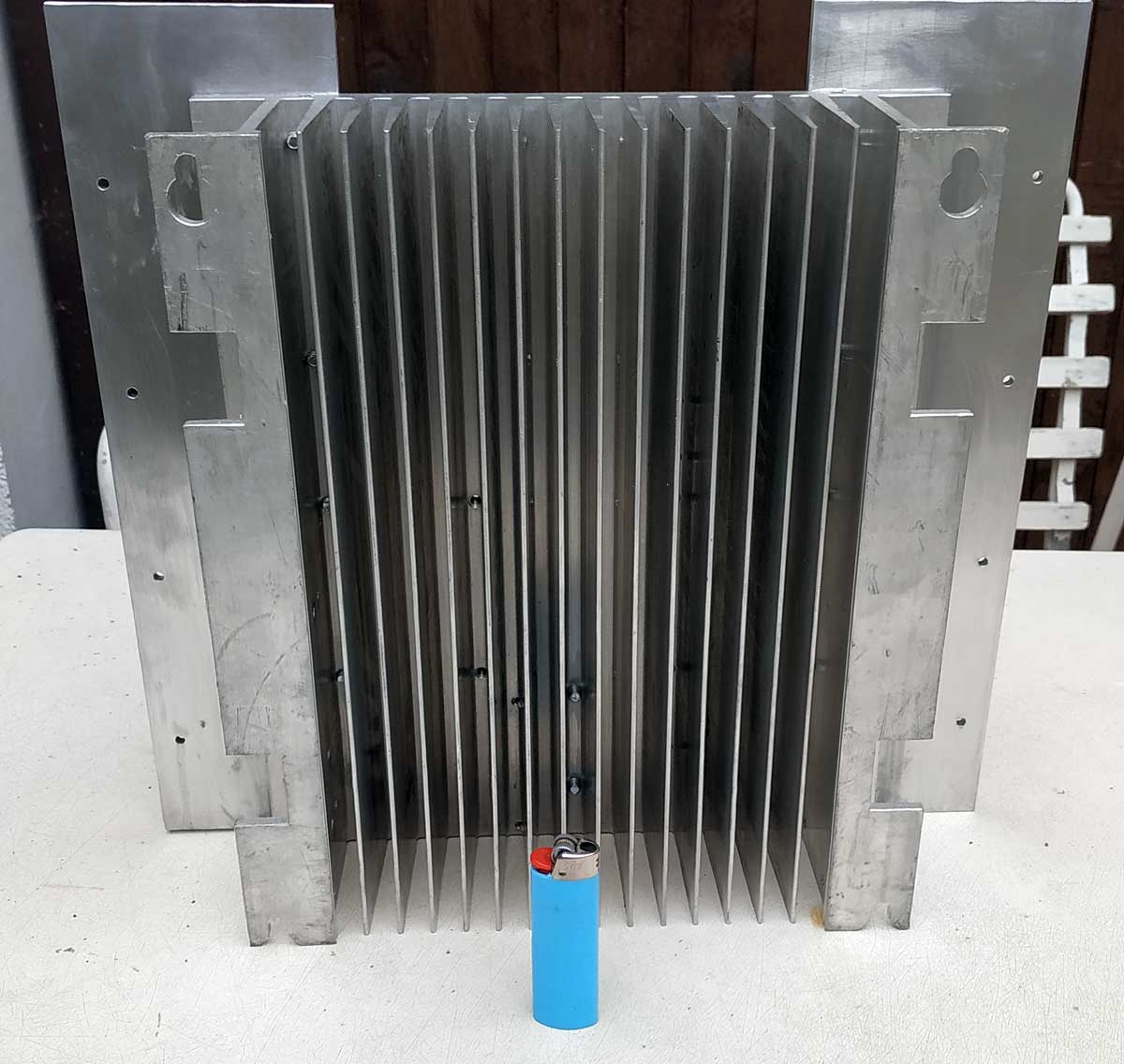

to ZenMod #27131
A big chunk of aluminum is always good for big Mosfets at high bias...
Also V-fets will like it. 😉

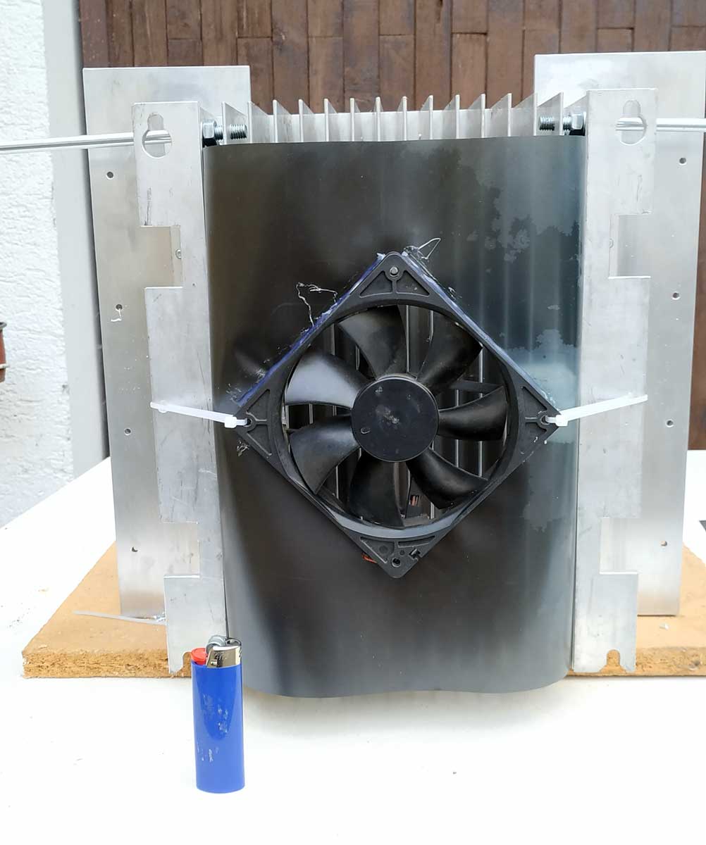

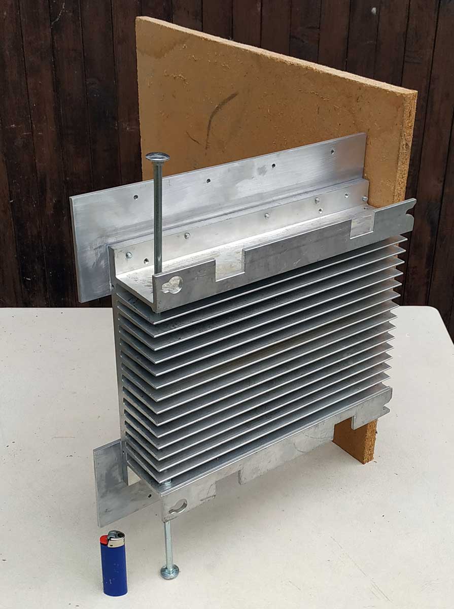

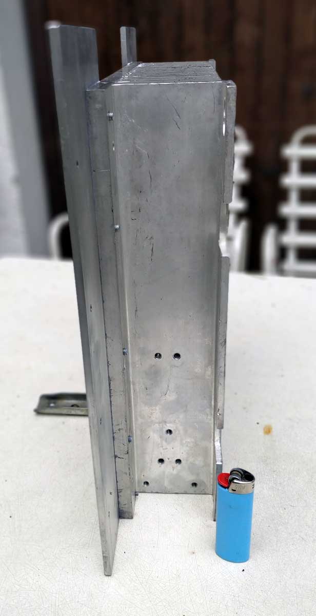

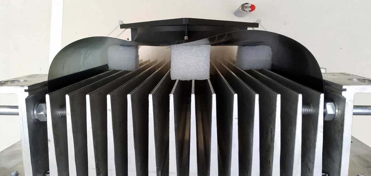

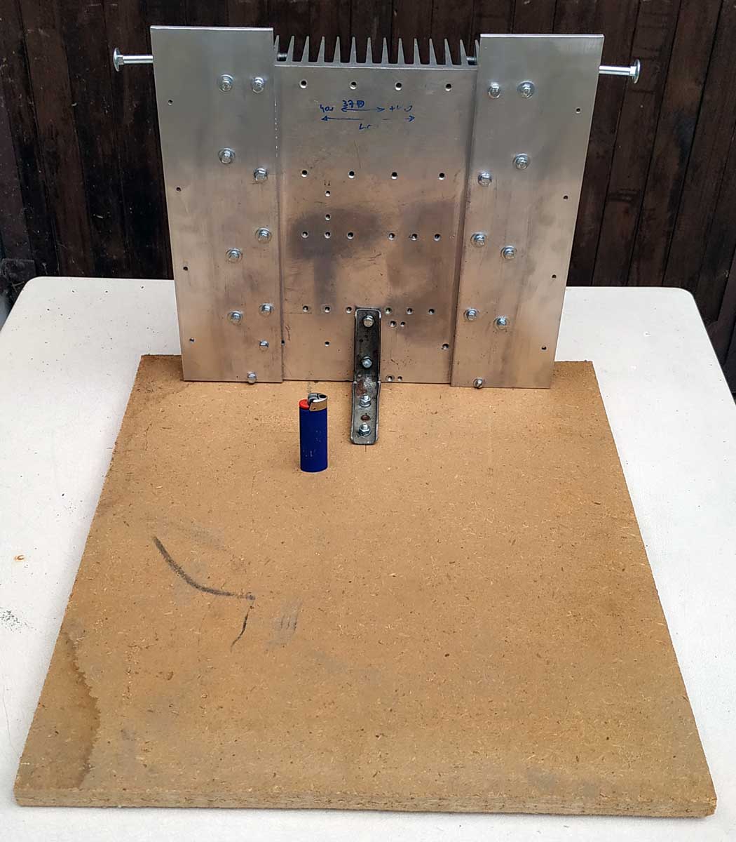

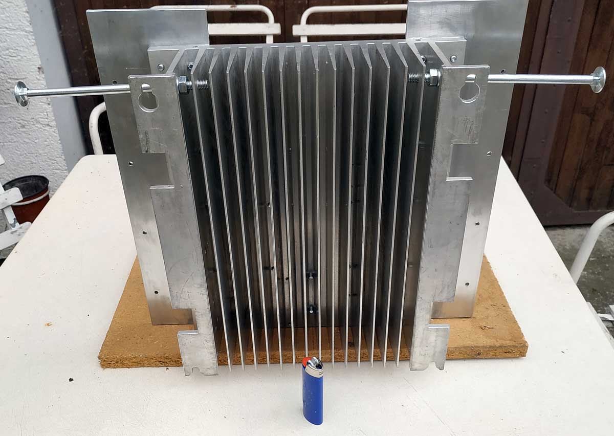

this is T-Bed, No.2
so, short of Test Bed, chassis for developing anything having 1ZM value depending of fan speed, I think it's good to at least 300W (both channels) without fan roaring
though, easy to add another 12cm fan, if needed, then it'll go to 400W of heatfor more I would use it for one channel only

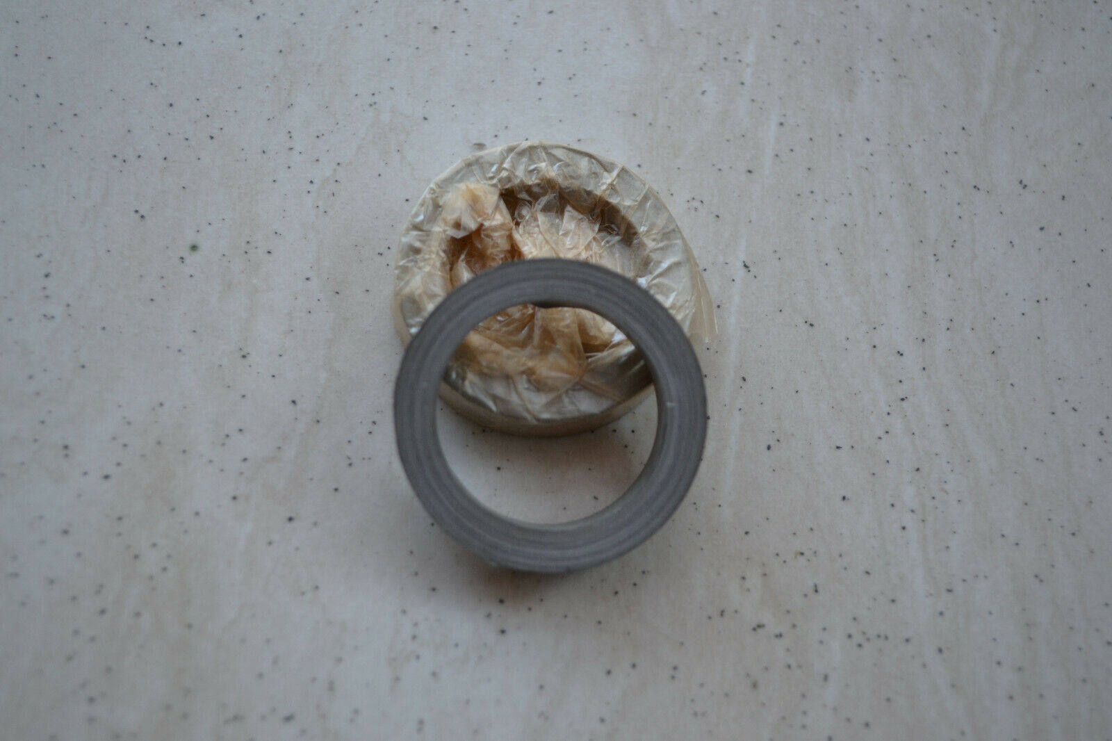

I'll add this 79% Nickel Permalloy Ring Core for Audio Transformer 25 mm2. Made in USSR. NOS | eBay to spice up your experiments. 😀T-Bed 2 in progress
