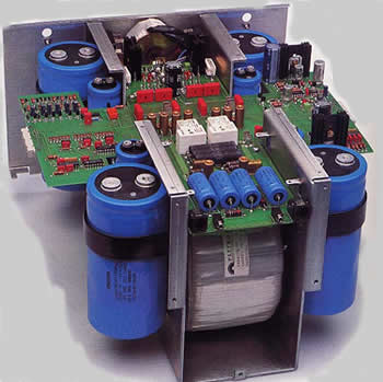

Even Mark Levinson uses Philips in his 300 series, picture attached.

Even Cello still seems to be Mark Levinson.
And Madrigal apparantly is Harmon Kardon.
Oh well, Roederstein became Vishay, Siemens turned into Matshushita, i havent got a clue what Philips did with BC.
To me it seems that Mark's moves set the blueprint for someone at the Threshold Co, in a much more elegant way.
I am sure i am not the only one who feels pleased with the recognisable appearance of the X/XA amplifiers, some things should never change.
