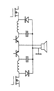

In making such a big amp, power supply efficiency seems always an important thing. That's why they invented Class G or H. With this classes, you can put any class audio CCT for audio reproduction (even class A), and efficiency is gained by having the supply rail modulated.
Is this idea will not agreed with your design phylosophy, Mr.Pass? You sure like run things HOT.
If this suggestion is OK, there is an interesting idea of modulating the supply not by Class G or H type, but rather modulating the supply by a classD principles. I dont know how to do it yet, but it is a good option for Pass Monster.

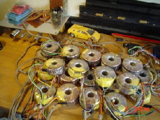

Zero Cool said:The transformers i have are 2KVA Medical Grade Isolation transformers. with quad primaries of 100, 110, 200, 240V and dual 120V secondaries.
My intent with these was to run them at half voltage. IE: run them from 120V on the 240V tap to produce dual 60V 500Va secondaries. this should get me/us +/- 85Vdc @ 1Kw correct??? If my calculations are correct. that should be good for about 400 watts including losses. But correct me if im wrong.
Hi Zero,
have you considered unwinding the secondaries to the desired voltage ?
That way you can keep the 2000va rating and it saves on weight.
Menno vanderVeen developes transformers for/with Amplimo and Plitron, he has written some articles on transformers.

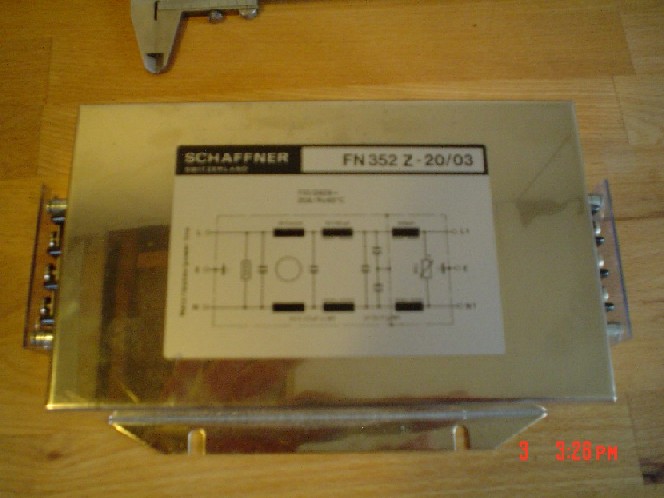

a picture of 1 of the 4 separation transformers i use to clean wall juice, as Jaac is so hungry for heavy duty gear.

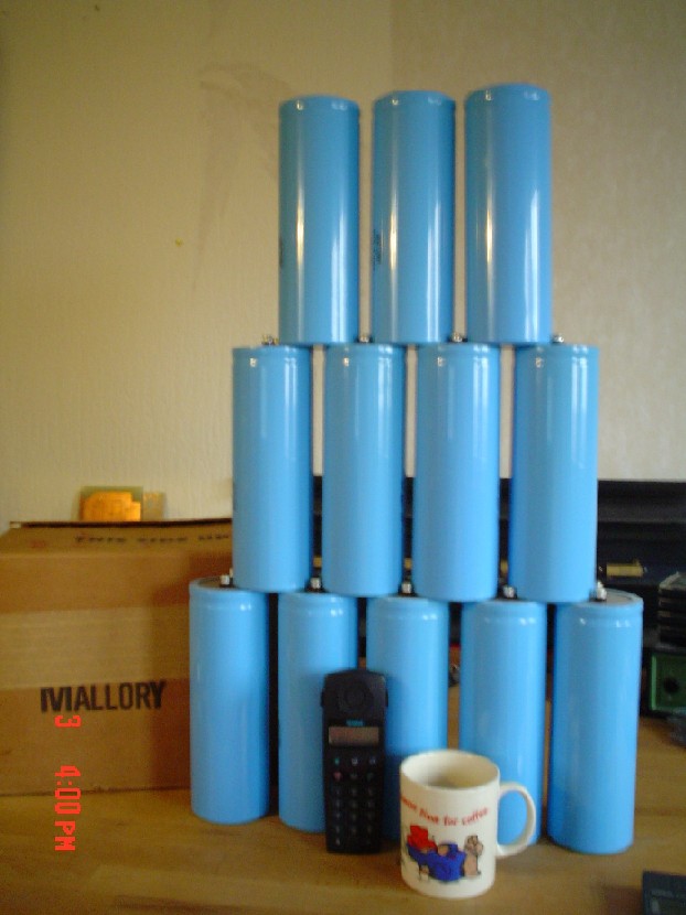

A farad or Two
Here is a picture of a box of Mallory capacitors
At 78000uF this is about a Farad (0.936 F)
At 50 Volts they contain 1170 Joules of energy.
In the previous example 11 times this amount is needed to obtain 14112 Joules.
