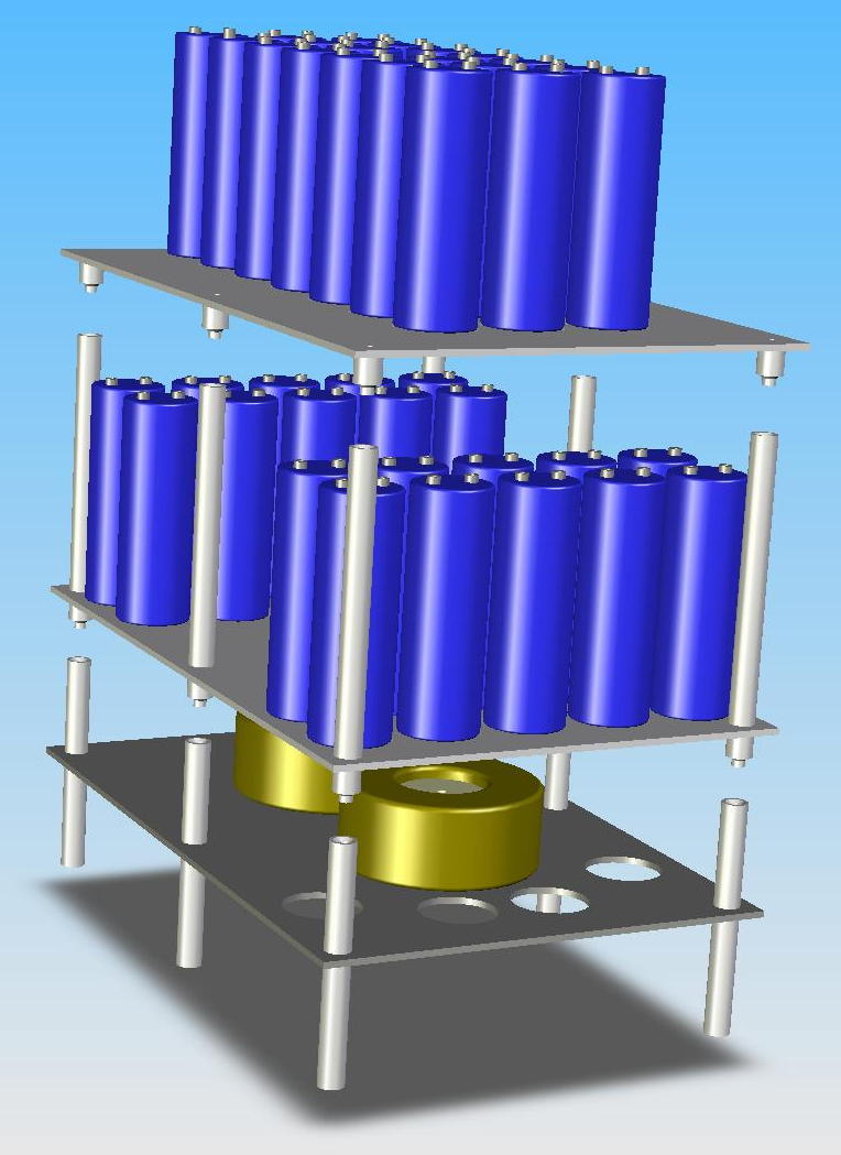

Well, the labs of Smarmy cool have been hard at work! Casey has been experimenting with a 3D modeling program called solidworks. www.solidworks.com
He has started building the amps within the program and we can see exatly how each piece will fit. this is affording us the opportunity now to find out what fittment problems would will run into. it has also allowed us to make some changes we handnt thought of. sometimes a visual is the best muse!!
Attached is a Picture taken from within the program to show some of the components and how there going together.
In the picture you can see the insides of the 3 chassis and how they will stack up. the lower chassis will house the 2x 2KVA transformers and ac related components. the middle chassis will house 20 of the 40 capacitors used and the 2 very large inductors. and the top chassis will house another 20 capacitors as well as the actuall amp stage not yet shown. there will be copper buss bars running right up through the middle of the chassis. and we have even come up with a few proprietry special tricks we are not yet divuldging!
Stay tuned, more to come.

Zero cool's project.
Hi, does that transformer say "PPG Medical Systems" on it somewhere? I have a stack of those in my warehouse. Some are rated at 2kva and some are rated at 3.5kva. The big ones weigh 45 pounds. On the smalller ones, I used a sharp probe to pierce the insulation on the windings, probed and found the exact middle of the secondary. I then tapped into it and made my center tap. This allowed me to get full power out of the thing.
